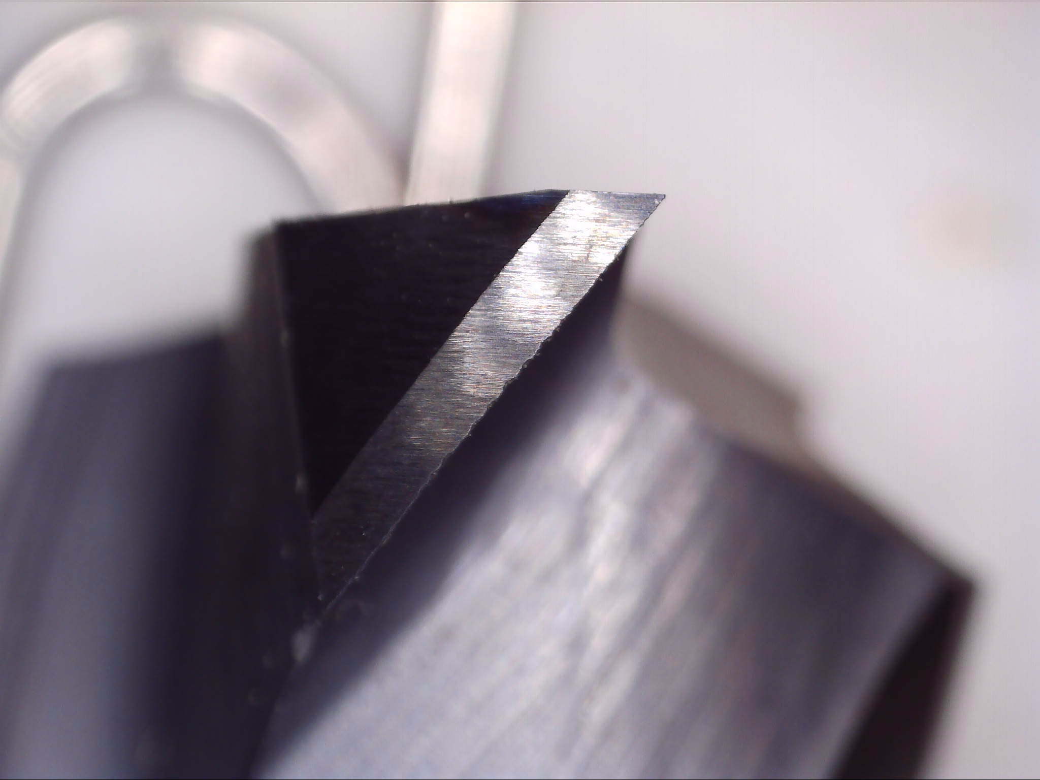

I bought a USB microscope and have been using it to check my router bits. I find it very useful for this purpose. We do a lot of odd jobs and change bit out quite often so have bits in the shelf that might just be dirty or are very dull. The scope takes the guess work out of the process for us. This is the one we have. https://www.amazon.ca/gp/product/B00CMJ1I08/ref=oh_aui_detailpage_o00_s00?ie=UTF8&
amp;psc=1
It allows you to take photos and measure.

I have never looked at a bit in that way so it is hard to say. I see a chip, that’s a problem I also see a ragged looking edge. If I was to approach it this way I would look at new, look at dull and compare the two. Then I would run test cuts and look at the edge finish, listen to the bit and make a judgement. We run a standard set of cutters and finish, sound and sheet count cause us to swap them out.

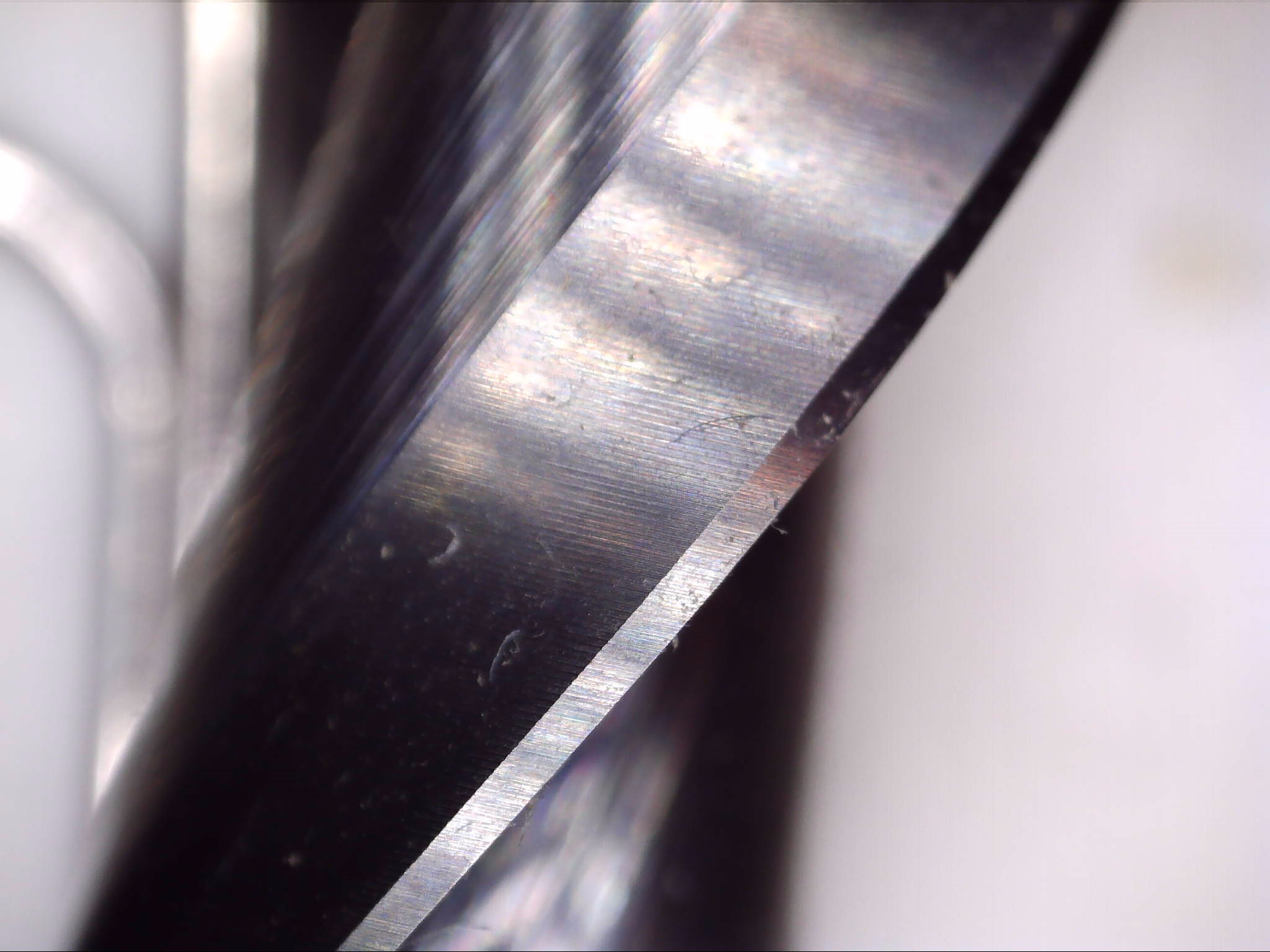

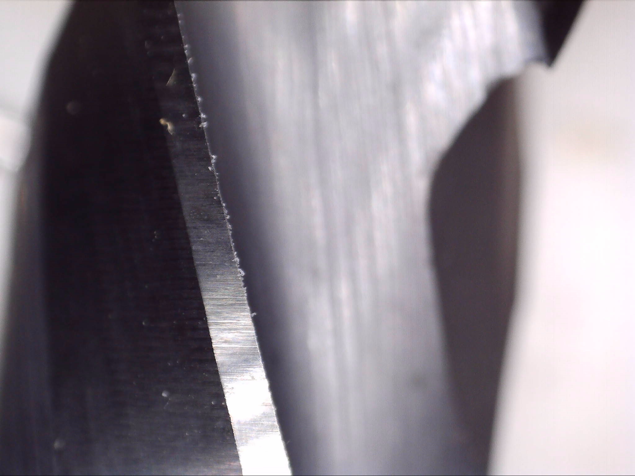

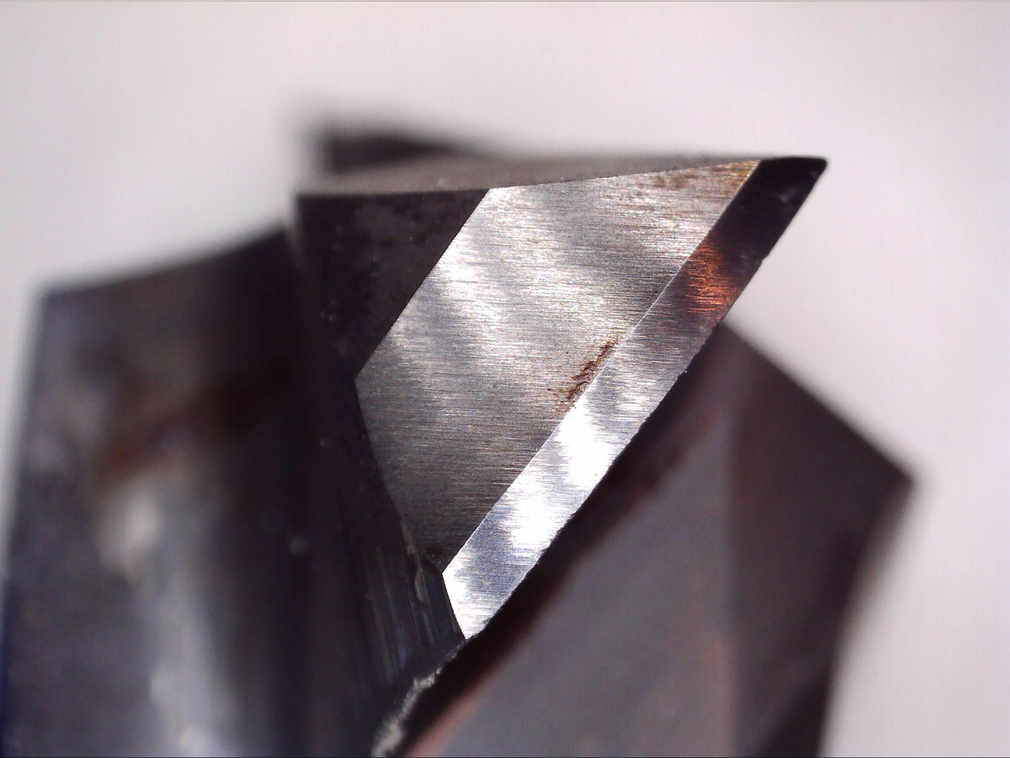

I am in the same boat in terms of not knowing what they should look like. We have always listened to them cut and used a small magnifier to look at them. I have attached 3 more images the first is a new never used cutter the last 2 are of a compression cutter fresh back after sharpening. It is easy to see why the sharpened cutter does not last as long!

I can do the same thing by running the cutting edge over my fingernail.

Rich I just tried that on the up-cut portion of the sharpened bit in the last pictures and could not feel any of the toothy edge shown in the photo.

the sharpened bit does not look like it was sharpened proper they have to be faced, o.d. and ended for a proper sharpening

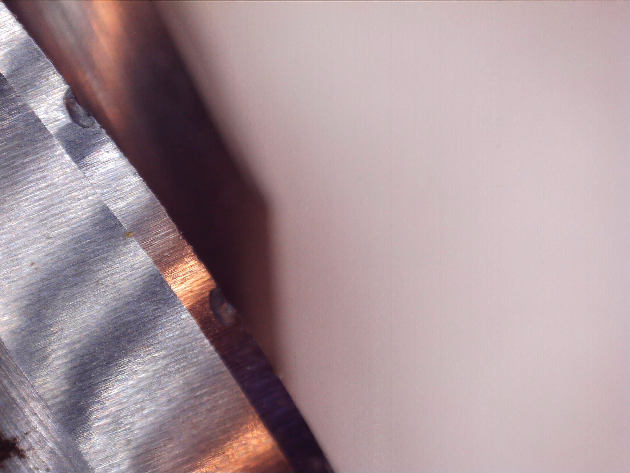

I would say the the bit with the 2 chips is from where the glue/laminate was. The magnification is a good tool to use. We go up to 1500 on our bits.

We use vortex bits and send them to vortex to be sharpened. Sharpened bits last as long as new.

Chuck, I don't know what happened to that bit, I have seen staples in the edges of some of our melamine so it could have been that too. I am a little surprised to see so much chipping on the bits I have looked at. I am sure at 1500 all of the edges look toothy.
