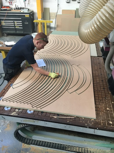

I have a project that requires me to cut about 1500 mdf panel thickness 1.8 cm on my nesting cnc any recommendations regarding the type of bit to use should i use a pcd tool or other thank you

I wouldnt bother with PCD for MDF. I'd just run solid carbide or insert depending on what your doing and log your tool life and then just swap out or change inserts with a cushion before. Depending on what you need for cut quality carbide will cut MDF forever. Hard to say without know what type of cutting. Profile cutting shapes, pockets, etc..

I have to cut to size squares and curve shapes with some grooves in them like the picture below
