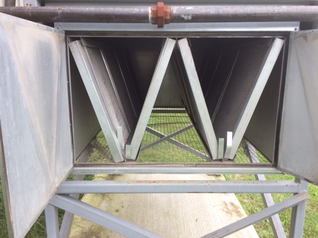

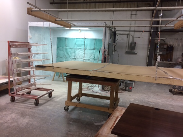

We have a dust problem in our finished surfaces. As soon as the finish is applied and even during the spraying process, dust particles settle on the surface. It is approximately 1 particle per square foot. So far, we have blown off the entire spray room and let the dust settle. Then the spray booth where scraped and coated with booth liner. New booth filters where installed. The floor was well cleaned. However there is no improvement. We have an air makeup with wire mesh filters. There is always positive air pressure in the finishing room. All the sanding and rag tagging is done outside the finishing room. All carts and materials are blown off before entering the finishing room. The workers believe that there may be too much air movement caused by the air make up unit blowing into the room. Any suggestions? Thank you for your input.

We replaced our three air make up units filters feeding our spray room with Merv 10 pleated filters outside ... and also put a layer of spray booth media wired to the bottom to catch big stuff...and had our ducting into the room redesigned to hold Merv 8 filters... it's a pain to replace the filters outside ... requires changing every 6-8 weeks but the feed air is clean! we also have drives on the spray booth motors to turn the fans down to make sure we have plenty of positive air in the room.... any dust we have is just from being unclean elsewhere... you guys wearing tyvek? amazing how much lint comes off your clothes... we also buy plastic sleeving on a roll from Uline and replace it very often carrying our paint hoses.... you can really get a lot of trash just from handling your hose while spraying

If that duct line with the 3 grills up by the ceiling in your second photo is the air make up unit then take a look at the inside. Even if there is a filter on the intake end there is probably still dust on the floor of the duct. I'd suggest pulling a grill off and swiping the duct floor with a rag to see what you get.
Could be a waste of time but shouldn't take long to find out.

I think that Robert has keyed into something important, the size of the finishing room. You have at least two open face spray booths. There's overspray and not 100% of it is going to land in the booth filters.
Air currents and vortices, you are still likely to have airborne dust from your atomized spray and also from the lint on everyone's clothes.
I think, also, that your workers who say maybe there is too much movement of air are also on to something.
You might explore the possibility that a positive pressure room has it's own problems and instead try some strategies to have a more dust free environment by having access points that are more air tight with stricter controls over who enters and leaves and how they ingress/egress your spray room.

Thank you all for your feedback so far. We had our finishing material supplier come in and he pointed out air movement against his neck and the fact that the walls where likely not cleaned for a long time. Therefore, we will shut down the finishing room for a day and clean down from top to bottom. We are going to brush off all the walls, cabinets and all surfaces. We are in process of getting filters installed in the air make up and get Tyvec suits. I hope this will get results. Thank you for all the feedback so far. I will keep you posted on the progress.

noticed in 2nd picture the insulation on ceiling.
dont know if is a problem or not.

The first thing that I noticed is all of the horizontal piping and scaffolding hanging from the ceiling directly in your airstream. Its got chain, 2x framing lumber, pipe.
All of these surfaces will collect tons of dust. When you turn on your system it will aerosolize all of those super fine particles.
It looks like it might swing? Everytime you place something on it or bump it, you will knock more dust into the air.
Stand up there and blow on it. If you can move it with your breath, then the system will definitely move it.
I would rethink that whole setup. Only vertical wire no chain. Try to get all of the piping above the airstream.

Hi everybody. First of all thanks a lot for all the responses. On our Graco airless/airassist system, we installed a new fluid line that was not changed for 1-1/8 years. We also changed filters to 100 mesh at the pump and 200 mesh on the gun. On the old fluid line, we constantly changed from white paint to conversion varnish to precat to sealer to primer. This system is now dedicated to clear finish material only. These changes alone removed most of the particles.
We received the Tyvec suits and will shut down the finishing room for at least a day to clean. What is the best method for cleaning the walls and ceiling. I was told that vacuuming is not an option due to the explosion hazard so for the moment we think of brushing them off. I just wonder if we not just moving the dust and it will settle elsewhere?
