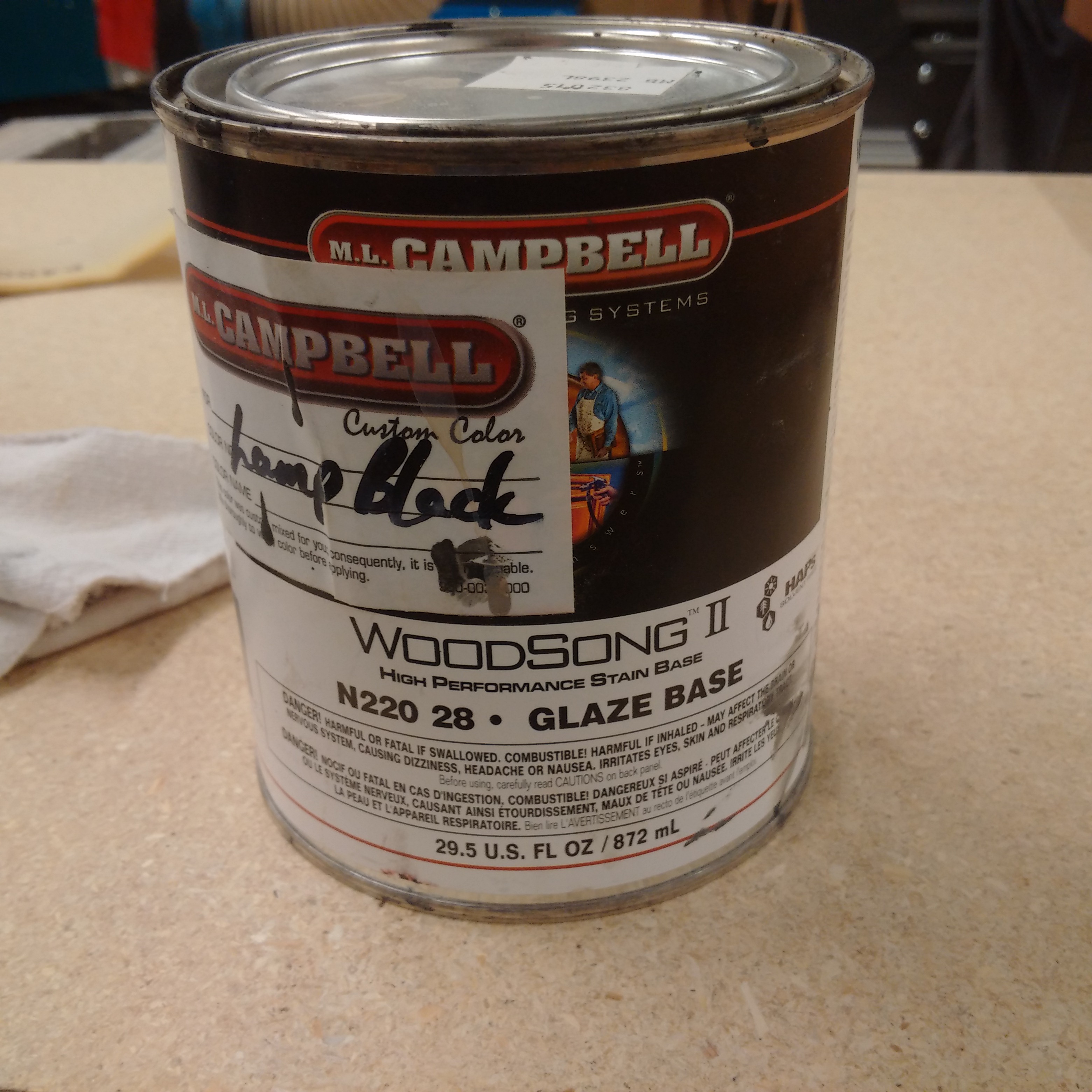

Has anyone used this ml Campbell N220 28 glaze on doors? It is lamp black. I am just looking for tips on whether it needs the sandwich coat and also what to avoid. Thanks in advance.

I use this product often. Always sandwich between vinyl. Works well, long open time, very forgiving. Mostly use over pigmented Resistant. Takes awhile to dry enough to coat though.

Dave-You can cut the glaze with mineral spirits and avoid the vinyl. I can't remember for sure the ratio (I think 3 to 1?), but I did it for years after being told that by their sales rep and I know it works.

Tony is correct about the addition of mineral spirits. Do it all the time.
