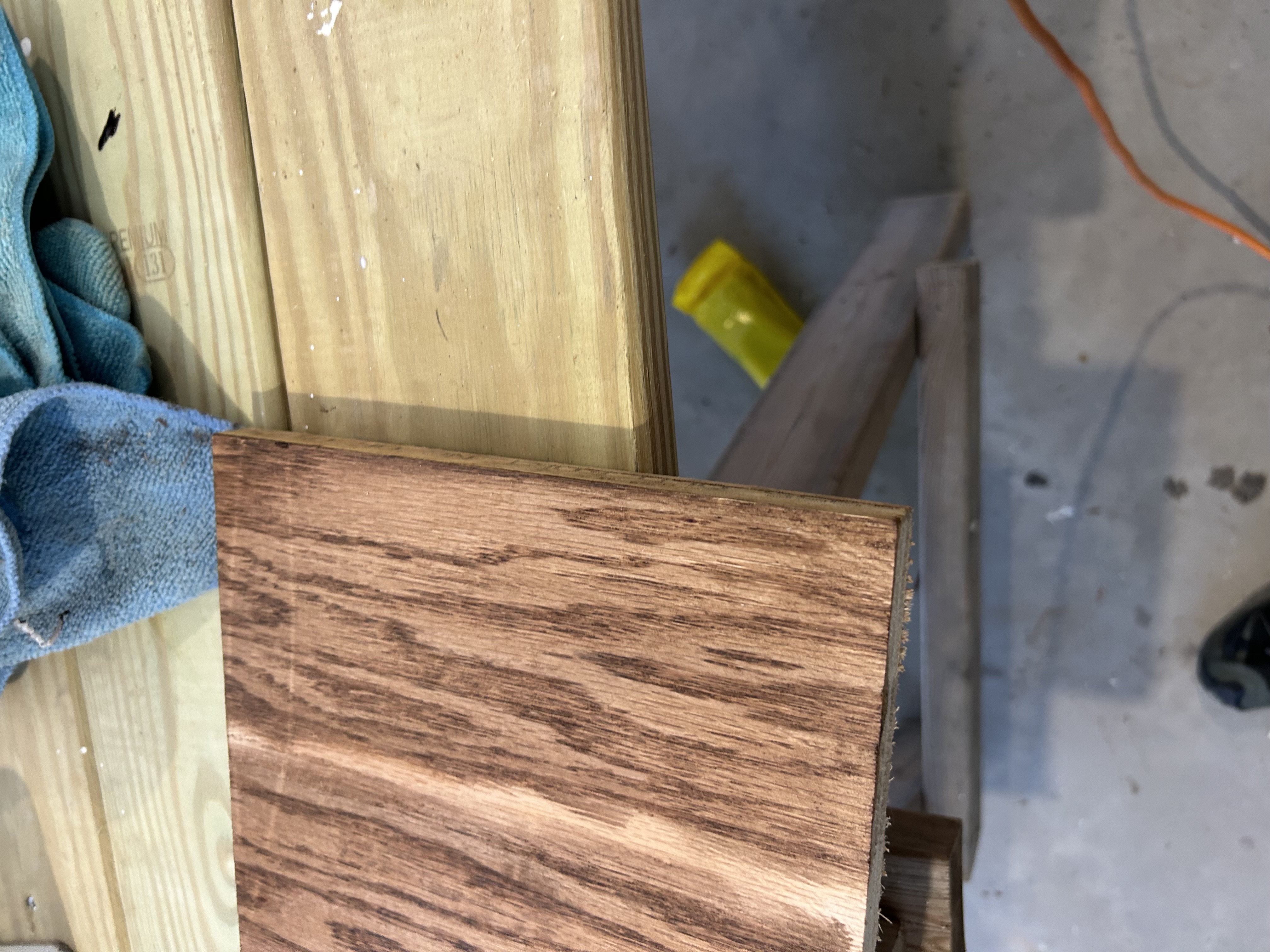

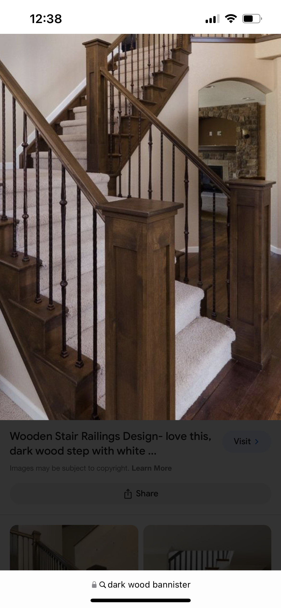

Hi all. I知 a finishing noobie as it pertains to staining white oak. I致e got some railings and banisters on a new house build in white oak that I知 trying to stain an EVEN color rich brown. Instead all I知 getting is is light colored wood with really dark grains. Using min wax gel stain. Any advice would be greatly appreciated. The picture below is a test piece result. The second is what I知 more so going for. Thanks so much in advance!

Here's a couple tips. Buy a real saw blade and not the cheap crap you are using now. No saw should produce that kind of splintering. Stop buying your stain and plywood at a box store. That white streak looks like glue that has leaked out at the seam of the veneer. Use a card scraper and then sand the plywood before staining.

Probably not going to be able to get what you want with a DIY stain like MinWax.
The staircase you show does not look like it was Oak. So you are already doing apples to oranges. Any dyes in the stain will get caught up in the Oak grain and will highlight it. You need a stain that is mostly pigments or have to go to a product that is more or less colored finish. This has it's own application issues and getting an even color can be difficult.

You may be able to get something close to that color but never the look. The white oak has grain and the other is a closed grain like maple or birch. The only way to get it would be if you are spraying the finish. You just might get some of the color with shading. Here is another suggestion. Take a wet cloth with water and go over the wood a few times. Let it dry probably overnight and then slightly scuff the big fibers off and then stain it.

Rich, that picture is just a test piece of junk white oak from a closet job. The actual project are white oak bannisters on a new construction home. Thanks for the advice though :)
