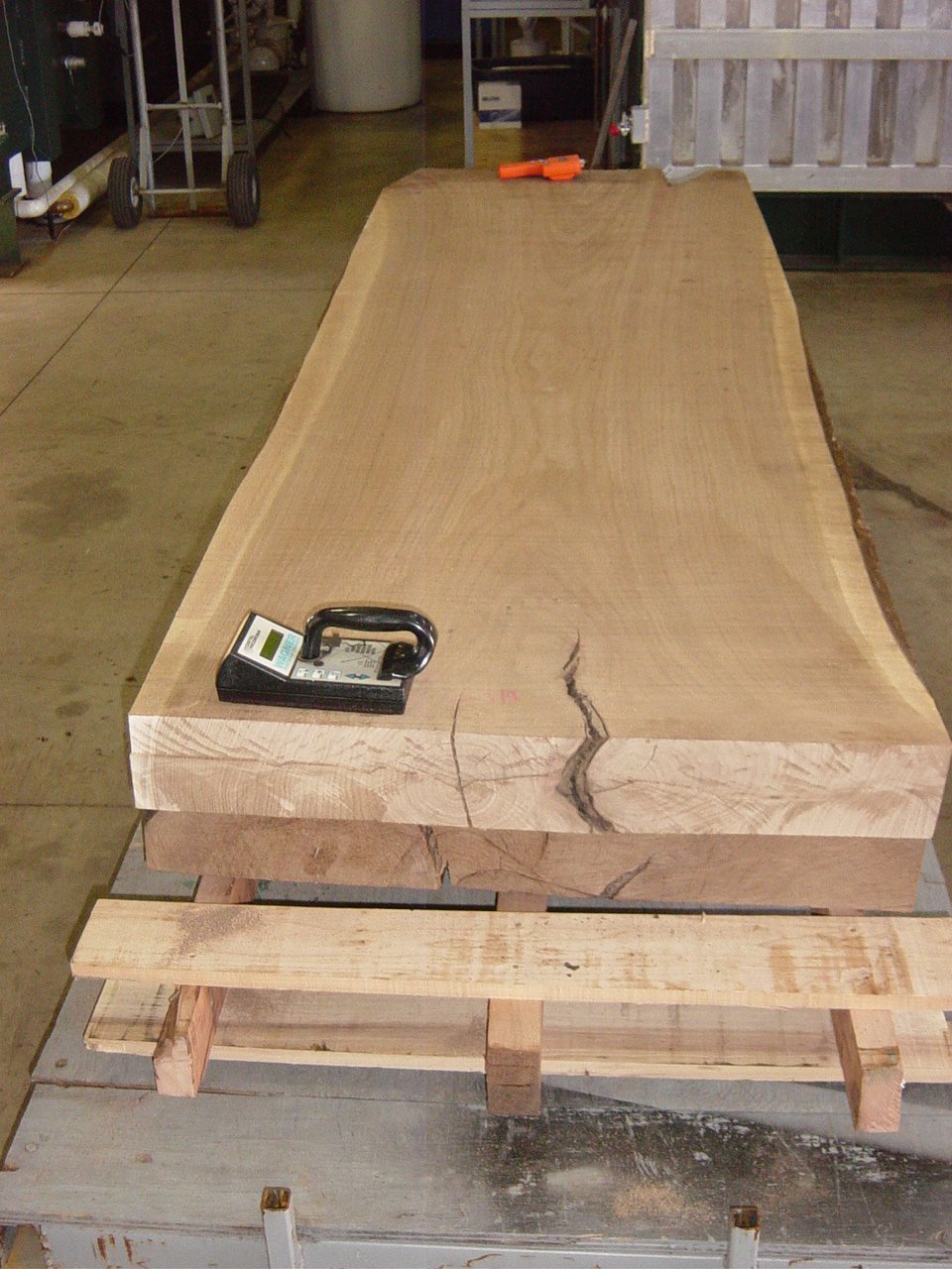

If you dry enough slabs to justify the investment, a vacuum kiln makes a lot of sense. Instead of drying off the surface with the humidity gradient, a vacuum kiln can dry from beneath the surface with a pressure differential. Results are remarkable.

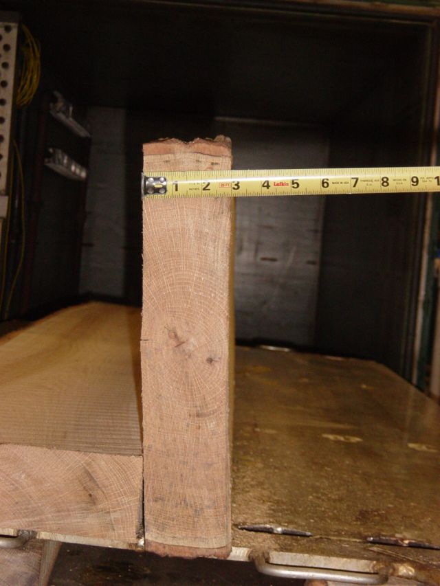

Thank you for the replys. This is a 48" red elm with a lot of oddball grain. I intended to stay further away from the pith wood but cut down to within about 4" of the center. I'm going to try to cut about a 4" slab so the back side will be just about on the pith. I think I can stabolize the pith side with some butterfly joints. Any thoughts on that?

I should have mentioned that the 3" Red Oak takes 12 days and the 4" walnut takes 33 days from fresh off the saw.

A little late to reply, sorry. But a 4" thick x 48" slab is going to be HEAVY! Even at 4' long, it's going to be a real job to get in the house. If you put one face on the pith, there will be no way to keep it from cracking. It's highly likely that it will cup as well.

Den had to call my attention to the location of the pith in that slab. My comments are directed more to air drying problems. Wouldn't a vacuum kiln be nice for everyone? Cheez, that's some nice drying!
