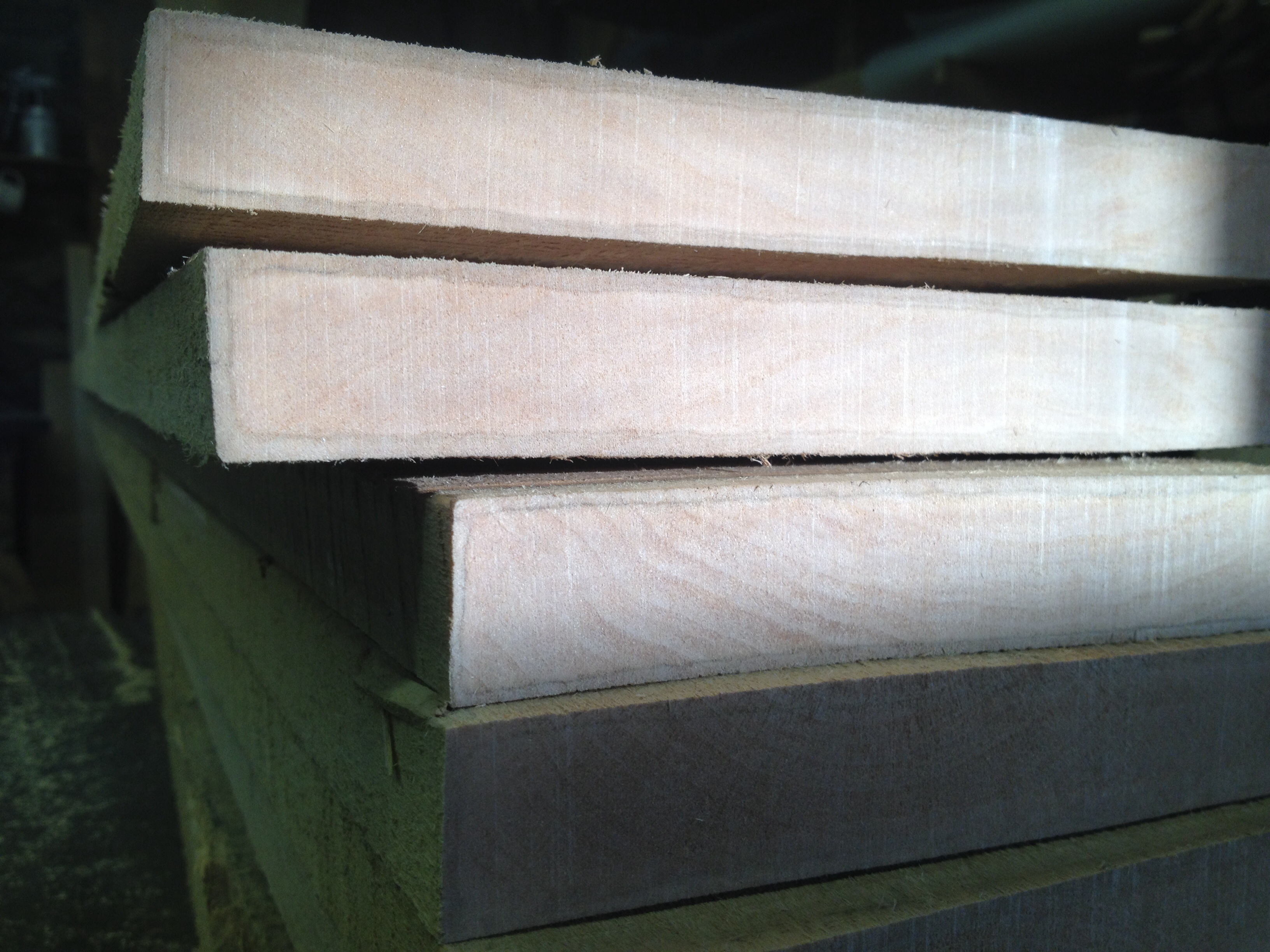

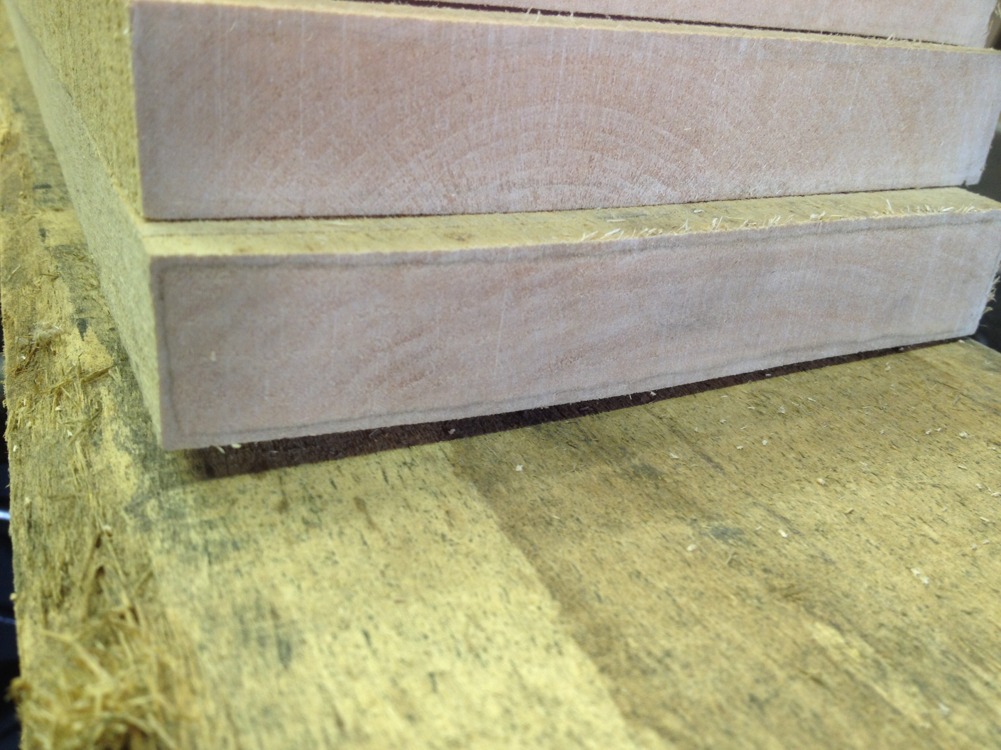

I just started cutting up some basswood and noticed this.. Does anyone know what causes it? Thanks for any info.

It is an enzymatic oxidation stain caused by slow drying initially. Ok?

Thanks Gene. I was surprised that the extent of color change was so discrete and uniform. I appreciate the response, I've never seen this before and it's interesting to me.

Unfortunately, I have seen it before. One other possible cause is that the lumber was dipped in a fungicide solution that had iron tannate in it, but in that case, it would not have gone so deep.
