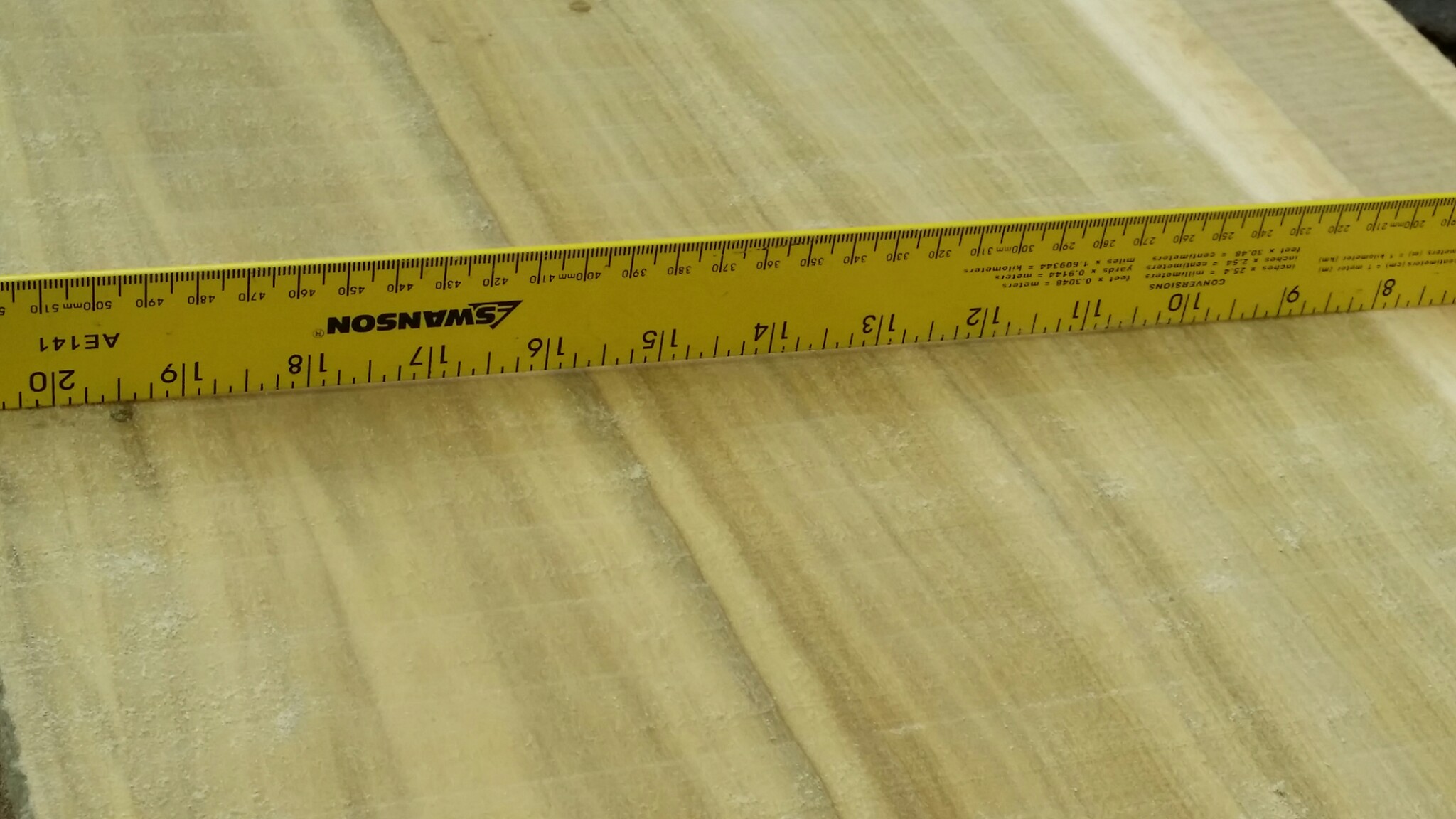

Yes I do. more to sawing then just sawing logs. I noticed after I sharpened the blade the blade was slowing down because the belt was slipping from the blade being so sharp. Now I need to get a new belt. Also that was a 22'' poplar log that I was cutting.
