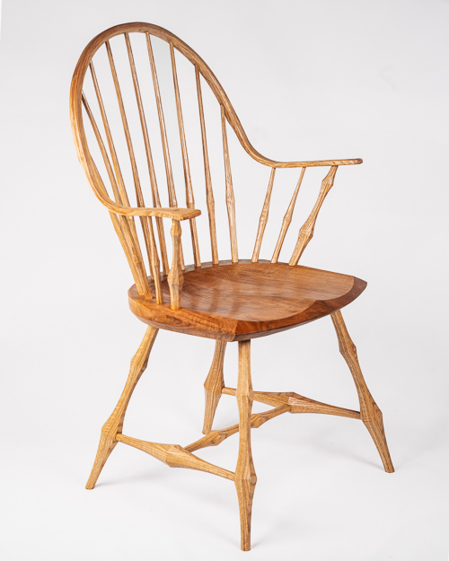

To be more specific to my situation, I am building Windsor chairs with oak heartwood spindles that sometimes have powder post beetle holes. Is the strength loss just what the beetle removes, or should I be worried about fungal decay around the hole (besides any decay that I can see with the naked eye; i.e. spalting sapwood, etc.)

The issue with true powder post beetles is not the tiny hole. It's the long channels in the wood under the surface. I've seen infested wood that you could break up with your hands. I would definitely not use that in thin spindle work. In fact most windsor chair makers rive the spindles out of the log so the grain runs the entire length and has the springy characteristic needed for the most comfortable chairs. And red oak can also be brash and brittle compared to woods like hickory.
11/19/20       #7: PPB fungus ...
Gene Wengert
I agree with rich c.
Brash oak will be found in slow growth wood (more than 7 rings per inch). Also brashness results when oak has been dried at too high a temperature (over 160 F) or down to a MC under 7.0% MC.
Even a few degrees of grain angle substantially weakens the wood. So, it is indeed critical that the dowels or spindles always be sawn parallel to the grain, the grain direction is determined by splitting a log and then sawing parallel to the split surfaces.

I understand all that. I rive my stock, shave it with a drawknife following the grain perfectly, use fast grown oak, dry it at 140F.
If I have a single powder-post beetle hole in the 5/16 diameter tip of a white oak spindle, do you think I should consider the strength loss to be the size of the hole, or is there a possibility that the wood surrounding the hole is weakened.
There are no major unseen tunnels beneath the spindle's surface, since the beetle activity ended when I made the spindle (I put the spindle in the kiln right after making them).
Thanks!
Elia
11/20/20       #9: PPB fungus ...
rich c
The hole you see is the exit hole. An egg is laid, the larva forms and works it's way into the wood to feed and grow. When it's mature it bores out of the wood and repeats the life cycle of mating and the females lays more eggs. If it's powder post beetle, there are ALWAYS channels under the hole, unless you were lucky enough to cut off all the tunnels and you only have the exit hole left. If you don't see channels anywhere, it's probably not PPB. The spindles could easily be tested if the hole causes issues with breaking a couple to test strength. Better to find out before shipping to a customer. As a caution, the center of the wood must reach a minimum of 133 degrees. Most kiln operators sterilize at 150 degrees to insure complete sterilization of the interior of the wood.
