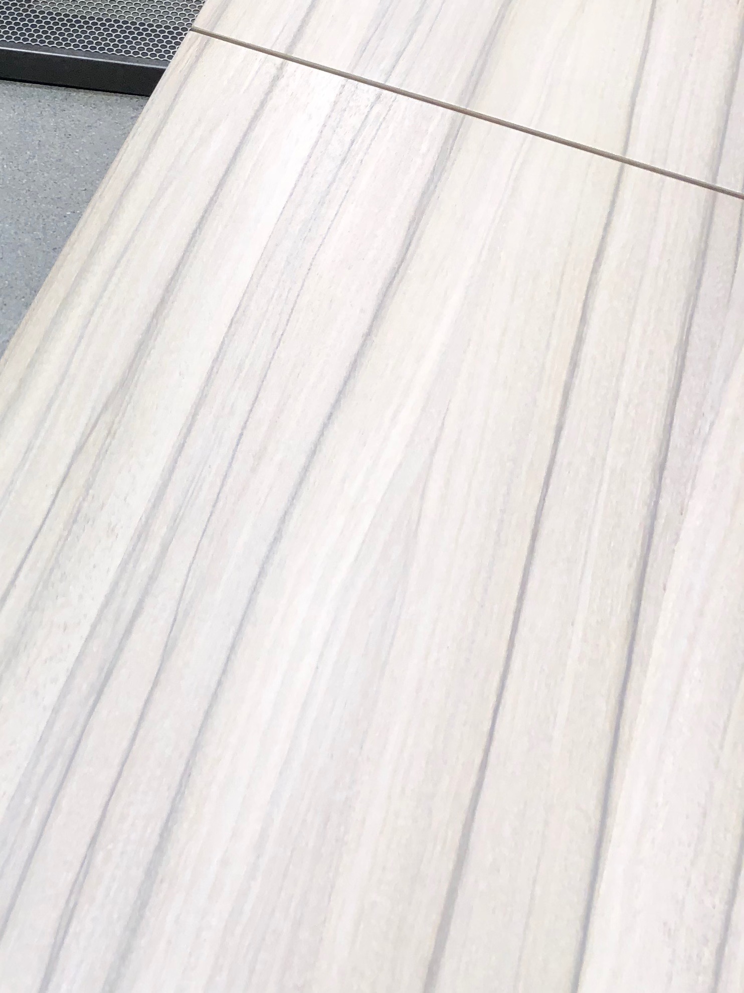

Hello Woodworking Prefessionals, I have been looking all day for this wood species and have had no luck. If I can’t figure it out my competitor will get this job. Anyone have some ideas? I’m thinking it is probably dyed or bleached. Any guesses would be appreciated! Tried straight grain Ash & Tineo which have similar grain patterns but not the white/grey coloring.

It looks like poplar that has been bleached or pickle stained.

Maybe Tineo, maybe Teak, but I'm leaning toward Paldao. Any other pictures?

Bleached black limba maybe or red gum.

Thanks guys! It was Bleached Paldao 👍🏻
