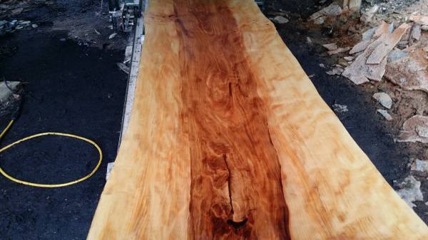

I sanded this Beech and it looks really nice. I'm planning on using Pentacryl Wood Stabilizer to keep it from checking. My plan is o just rub the Pentacryl on from time to time as the water evaporates.

Beech is not prone to checking, like oak is. So, with proper drying, you do not need a chemical treatment.
I am curious if The chemical you mention can be or is applied by just rubbing it in from time to time. I have always seen the wood being soaked in it, which means it was used on smaller pieces. It is too expensive to use on lumber.

here is what beech looks like sanded with some sand and seal on it.
