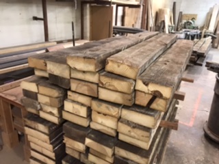

The company I work for has committed to reuse joists salvaged from a building as stair treads and risers in the new iteration of the building. As proposed the concept is unworkable. They want to retain the original surfaces of the joists, which were flattened on one side with an adze and then sawed on the other side to 2 1/2” - 3” thickness. We need to glue up two joists to get to the 11” finish width. The joints will not line up, there are crowns and twists in the joists, etc., things an inspector will reject as unsafe.
I am working on plan B which I envision as milling the joists to make them uniform and distressing them to give the sawn looking surfaces. I am attaching a picture of the material for reference. Any tips would be greatly appreciated.

Which side is the proposed finish surface?
How long are the treads going to finish to?
It'd be a PIA, but a router jig for flattening slabs could be used to give you reference surfaces to joint for glue up.
I would definitely cut to rough length first; shorter pieces are easier to get flat
Old stuff is cool and all, but always tough to work into something like stairs or doors where dimension and flatness are paramount

What about resawing the rough faces off and glueing them on to the face of an LVL or dimensional framing lumber joist?
Any solution is going to be a lot of work and as you say, I'd guess any inspector worth his/her salt is more than likely going to want a stamp which is going to shoot using that material in the foot I would imagine.
Telling them to get inspector approval first would likely save you a lot of head scratching. My guess would be if they really want the look and the cash is in the budget applying the material as a veneer to an approved material will be the easiest. If they are trying to salvage the material for the look AND thinking it will save buying stringer material, your probably sunk.
Will be spendy.

We used reclaimed a few years ago, we milled it to about 1/"2 with a smooth face.
We laminated it to LVL
We also reused the beams in the building for wall paneling.

Is it against code to leave a 1/4" gap between two boards? Happens all the time on outdoor decks. You could even use a spline that is centered on the thickest and bottomed out in the grooves, but still leaves the 1/4" gap.

Cross cut to length. Skip plane high points. Joint edges. Bond with West System Epoxy. Sawn side up.
