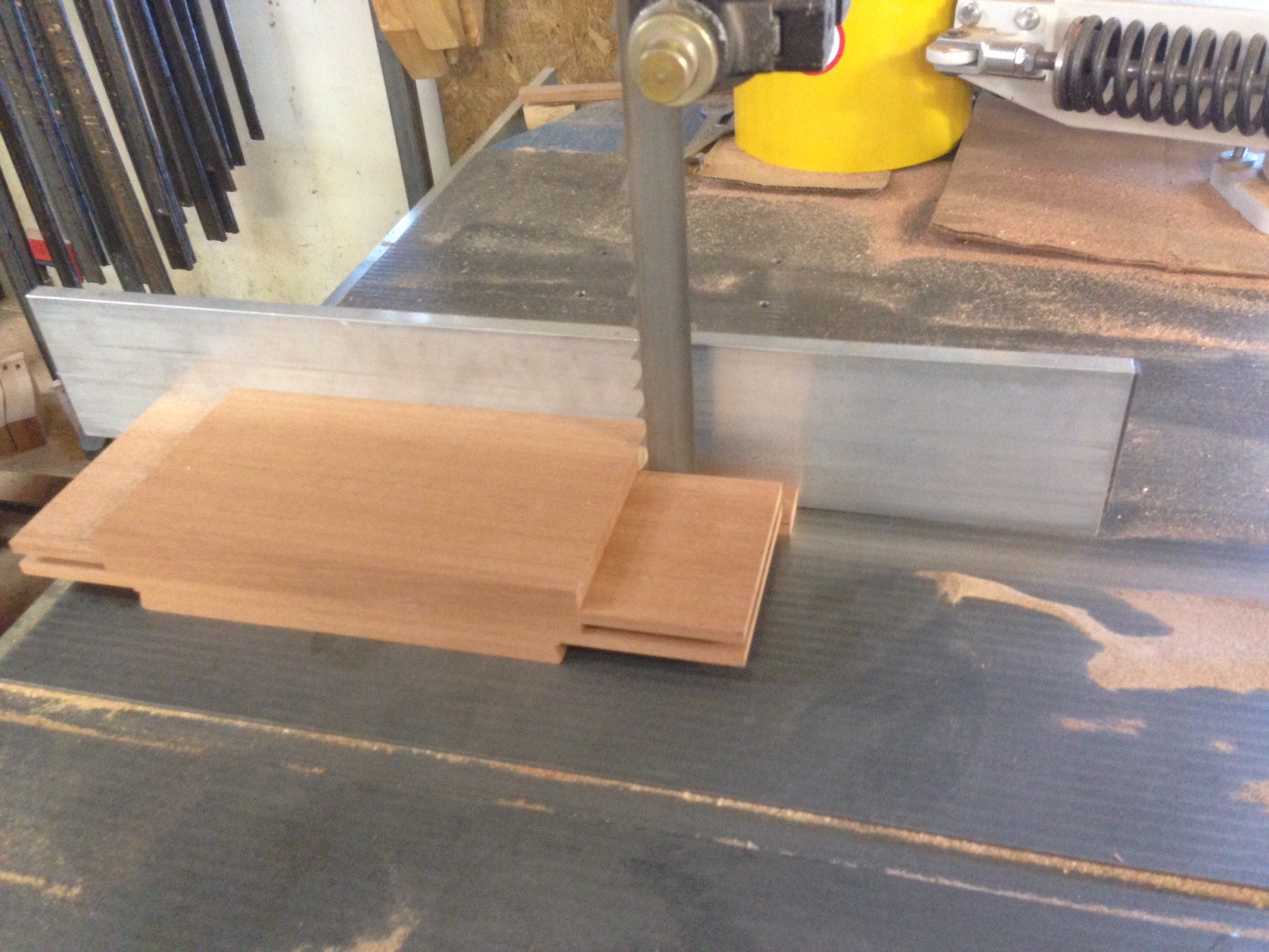

With passage doors, I set a fence on the band saw and make one stopped cut for the length of the haunch, and then another stopped cut for the width. Two set-ups, two passes for each rail end plus handling. I'd love to simplify, but that hauncher looks like it would make relish if you got too near it.

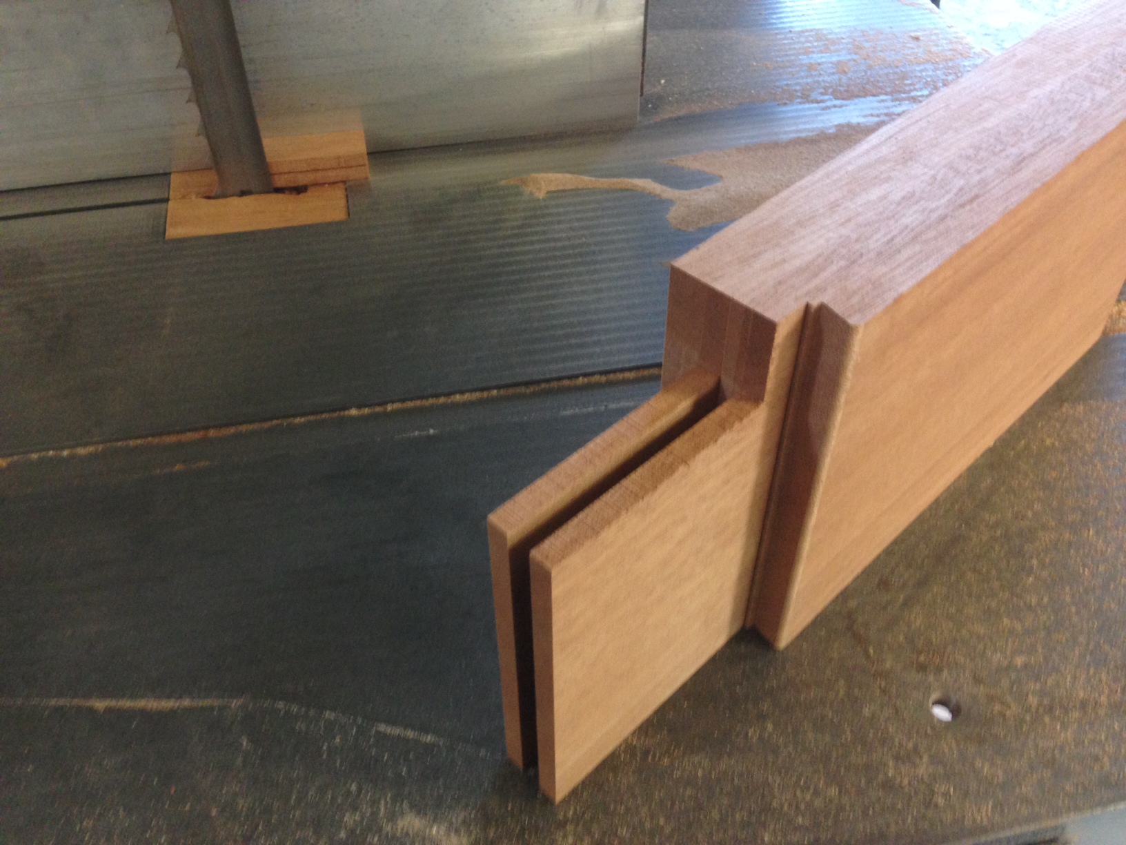

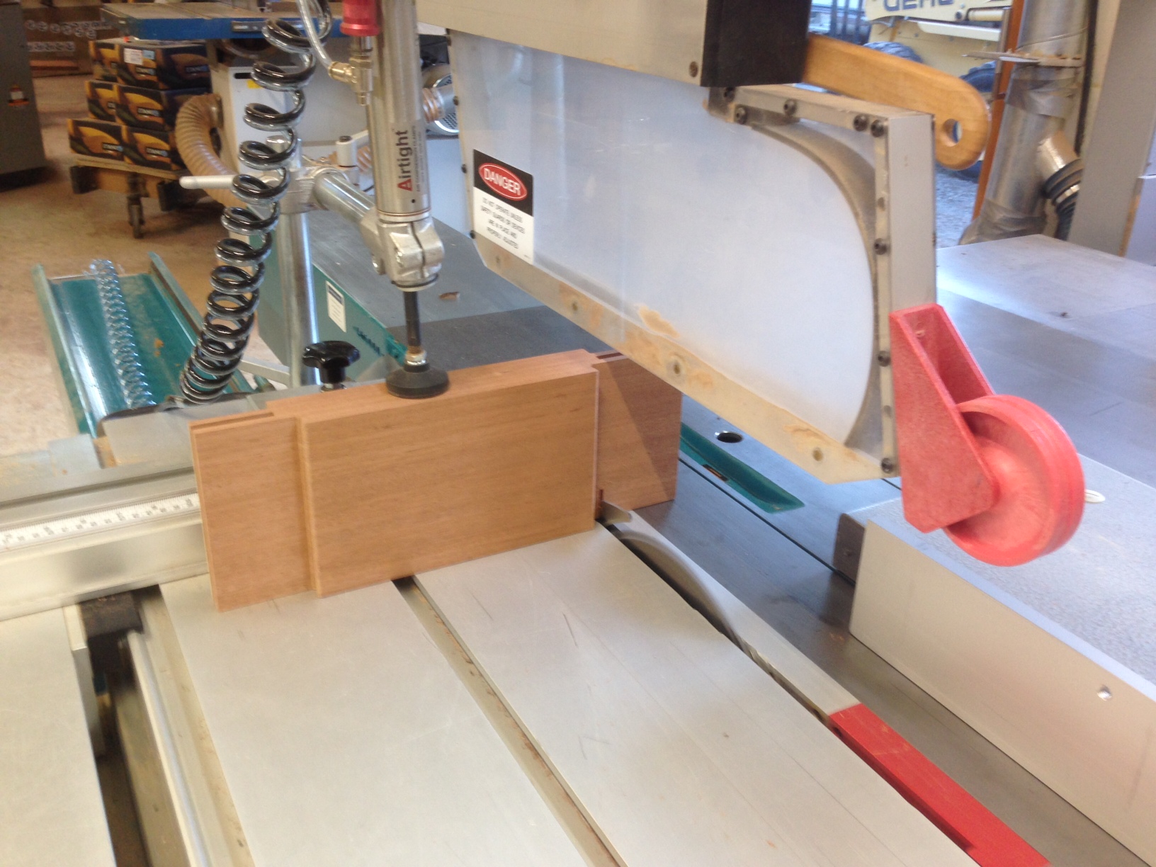

We use slot and tenon for window work and narrow stile doors. The only time we do any haunching is on entry doors. We use the sliding saw for the cheek cut and the band saw to finish it. Accurate enough for us.

On a Griggio G4 tenoner, so no that won't do it as you've suggested. I like the bandsaw method the best and is what I've always done but without the fence. The fence really helps. I had a run in with my tablesaw a year and a half ago and I try to only rip with it.

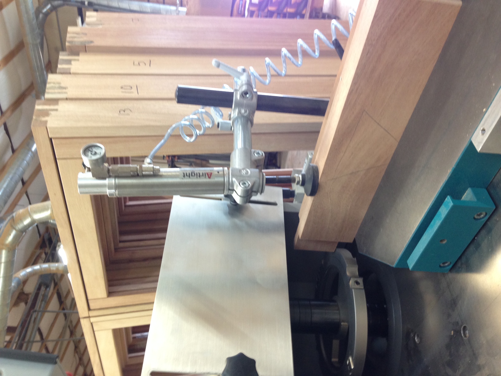

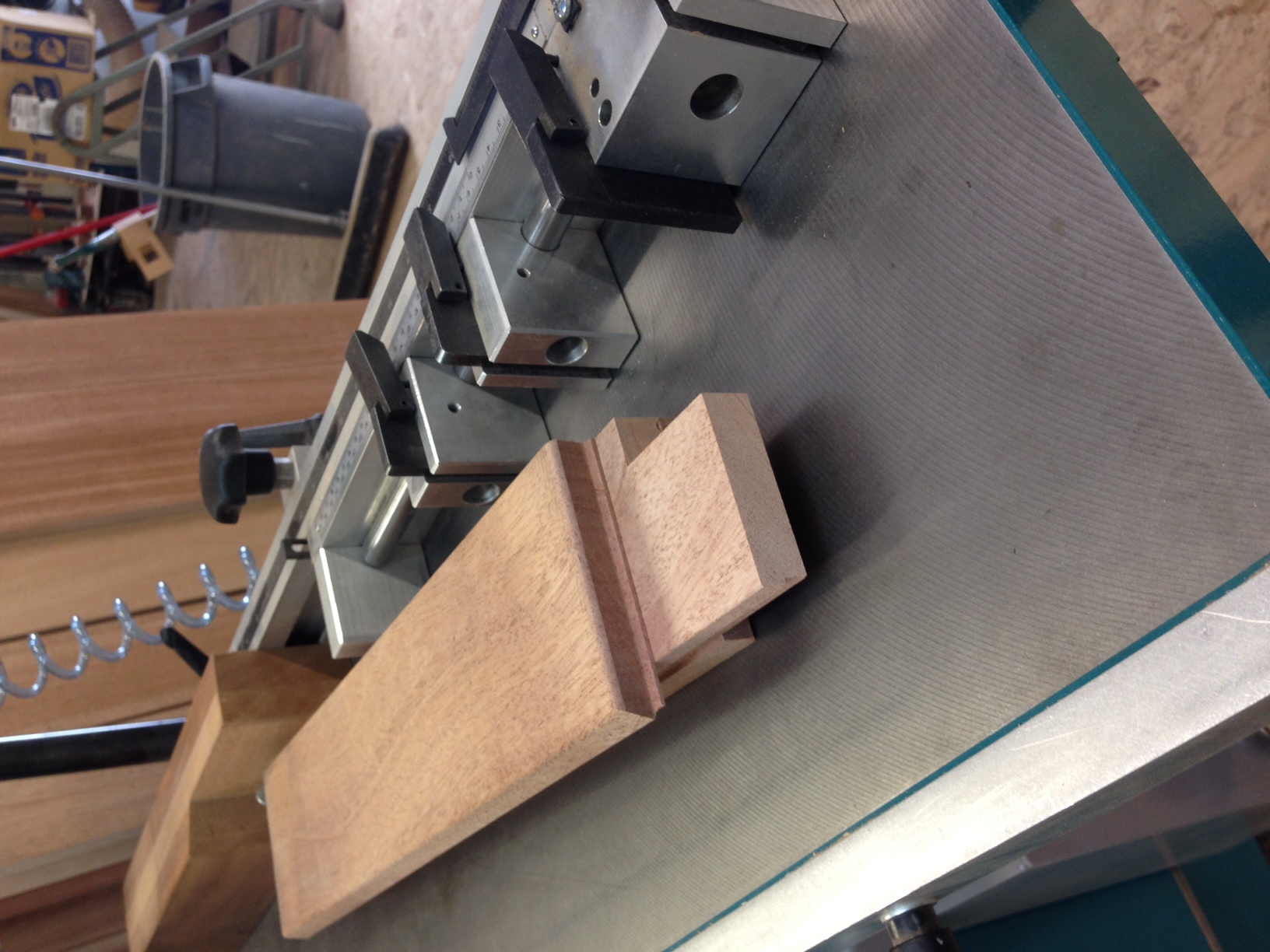

Joe Calhoon
Here is more info about relishing as it relates to windows on the AWWM site. Looking at the picture on the site I now see why it was necessary. The tenon in this historic work comes out in the sticking so it is necessary to do something offline either with a relisher or mortiser. On all my tooling the tenons fall below the sticking making it easy to haunch.
Just for kicks I tried doing window size workpieces on the shaper. One pass and easy to keep precision. For small quantities the saw and bandsaw is probably what a I will continue to do.
