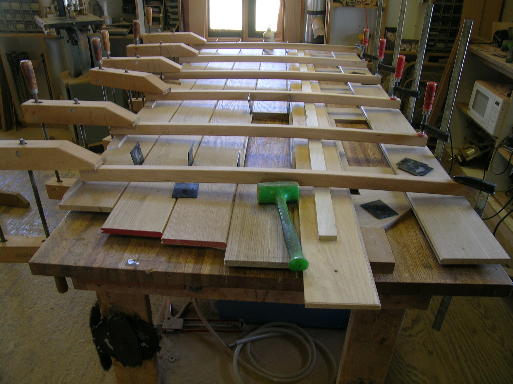

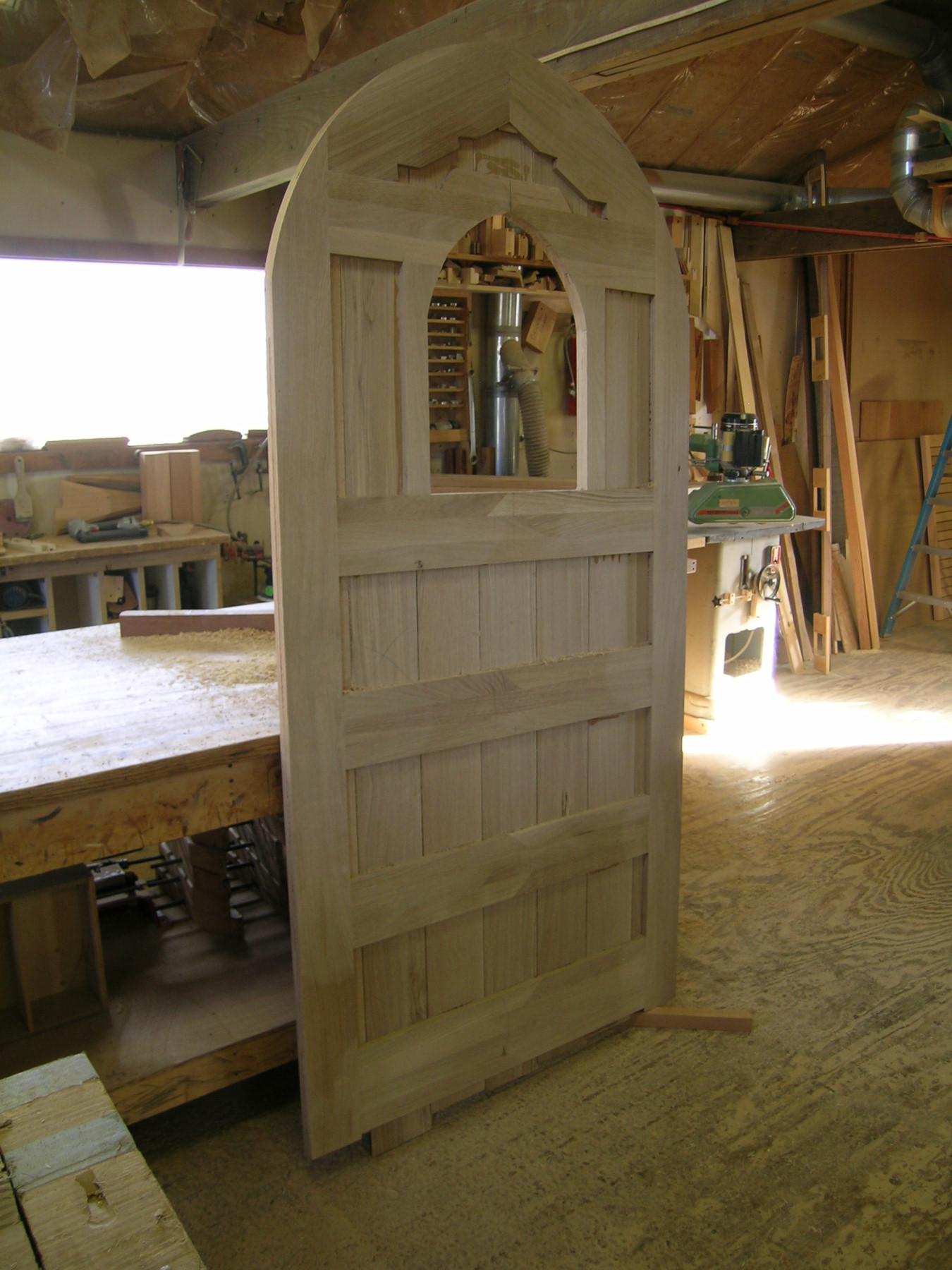

I like solid wood for the ladder core so the stile sides are all the same species - looks good and will take hinge screws well, etc. It is a good chance to get rid of the 'wood of less desire'. We will try to make the T&G faces at 5/8" and then the core is 1" just so it feels a bit more stout. But 3/4" all the way through is fine also. Long tenons, please.

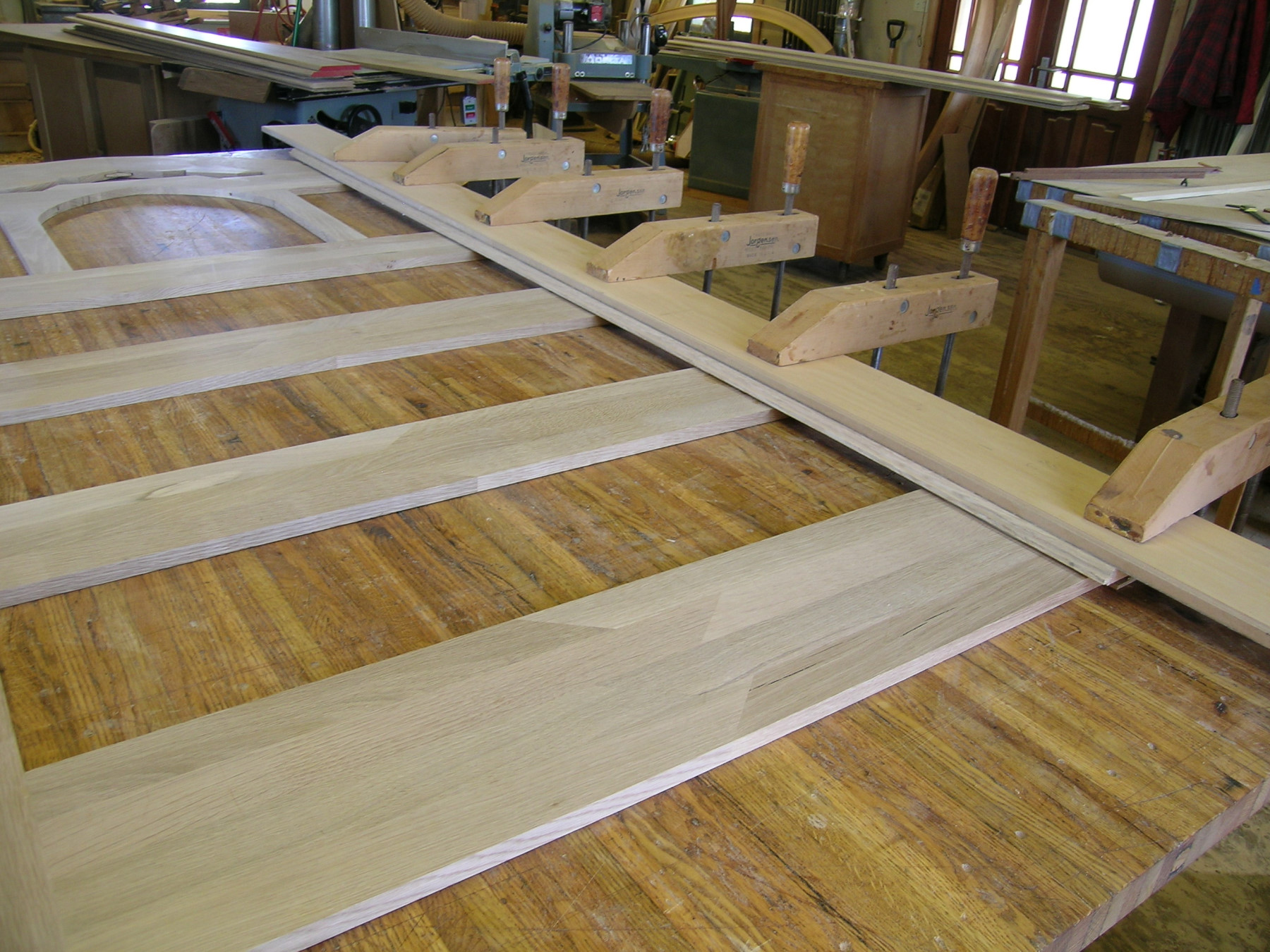

We glue the boards on the frame full width. The planks are generally no more than 6" and are often rift. So, I'm betting they don't move. V-joint is the norm, and the small area that almost meets is a good crush zone if/when the boards expand.
25 years ago, slaving myself to the rules, we stood on our heads for this one door, and only glued the center of each board. 1/4 of the width had glue and 3/4 did not. The edges curled up about 1/16" all along every T&G. The planks were cupped, with their centers down at the glue. It was a wine cellar door, so weather was not a problem. The door had been moved, unfinished, moved again, etc. No one complained, and I never looked back.
We may pin a starter plank in place, but the planks are added one at a time, with spacers on a flat bench. Flat bench repeated for effect. Start flat, stay flat, I always say.
Caulking the T&G can be hairy - too much caulk will either make a mess or prevent the boards from going where you want. We gave it up long ago. We make the T fat to the G and they are a tight fit - must be hammer tapped or clamped to pull them together to the spacers.
Insulation can be run thru a wide belt or even a planer. The side to sides should be real snug so as to be air tight.
The vertical edges will be made of the the three layers of wood. The top and bottom should be cut to size and then painted with epoxy to prevent water absorption. This is the one thing you can do to really help the life of your doors. Painters never 'seal' the tops and bottoms, so you might as well do it. Wd like Sikkens for the exterior. Remember, darker finishes age faster and can heat the wood. Heat can even cause a glue like TBIII to loose more than half its strength at 170 degrees. UV is harder on the finish than rain. Overhangs are not only friendly to your doors, they are nice for guests to duck under while you open the door.
My remarks above are suited for a full plank door as in the photos. Any horizontal rail will complicate things on exterior work. You do not want v-joints or panel gaps allowing water into rail plows.
