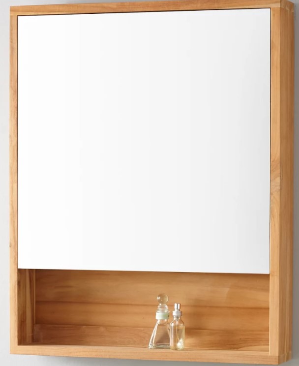

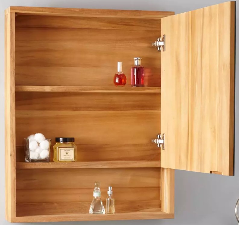

vc
I'm thinking of copying a design I saw (photos attached). It seems they used 3/4" teak, but I want to use 1/2" plywood and 1/4" mirror. They seemed to just glue the mirror to the wood with no additional support. Their mirror dimensions were 22" h x 21" w, and mine would be about 25" h x 16" w.
Any thoughts?
