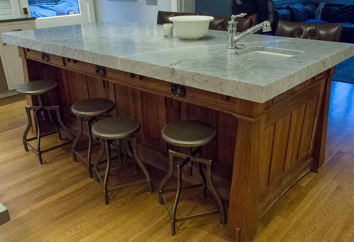

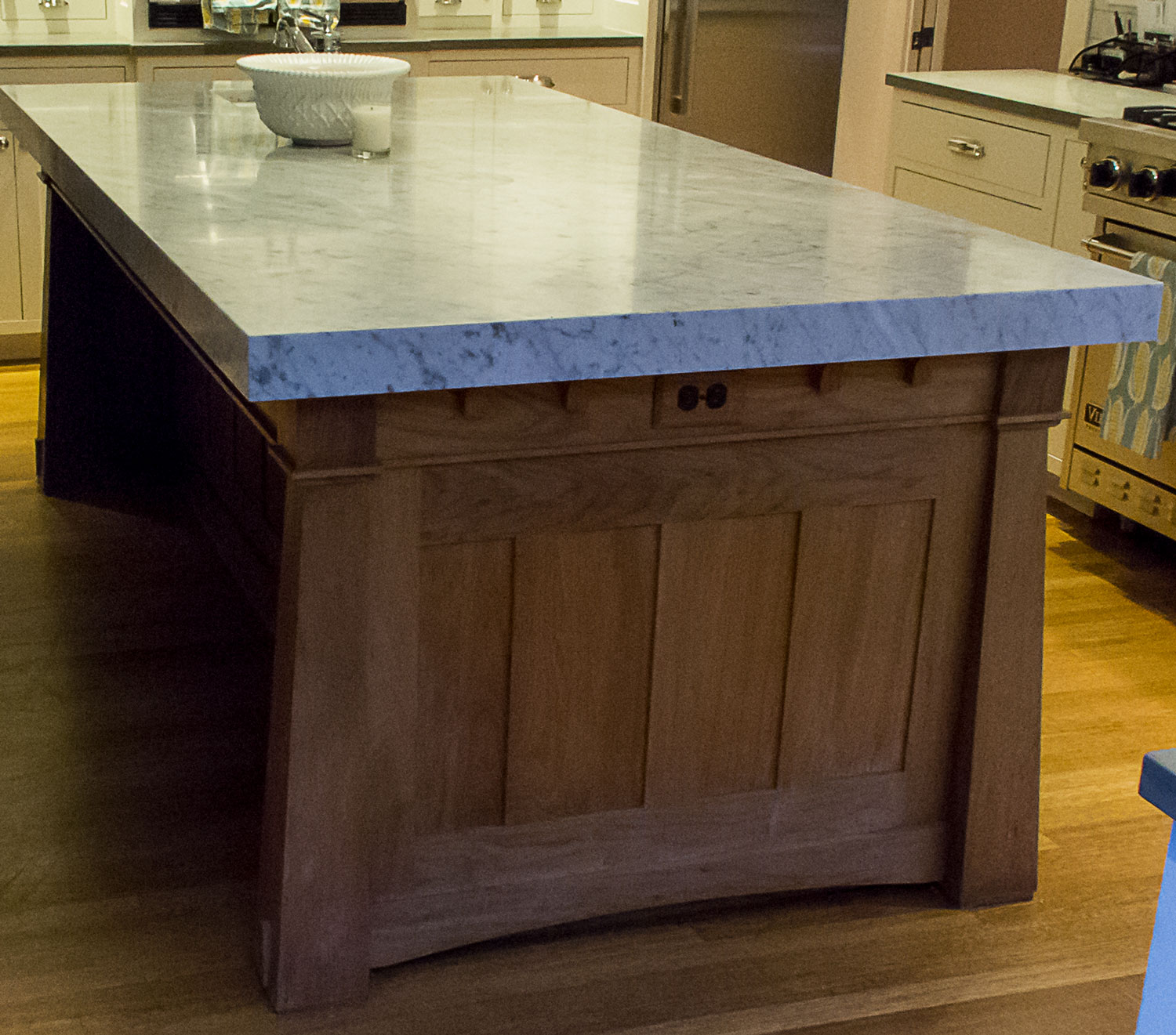

We built this walnut piece about 6 years ago. The finisher on this project used the cheapest nitrocellulose finish he could find. It was basically just one step up above hairspray.
The customer would like to refinish this himself and is looking for recommendations of technology he could handle himself. I told him that a brushed finish would produce a patina that could endure and would be easy to maintain. I wish they would have done something like this in the beginning.
The finish protocol I have in mind resembles one I saw many years ago. The finishers sealed Douglas Fir baseboard and casings with benite then applied a very dark brown stain. They then shot two coats of nitrocellulose on it to produce build. All of the finish at this point was produced in the carport.
After the spray was dry the carpenters chopped and installed it. They used colored crayon putty to fill the nail holes. After this was done the painters back brushed 2 coats of SPAR varnish onto the finish. The critical part was the varnish. It was not a self-leveling kind. Any brush streaks or high spots that were present in the first brush phase were still there after the second brush application. The second coat did not meld with and flatten the first coat.
The final effect was something that looked very very old. It was like what you would expect to see in a lumber baron's house built at the beginning of the last century. It looked like it was in a room that was produced 100 years ago then closed to the public.
I don't think this is ever going to look like a new piece of furniture again. I would like to see it made a little brighter and the walnut to have a little more luster.
Can anybody recommend a brush-able finish that a civilian could apply? Would optimally like to have something that is not "self-leveling". Would like to maintain the "aged" look. Any suggestions?

Does your customer share your vision for how the finish should look? If so, then the widely available Minwax polyurethane applied with a good brush should fit the bill. I would not use a waterbase as that tends to deaden the wood rather than make it come alive. So your customer will need some paint thinner for cleanup as well. I suppose they don't even need to sand between coats if you truly want the rustic look. The poly will be thick enough out of the can to leave the brush marks, and it's formulated to be user friendly. It's extremely durable, available in a variety of sheens and doesn't smell too bad. That's what I would recommend.

That is interesting question about whether or not the customer shares my vision. We are getting ready to build a new kitchen for them in a better neighborhood so I am guessing they do. They sold this house and renting it back for a year so there is time to figure this out.
When we built the job I did not have the talent to photograph it. I have the skills & resources now to do that properly.
I like your idea of the MinWax. That would leave a little residue in the corners which seems to make things more forgiving. I think what I will do is donate a couple guys to go over and do the initial sanding for them to help expedite this.
