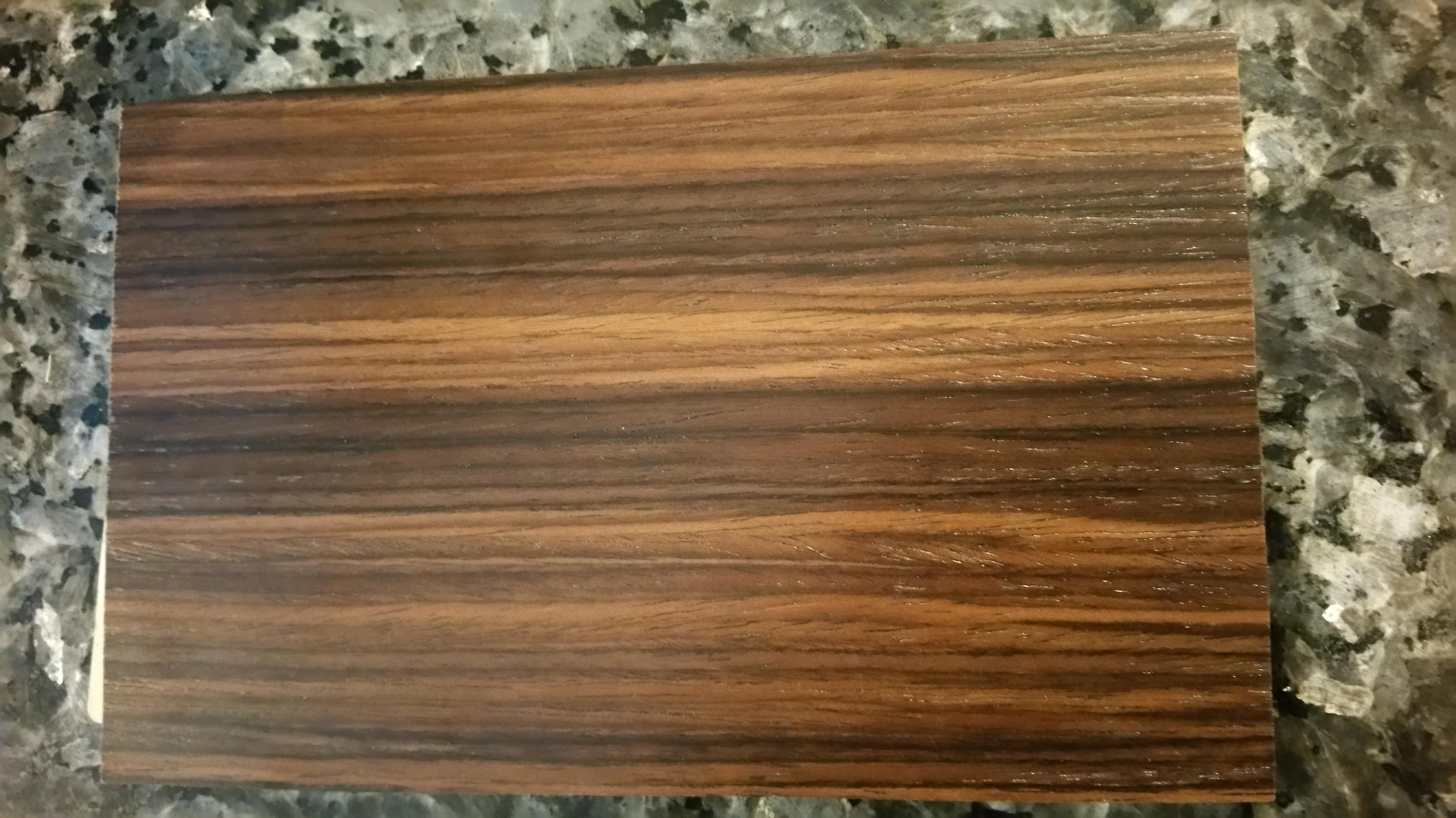

I have a customer requesting bathroom cabinetry from rosewood. I have sourced the lumber and plywood needed, but given the cost, would like to present some alternatives. Has anybody come up with something that comes close in grain and color? All quotes were for santos rosewood, which I believe is bolivian or pau ferro.I have attached a sample that the customer found and likes.

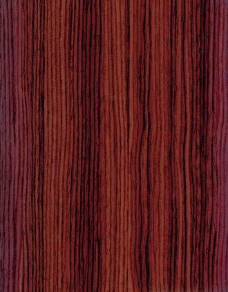

You could try a man-made veneer, like Brookline. It's not a perfect match, but definitely close enough the average person wouldn't know the difference. And it costs substantially less than natural Rosewood. Take a look at Brookside's website and see what you think for yourself.

Thanks for the responses. When the customer told me about using rosewood, I warned him that it was a pricey species but would happily get a price together. He asked me to come up with an alternative for him to consider. They have not as of yet seen the pricing, but I am trying to have both options ready. I am not trying to talk him out of what he wants, just trying to provide some options. My supplier stocks quarter sawn walnut on mdf, which isn't real close in color, but might get the straight grained look they are after.

I thought I would post a picture of what Brookline Rosewood looks like (I am not connected with Brookside in any way, so not trying to sell you on it, just providing info). This will get you much closer than Qtr Walnut in my opinion. It will save the customer a ton of cash and give them the look they want.

IMHO, Kevin's picture actually looks like recon. Try the link below for Brookline Ceylon Rosewood which is more brown than John's picture

11/4 #8: Rosewood Alternative ...
Joe, you are absolutely right. I took a look at the picture blown-up and there is no doubt in my mind that it is man-made veneer.
So as far as a more economical Rosewood substitute, I don't think you will find one. The man-made veneer will cost a small fraction of what natural Rosewood would cost you.
