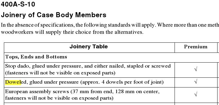

64 on center is for drawers. I thought doweled cases were 128, but that is for confirmats. Dowels are a more flexible 4 per foot.
I don't know the rule of thumb, but boring machines typically drill the edge holes ~11mm deeper. I prefer a minimum of 12mm face holes and 35mm dowels.
View higher quality, full size image (734 X 354)
