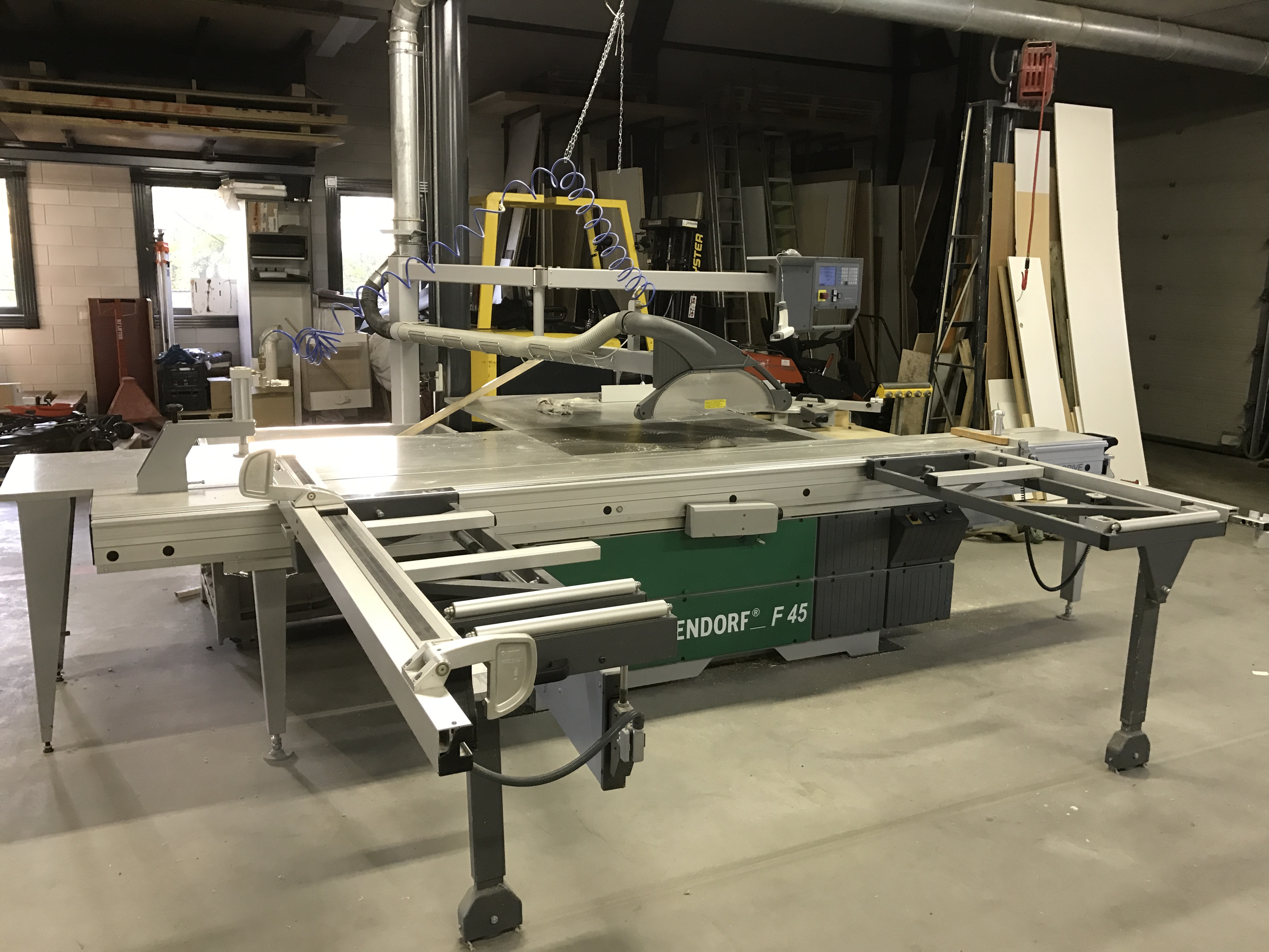

Altendorf F45 scoring blade
2/23/17
carmine Member
The left/right tracking adjustment of our scoring blade stopped working. When we hit the adjustment switch we can feel two clicks/pulses at the arbor from possibly a solenoid but no movement.
Any suggestions on the cause of the failure before we call a tech
7/18/18       #2: Altendorf F45 scoring blade ...
Carmine, have you gotten your issue resolved. I had the same problem with my scoring blade. It happen to me in April. It ended up being the "mother" board. Cost me almost $2K for a 2 year old saw. Four weeks ago, I had the same issue, but different problem. Now the servo drive motor is the problem. I still don't have it fixed, and I can't get an answer. Very frustrating. I loved my saw til this happened. MIKE
5/24/23       #4: Altendorf F45 scoring blade ...
Corne Bergen
heb eenF45 Elmo 3 .
display werkt niet meer, hierdoor kan ik zaag niet meer bedienen.
display haperde de laatste tijd al wat meer.
Als we zekering F 7 er uit halen kan ik wel zagen .
Kan mij iemand helpen aan hoe dit aan te pakken .
