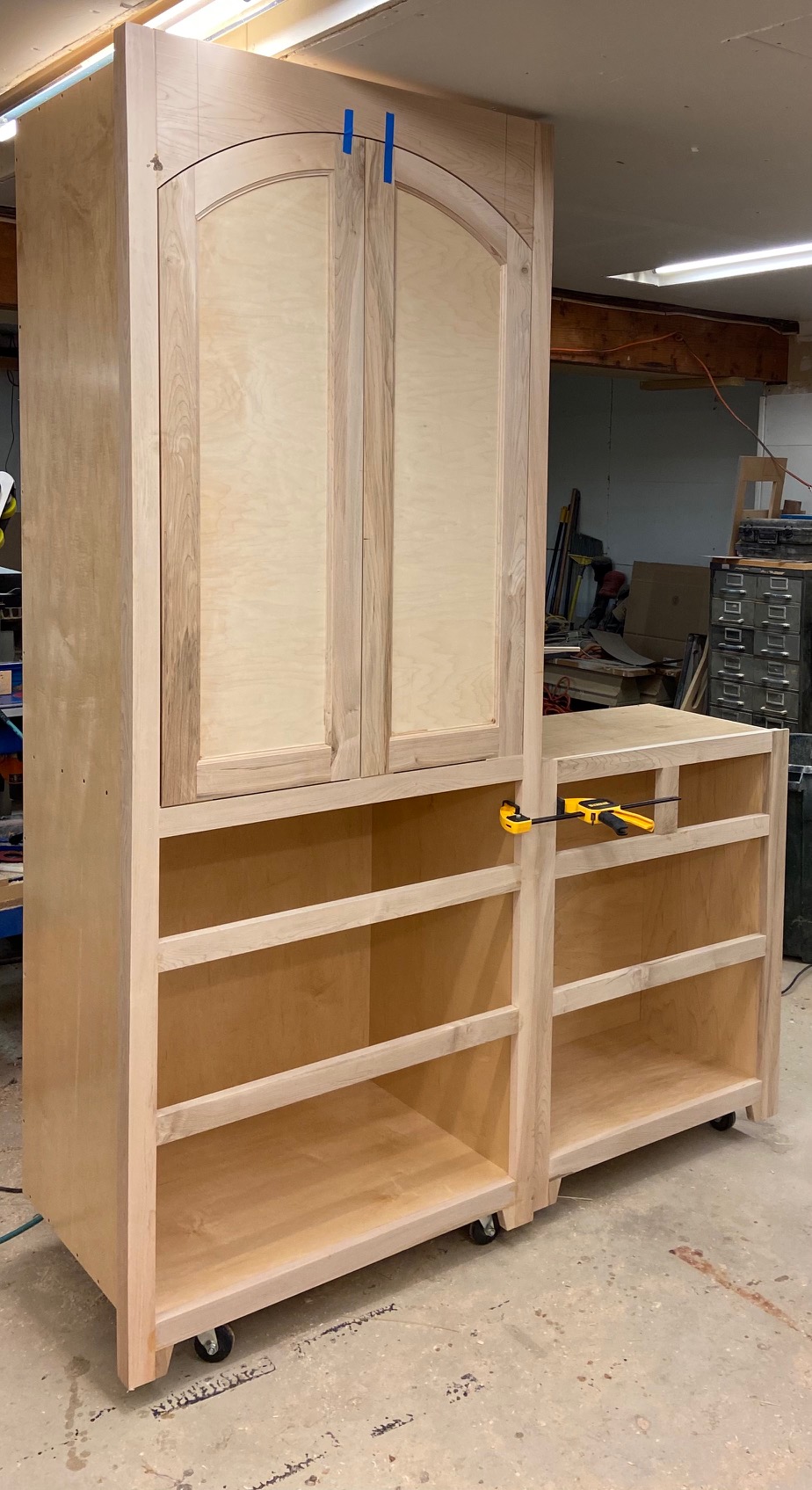

I’m looking for a hinge that will work in this application, photo attached. Set of doors with arched top, inset with 1/8” reveal.
I normally use Blum inset 95 degree thick door hinges for everything, 71B9750 (doors are 1” thick) but I’m getting a binding issue in the corner once I hit about 50 degrees open.
Any advice appreciated, thank you.

Salice will do, Dennis (rep from Salice) will tell you the right model #, I use the 155 deg. model with 1'' thick door, works very well. I use the C2PKPE9.
10/15/20       #3: Hinges for arched top doors ...
I would agree, Ed.
This ( C2PKPE9) is the 155 degree, inset, soft close, screw-on. The C2RKPE9 would be the same hinge with dowels. The hinge fits the standard 45mm X 9.5mm pattern. A 6mm mounting plate would also be your best bet, BAR3R69 And a hinge bore distance from the edge of 6mm.
If you would like samples for a trial mock-up please let me know.
Best of luck
Dennis

Thanks very much for the advice — I will give those a try.

The Blum 170º work. I did something almost identical a few years ago.
It's a pisser when the hinge you thought would work, binds
10/15/20       #6: Hinges for arched top doors ...
Blum 155º zero projection half cranked with a face frame adapter would work and it has soft close.
