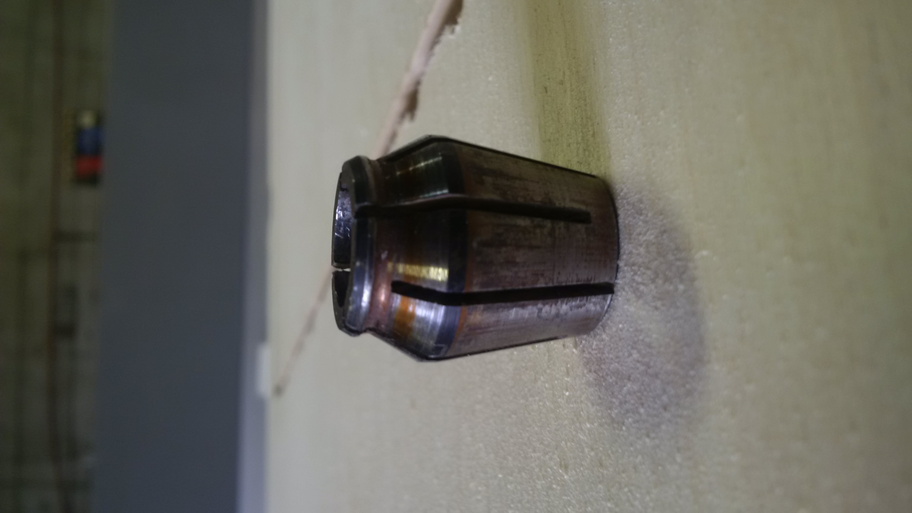

Not CNC but I hope someone can ID this collect for me. Its 27.3mm tall and 24mm wide.

http://www.tools-n-gizmos.com/specs/AF_Collet.html

https://www.sommatool.com/catalog/collets/acuraflex.asp ???
Looks similar anyway...

Thanks Guys.
Not the right sizes.
The collet is the way I got it :)

what is the collet for
9/6/18       #7: Collet ID ...
It's an older SCM pin router.

The best route may be to try to determine who manufactured the motor for the pin router and the age of the motor then research. That design was predominantly for hand routers and varied to some degree from mfg. to mfg.
