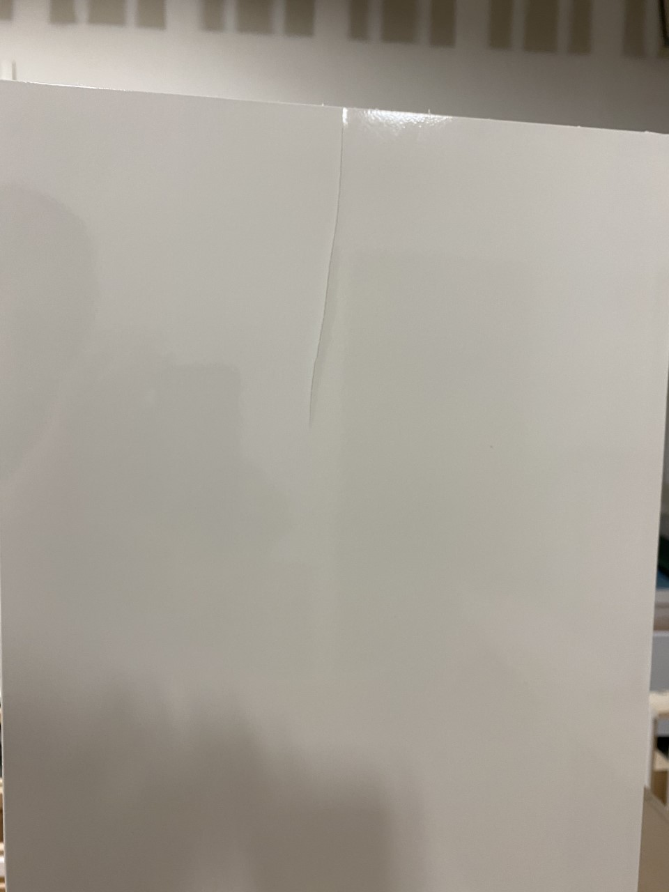

Did a job with Resistant and Krystal gloss for a glossy finish, this is a end panel of a cabinet that we apply a Paper back Maple veneer with Wilsonart canister adhesive, few months later some cracks show up in the veneer, not sure what happen, but need to solve this and to avoid future problems, any help will be much appreciated, thanks

Paperbacked veneer is a horrible product in my opinion. You have two glue bonds to worry about. The paper to the cabinet, and the paper to the veneer. Too hot of solvent in the finish and you can get a partial release of the bond between the paper and veneer. Two ply veneer is far superior!

See http://www.woodweb.com/knowledge_base/Contact_Cement_Failure_with_Veneer_after_Fin
ishing.html
and
http://www.woodweb.com/knowledge_base/Troubleshooting_Finis
h_Cracking_Checking.html
