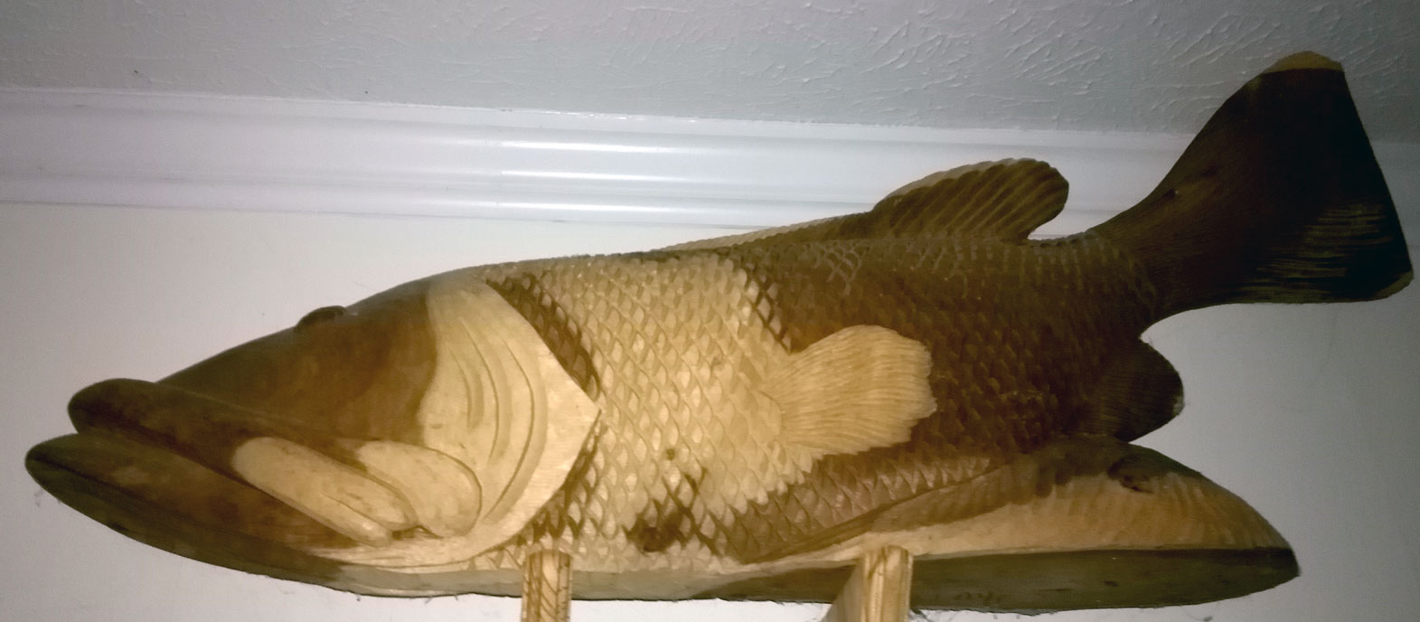

Hi, I hope you can give me some advice,
I have this fish sculpture that I would like to stain and protect. I was thinking an antique tobacco color, mainly to reduce the contrast on the lighter wood. I bought it in the Bahamas many years ago, the sculptor said something about soaking it in oil or gasoline, which I declined to do.
Anyway, the wood is claimed to be mahogany and the size is about 3' long.
The problem I see is that I can't do anything that involves wiping or sanding. The rough finish would catch on a cloth.
I though about soaking, but the size makes it seem difficult.
Thanks for any pointers.
David

The one thing I would not do is soak it with oil. You say it is a rough carving, just think of that with a nice sticky oil on it collecting dust.
Bring it to a professional finisher and tell them what you want it to look like. This way your not learning how to finish on your collectable.
I would make a sap stain and tie in the sap streak area, Bring your overall color down with a dye stain, washcoat it with a non-sanding sealer, glaze and hi-light as needed. Finish off in proper sheen of your choice.

Spray on stain, you can protect areas to get a sharp line of color or just spray the whole thing one color.
Then spray a few topcoats, you'd likely like a dull sheen. Enough for a slight shine in the right light, but no apparent gloss.

Its quite unique....just leave it as it is.

Looks like a Grouper?

Thanks for the feedback, I will look into a professional refinisher but that may not be an economic option for me.
It is some species of grouper, maybe just the sculptors idea of a grouper. Anyway, I like her (the big ones are females)

I'm with Robert....... Leave it as it is. It's not going going anywhere. If it's indoors just give it a good dusting every once in a while. Now if it was going to hang out in the pool house I'd think about giving it a coat of automotive 2K but otherwise it should weather the storms of indoor climate acclimation for years to come.

My first thought was a Watco or Waterlox type finish. It ticks all of the boxes.

A penetrating oil finish will protect the wood from moisture. Rub with #2 steel wood right after you apply the stain. Let it harden for several days. Rub with fine steel wool then apply a final coat. The more coats that you apply, the glossier it will become. I would use walnut color.
