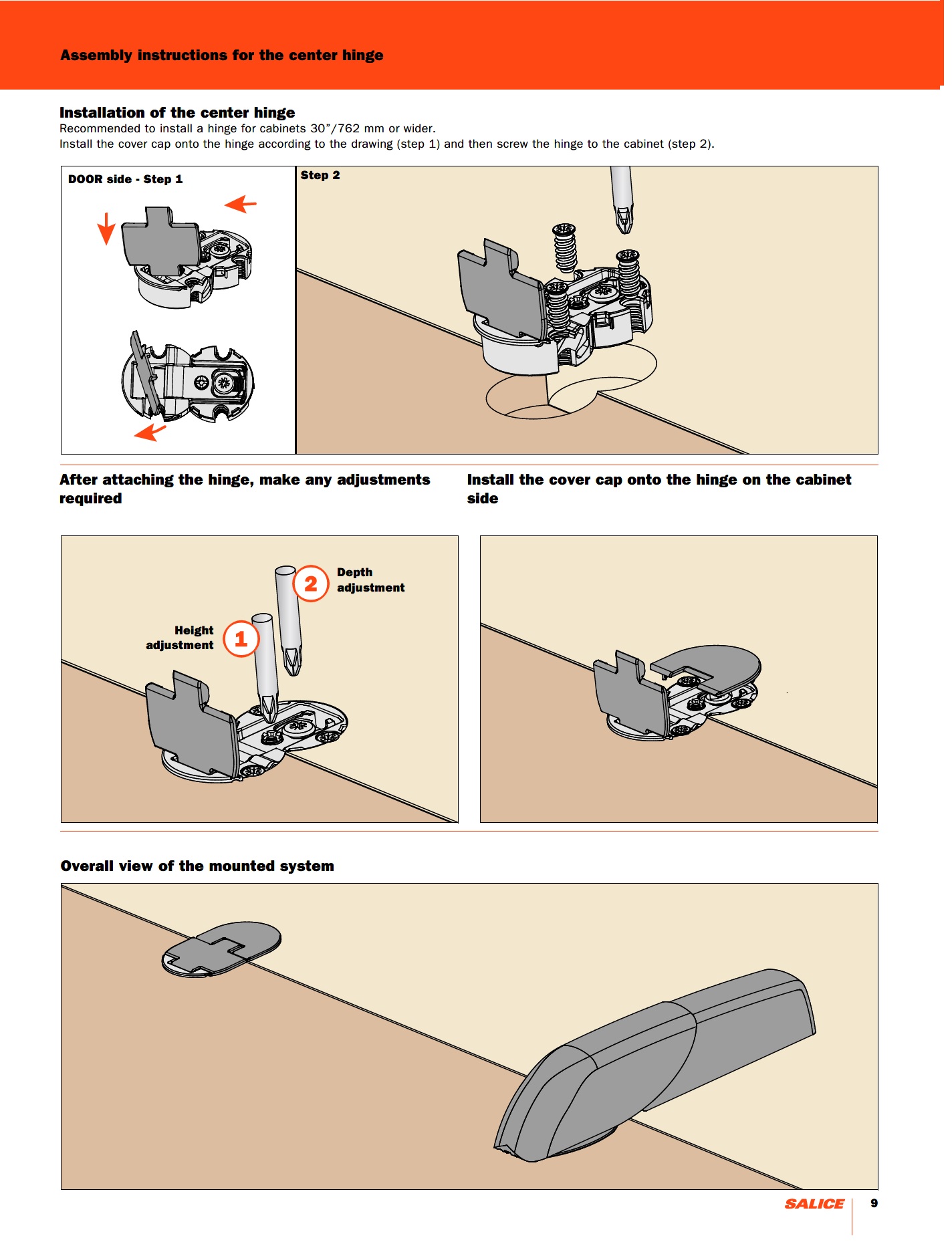

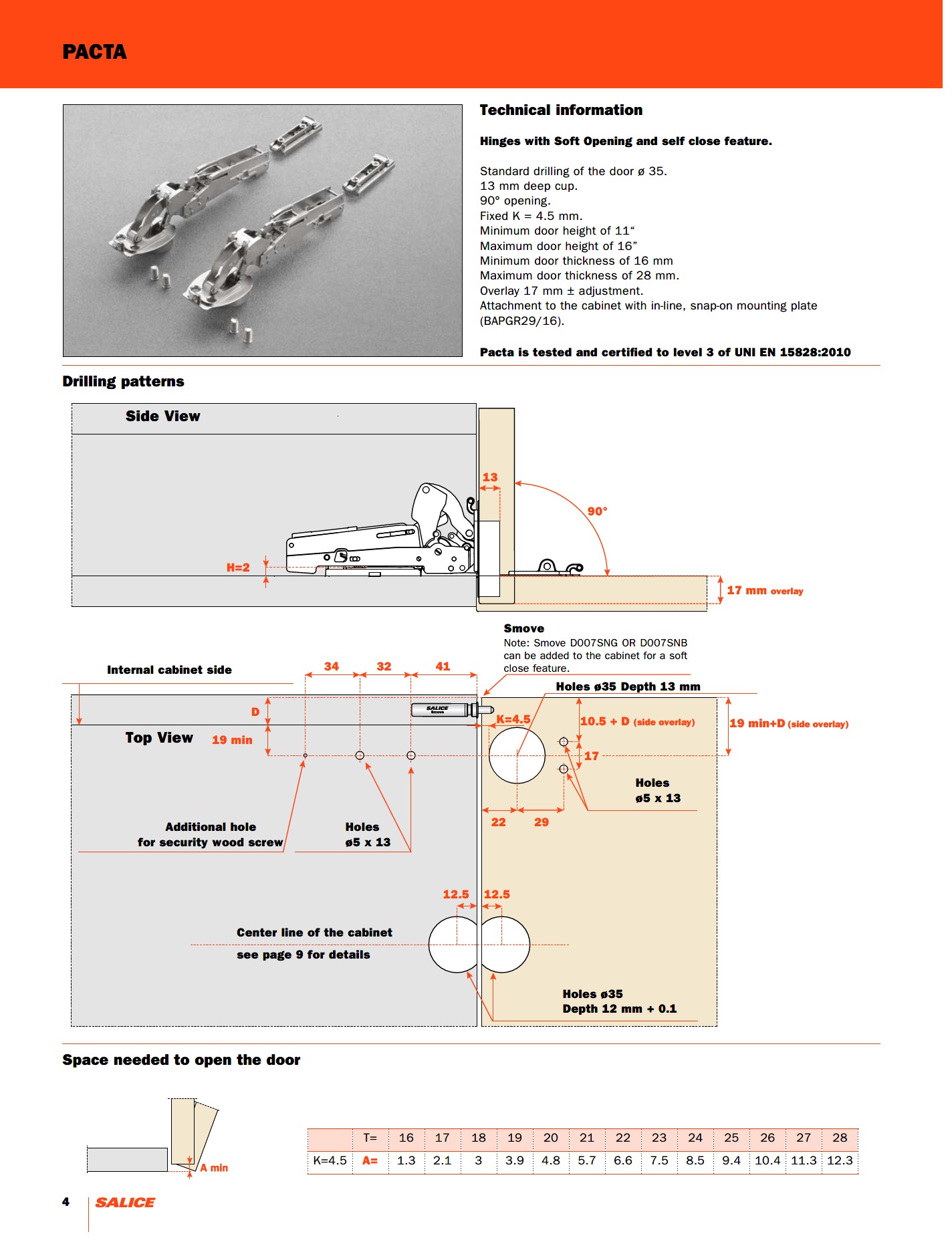

The Pacta by Salice is a hardware system for drop down doors you may not have seen before. Pacta fits your requirements for the drop-down shelf to position flat and in-line with the bottom of the cabinet. Pacta is available with soft close or with Push to open features. There are several color options available for the decorative cover.
For a 40" wide unit, we recommend the use of a specially designed flap style hinge for added support.
Here is some information on Pacta. You can also download the full catalog from our web site.
Pacta is readily available from any Salice distributor.
Best of luck,

There would be no need for friction hinges with Pacta.
All Pacta hinges are soft opening and give a gradual soft drop down of the door. The leaf type hinge shown is only necessary for doors over 40" and is recommended to support the center to prevent later warpage of the door.
The center hinge has a movement that is the same as the left and right Pacta hinges. This insures a perfect synchronization of all hinges.
Thanks & happy new year!
Dennis
