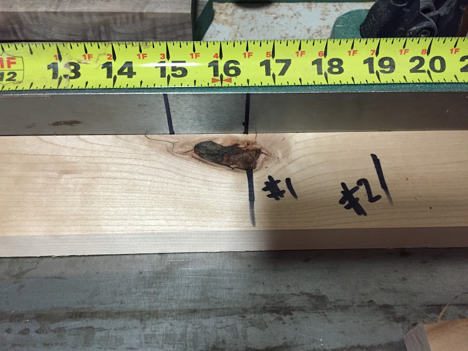

I was cutting a cabinet door job this morning and thought about this post. Here is what I came up with:
Measure kerf to edge of blade guard. Mine is 1.5". Then make a couple of corresponding marks somewhere convenient, like the back fence. I marked up a board to show how I used these reference marks. By putting these lines at the infeed edge of the blade guard, the cut will be in the right spot.
View larger image
7/27 #11: Placing your cut on an upcut saw ...
Here are the results. A no-mark method would be to just put the desired kerf at the leading edge of the guard, grab the board with a thumb or finger at the right mark, and slide to the left mark.
View larger image

"A no-mark method would be to just put the desired kerf at the leading edge of the guard, grab the board with a thumb or finger at the right mark, and slide to the left mark."
GREAT IDEA!!
I think - will have to try it out.
Thanks!
