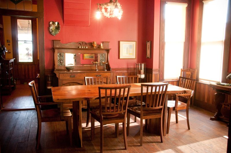

Thanks for the comment about the low-bid mentality. That was indeed my concern when I heard of that method from my contractor colleague (if indeed it’s fair to call that a method). I agree 100% that doing it right is much wiser than doing it quick. I forgot to mention that the house this is going in is a Craftsman style home: and in those, they did use B&B wainscot.
Click here for higher quality, full size image
"Photo by Bob Card of Greenwood Bay Woodworking Studio".
I feel much more confident based on your comments, and Contributor N's as well. I now have a better plan of attack.
From contributor O:
It may be just a matter of semantics, but I think the image you offered is frame and panel, and built with mortise and tenon. The intermediate stiles are all vertical, and the only horizontals are at the top and bottom. All the members would be plowed, and receive the panels. Panels should be thick enough to not deflect on contact, perhaps even reverse raised.
Good to hear you are on the right track here. Being a natural cynic, I shake my head whenever I hear Craftsman and budget in the same sentence. People forget - or don't know - that the essence of Craftsman style was to celebrate the worker's craft and to design work that had to be done by hand, keeping the soulless machine work in a secondary position to the craftsman's abilities.
From the original questioner:
Contributor O - I think you're right. It comes down to semantics and you are correct. The image I showed is pretty much the look we are going for, but is not truly board and batten. I referred to it as board and batten to differentiate from the more common raised panel appearance that seems to be everywhere (which also often seem to be poorly made.) Thanks for the clarification.
Indeed, this is really a frame and panel design, which means (and getting back to my original question) it can be shop made for the most part and installed in sections with just some minor job site tweaks.
I also agree with your comment about what Craftsman style really represents, particularly how it was a response of sorts to the mass (machine) produced excesses of Victorian design. I think that's why so many people today are drawn to Craftsman, A&C, Mission style homes, and furnishings.
