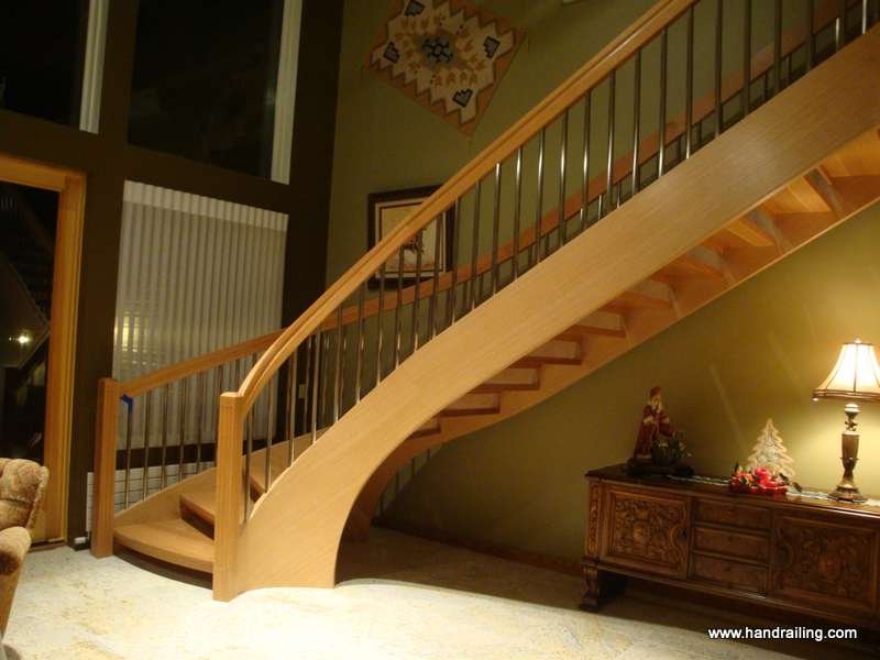

I use epoxy when joinery requires gap-filling. There are photos here of a stair we did joining straight stringer sections to curved. The joinery was done with threaded rod and epoxy set into deeply drilled holes at the ends of the stringer sections. The glue-up shown is of 24" x 5/8" rods being glued and holes being filled with thickened epoxy. The dominos are mostly there for alignment.
When the poplar stringer core was complete, we veneered it with 1/16" rift white oak.

Here's a photo of the finished stair
