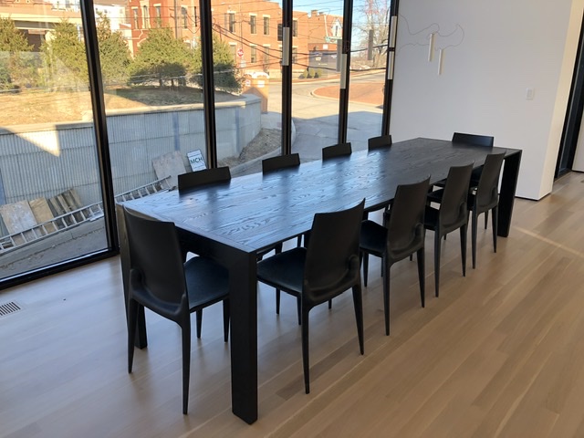

Mike Barber
I built a 10’ long dining table out or torrified ash and used Titebond 3 without any problems. This includes laminating two thickness for the legs as well as gluing up the top.
