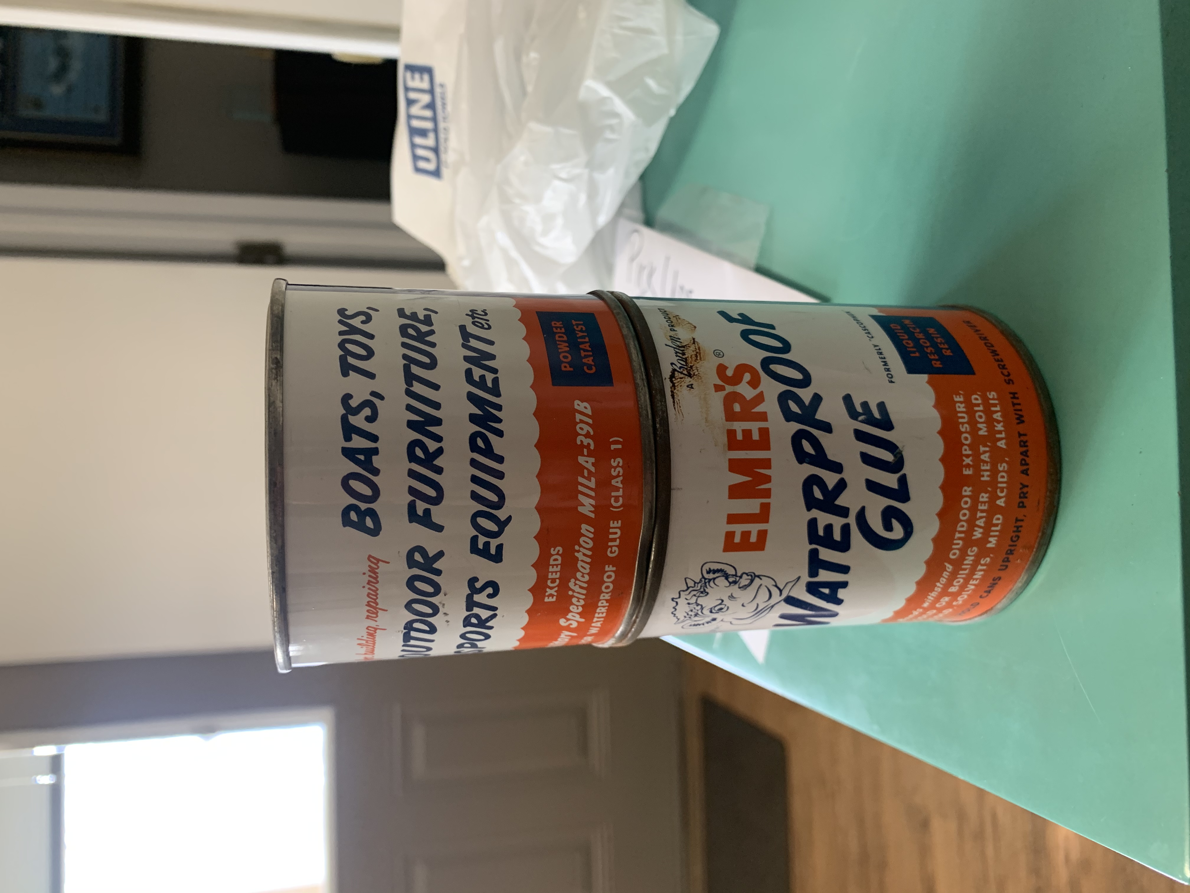

I used resorcinol in the 70's for exterior work. It came in little cans taped together for catalyst and resin. From Elmer's. It required pressure and heat, but it bonded better than other glues. I still have post caps that look good after 40 years. The wood is nearly gone, but the resorcinol glue line is still there.

Here’s a blast from the past 😁
