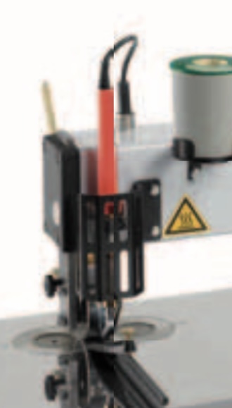

So anyways I had a bit of a mishap, a board leaning against a wall fell over and hit the wand on the end of the heating tube on the Kuper 630 stitcher and broke the plastic off on the base. That part has quite a bit of movement but I was wondering if someone could recommend an adhesive that would maybe hold.
Thanks for any help.
I guess I should have taken a picture but didn’t. Will try do that. I added a picture from the website, the orange part broke off near the base.

If it is a rigid plastic and the break is a tight fit together you could try Cyanoacrylate glue. I like to use a glue system with an accelerator to ensure alignment. The joint isn't as shock proof as epoxy or polyurethane but is quick and isn't messy.
It will not work with some plastics like polyethylene or polypropylene nor will any glue.
Another option is to repair the tube with a sleeve that bridges the two pieces or fabricate a new part.
11/23/20       #3: Glue for plastic ...
West System G/Flex epoxy
Don’t be turned off by the cost or the little bottles. It’s a one of the kind flexible/toughened epoxy. They have a demo video where they cut a plastic kayak in half and glue it back together. Then throw it off a bridge.
West System epoxies are the standard by which every other epoxy is measured.
G/flex has been around for 10+ years
