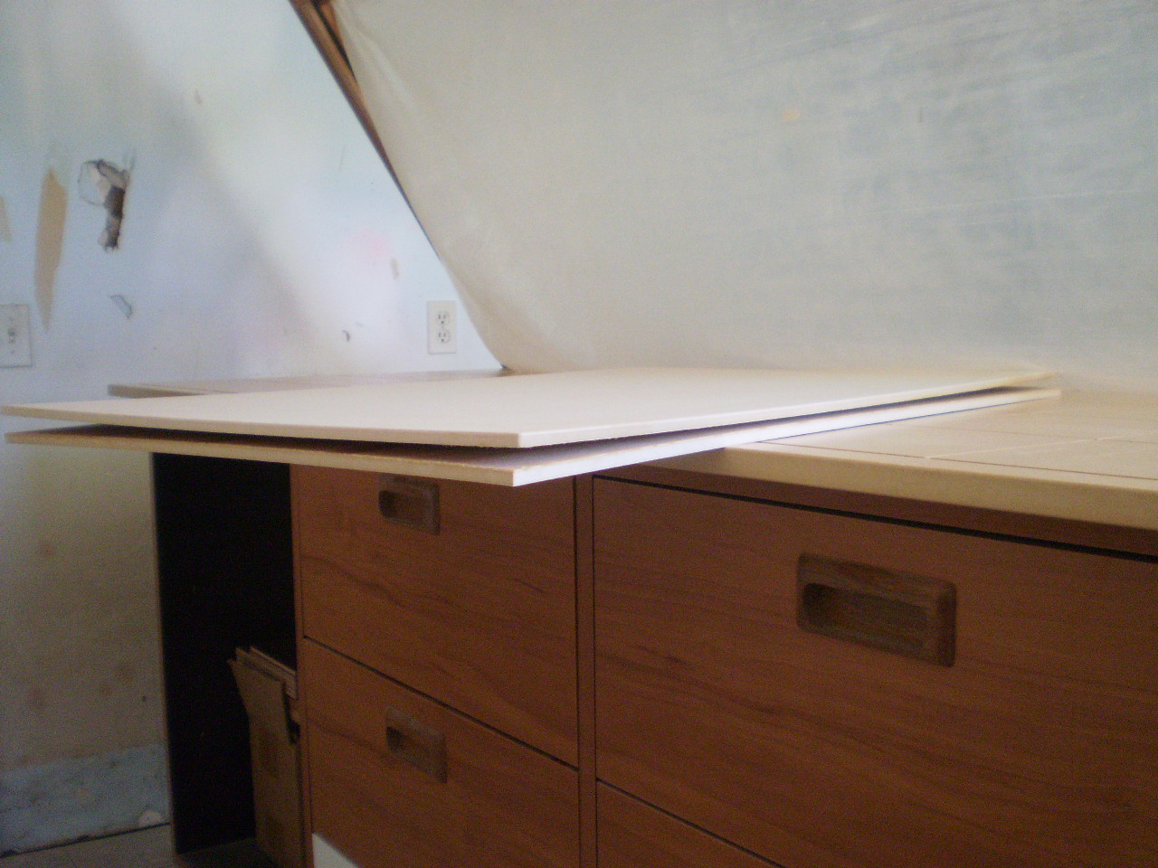

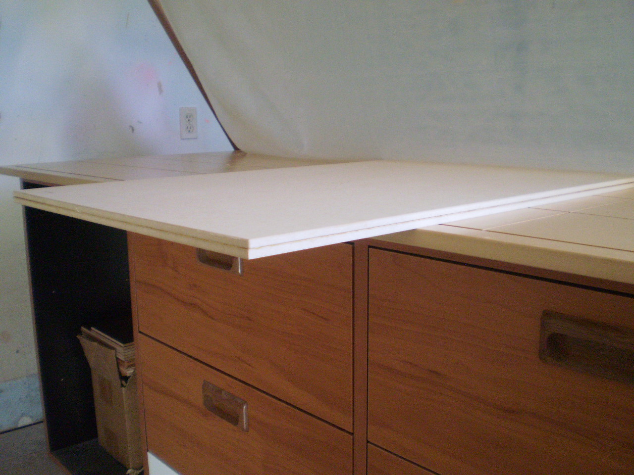

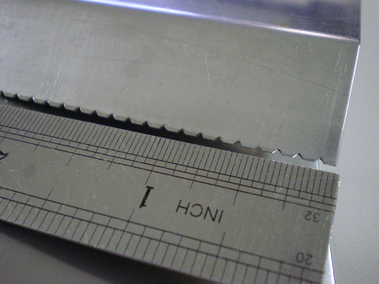

I use type 2 PVA because its quick, easy and reliable - no worries about mixing, temperature, starved joints etc. I use a custom notched spreader to insure a minimum consistent glue line, All flat veneers get pressed for 30min.
While a balanced end product is essential, a case for doing the two sides 12hrs apart could be made (re: Tom's post and something I do on large layups). The example images show bowed substrate and cover sheet coming out of the press, both flat 12 hrs later.
