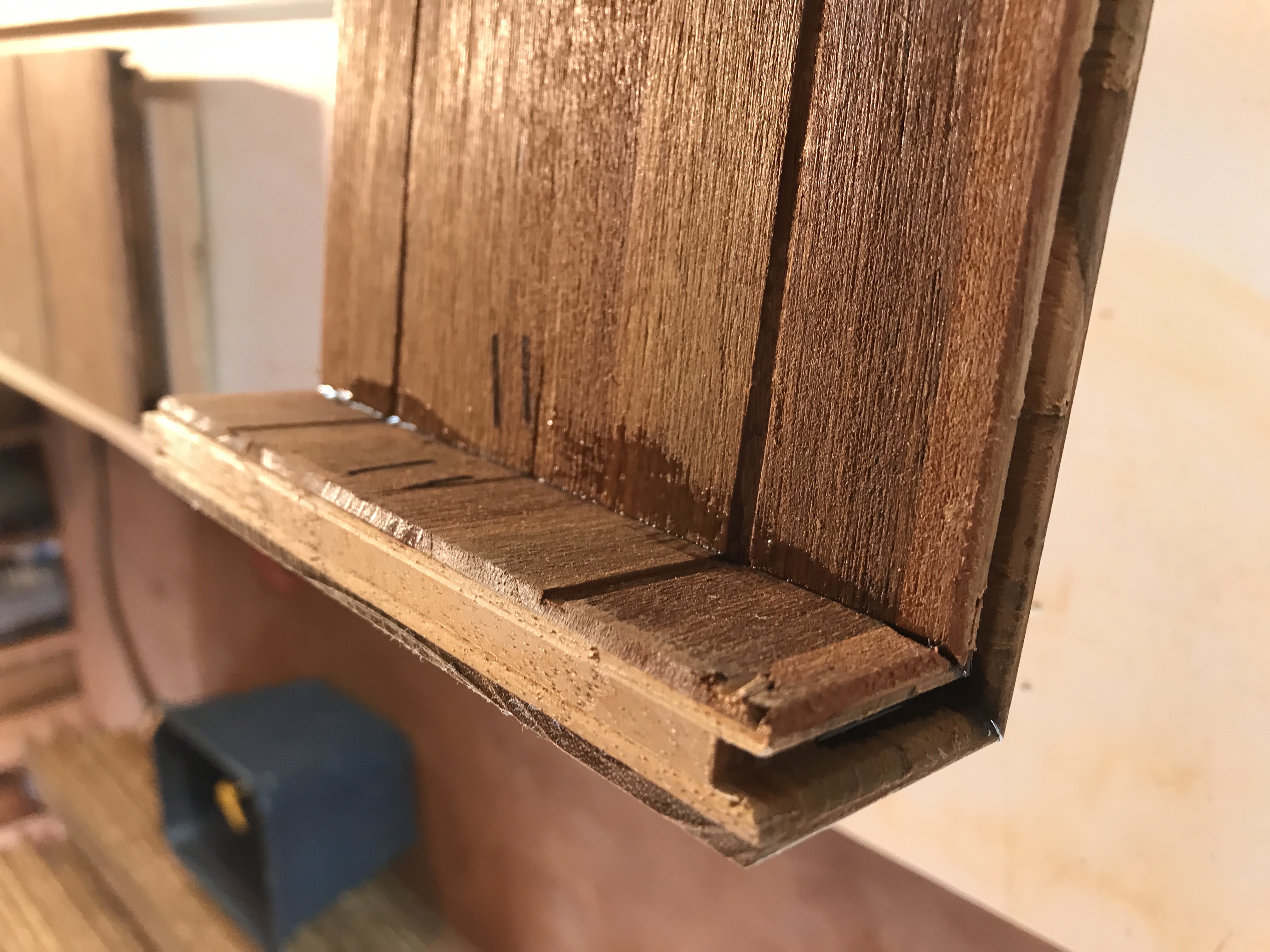

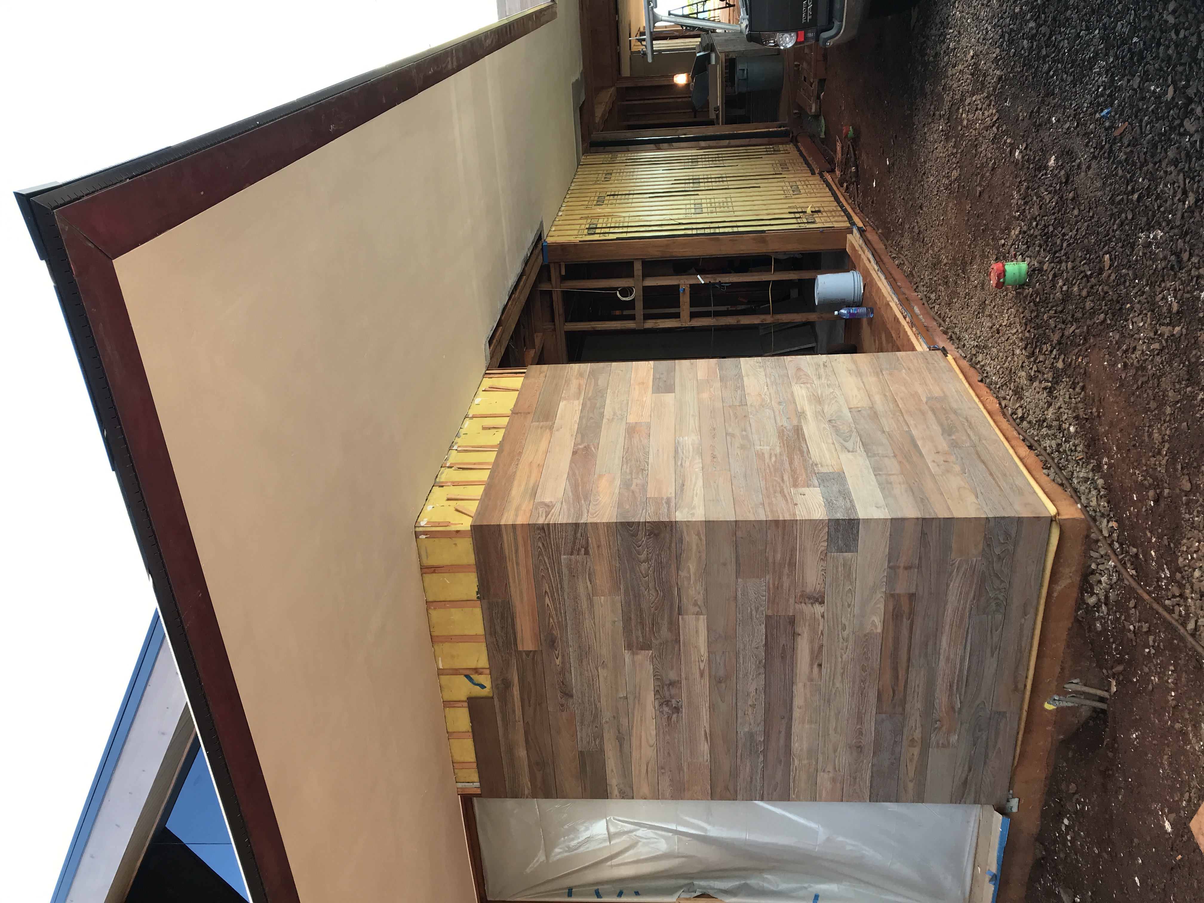

I am managing a job on Kauai where we are installing teak siding . The siding is 9/16” x 5” face t&g from Indoteak. It is an engineered product that uses solid teak as the crossband sub layers. It is prefinished with Rubio monocoat on the face and back sealed with a water base sealer . It is going on top of sheathing that has 3/16” furring strips every 8”.
We are mitering corners and miter returning into window and door jambs. We have a floating 1/8” spline in jamb edges to connect to slotted mitered returns that are 3/4” to 1-1/2” wide.
We are using West System, fast cure with microfiber. We are wiping glue surfaces with Acetone prior to gluing. We are blue taping glued miters and also pin tacking with 23g ss headless pin nails.
We are removing blue tape on miters within 1 hour to wipe off any glue residue with acetone and changing to clean rags frequently.
WONDERING IF WE CAN USE TITEBOND III instead of epoxy. Concidering all install location factors like: 9’ tall walls, deep overhangs, weather that can be sweltering hot to windy/wet and any factors above. West System is bomb proof but it is so time consuming and we need to be careful with not getting glue residue on exposed surfaces.
If we went with TBIII we would still wipe glue surfaces with acetone.
Like to get some solid feedback.

Yes, it’s is work. I don’t want any call backs ,so probably staying with epoxy.

Yes, We are sticking with epoxy . Just thought to ask if there were other options.
We had a learning curve at the start . Guys were not careful with epoxy residue from joints and handling material . So they have to use fine wire brush to rid epoxy from miter joints and surface areas. I will try the green scotch brite attachments for dremel drill.
I will use iso alcohol , acetone is what we been using.

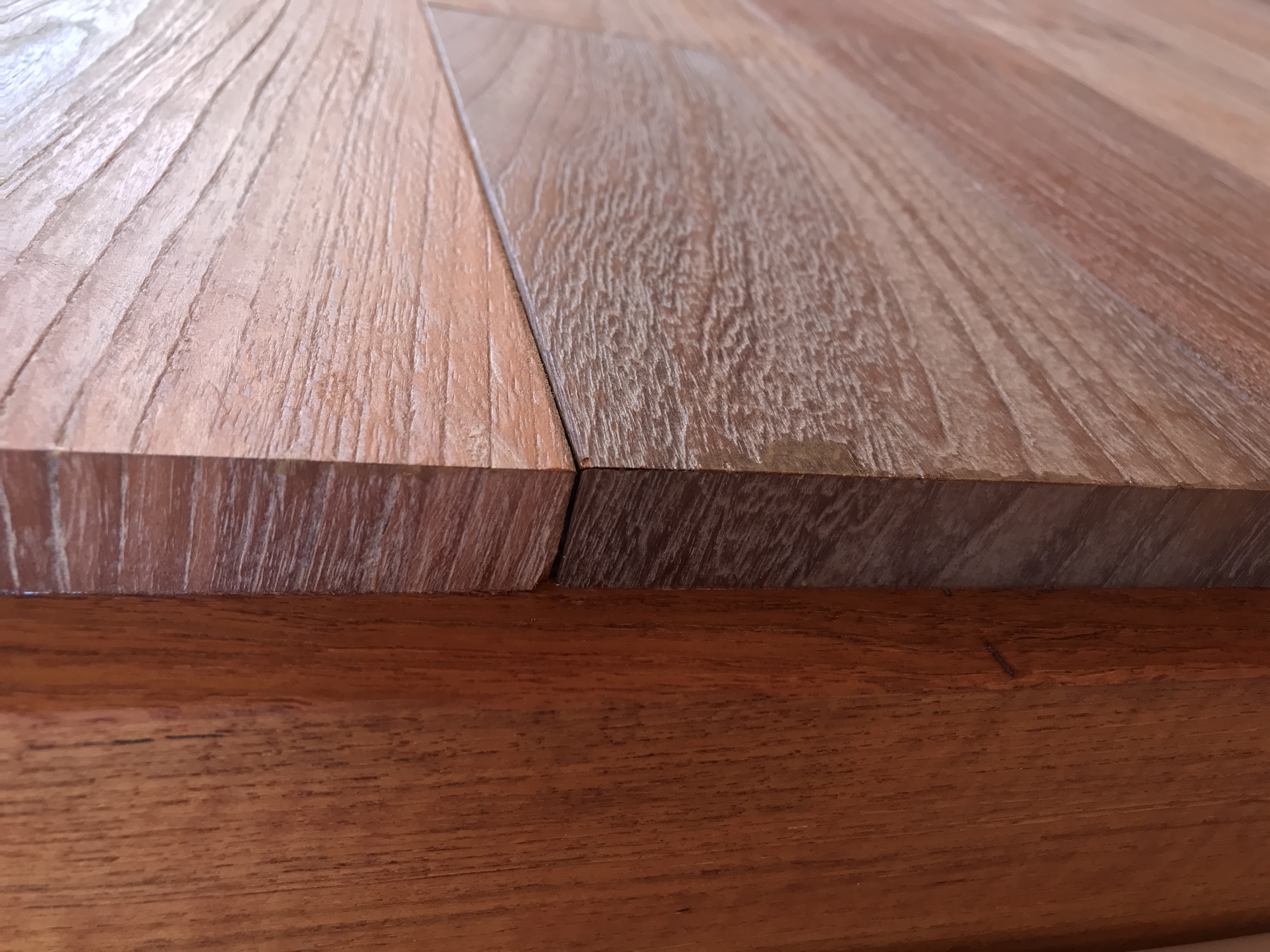

In the second picture, those are all miters? did you biscuit or spline that looks like something that could open up
Those small mitres wouldn't take much to hold the mitres. I used one years ago a two gun cartridge with no mixing especially on site
Expoxy is epoxy you are well covered no much pounding rain.
Just curious do you put a clear coat after and do you caulk the seams

Kevin,
We are staying the course with west system epoxy. All siding is prefinished with Rubio Monocoat from supplier. We backsealed with water based sealer from HD. All walls are furred out 3/16” every 8” for airflow . T&G is glued in with Titebond 3 ( probably switch over to water based clear caulking ) epoxied miters at corners and short returns to doors/windows are pinned with 23g ss to hold position . Stretched blue tape is used as ‘clamp’ at miters.
The most important part through out is wiping, wiping , wiping ….all epoxy residue on visible surfaces with acetone as solvent. Always using clean rags , otherwise dissolved epoxy residue gets spread around more.
No need for mechanical joints like splines etc at miters , boards are nailed off to wall in close proximity to glued miters. We are busting original budget for siding , but I convinced client how it will look awesome when entire house is sided… added another 100k plus . Don’t need to sweat it out so much now. Apologies for not replying ,hope this suffices.
