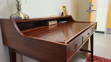

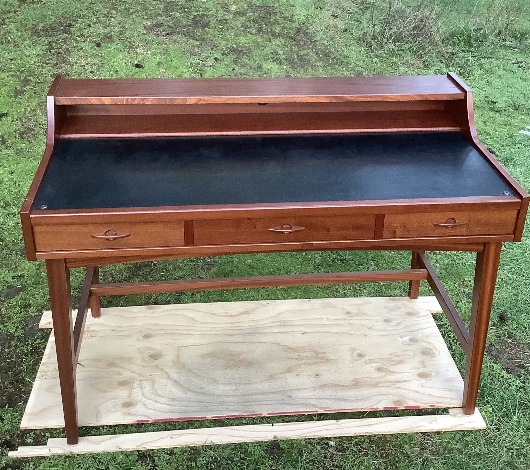

A client asked for a desk top that was reversible, with wood on one side and leather on the opposite side, so that it could be switched from one to the other. I used 1/8 inch sapele on one side, leather on the opposite, with 1/4 inch MDF for a core. I used Titebond III on both surfaces, put it in the vacuum press for 6 hours. It worked fine until the room it was in heated up with the sun streaming onto the desk. Like a potato chip! I’m going to re-do it with 1/8 sapele on both surfaces. Should I use PPR adhesive (which I already have)? Unibond 800 (which I will have to order)? Should I use Baltic birch instead of MDF? Or, I can use 3/8 inch substrate with 1/8 sapele veneer on only one side. I will glue the panel to the 3/4 inch Baltic birch desktop this time, as it no longer needs to be reversible. The panel needs to be 1/2 inch thick to fit.

Sapele both sides. MDF is fine as a substrate. The choice of glue was not the issue in this case it was the unbalanced glue-up. The sapele dried which put tension on one face. The leather has no resistance to the warping forces. 1/8" veneer will impart a fair amount of tension on the panel especially when it is so thin.
You could probably get away with sapele on one side again because you are gluing it onto the table but how good will that gluing be in an already assembled desk? Better safe than sorry.
