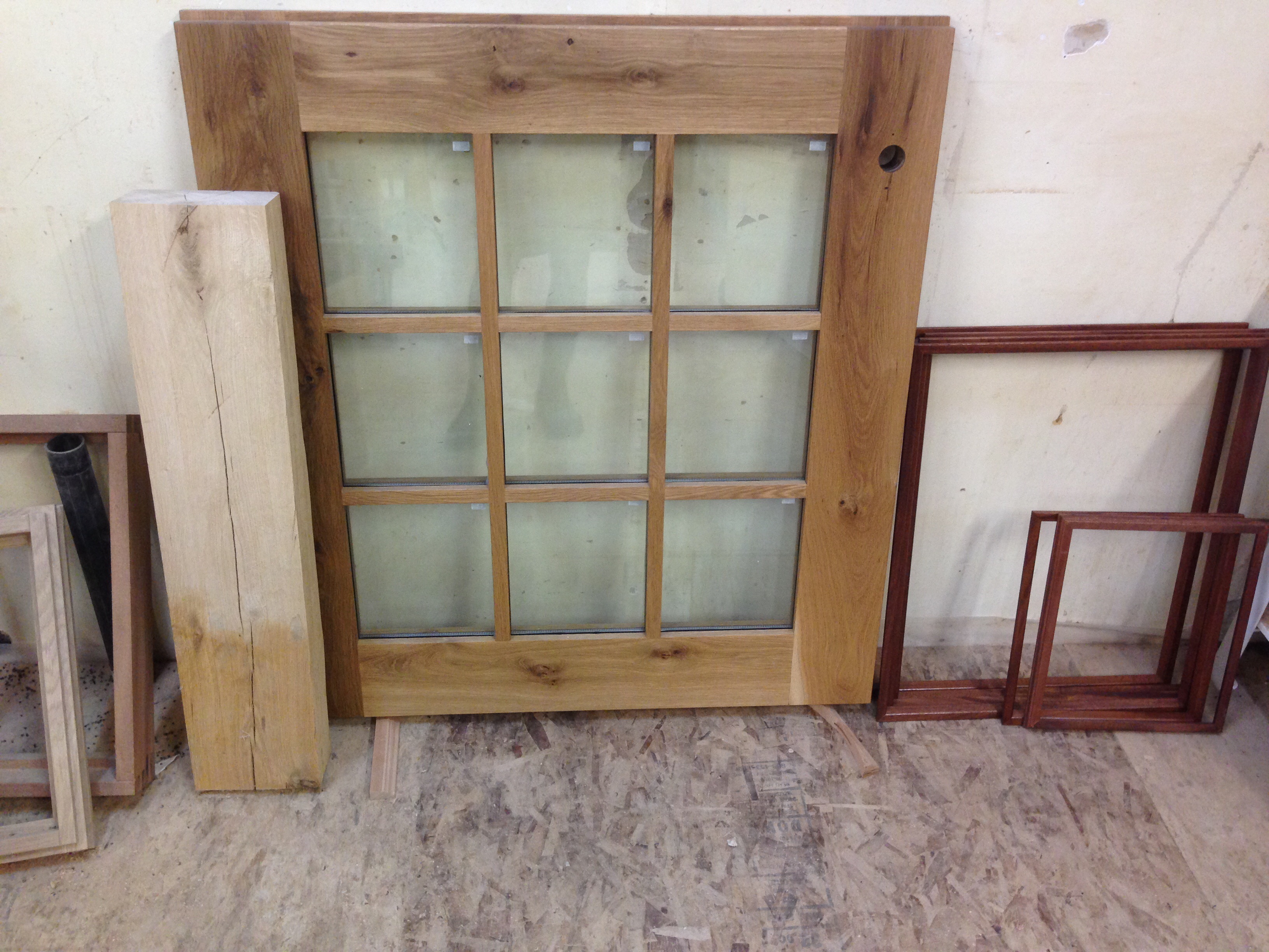

Joe Calhoon
It dries. Here are pictures of his front door with one of the beam cutoffs. As you can see the door wood varies a lot in color with some pieces close to the beam.
After seeing the doors they are ok with it.
I am just wondering now what the timber frame will look like when it ages. Darker I would guess, but I have no experence with natural finished White oak.
I did find a picture of fresh cut white oak and it is very white colored.

B.H. Davis Member
Joe,
I think common logic would confirm your suspicion that the oil is not soaking in. If the wood fibers are saturated with water there is no place for the oil to go. As a result it just sits on the wet surface where on a microscopic level it mixes with moisture, thins out and lightens.
Personally I don't think there is any chance of darkening the wet beams until they dry out somewhat. I suppose you could try a very dark stain but that sort of thing is probably just looking for trouble in the long run. You also might have a little better luck with a water based stain but I've yet to see one that worked as well as an oil stain.

Looks like different oak species for sure. Over 400 kinds of oak, so no surprise. All wood darkens with age, except for walnut. It will darken, but will likely never reach the depth of color in the doors. They almost look closer to red oak to me.

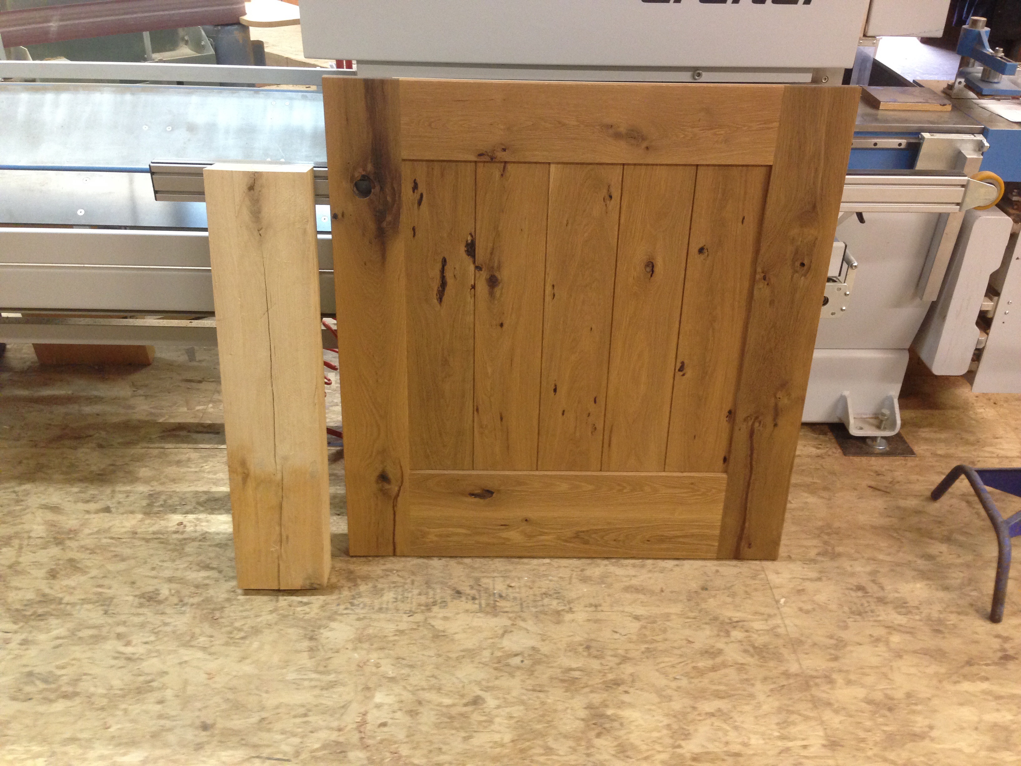

Joe Calhoon
Thanks Gene,
I was hoping you would offer an opinion.
I dropped off some doors at the job site and snapped a phone picture of the beams with T&G rustic oak we milled. I think it is already starting to blend and personally I like the contrast.
