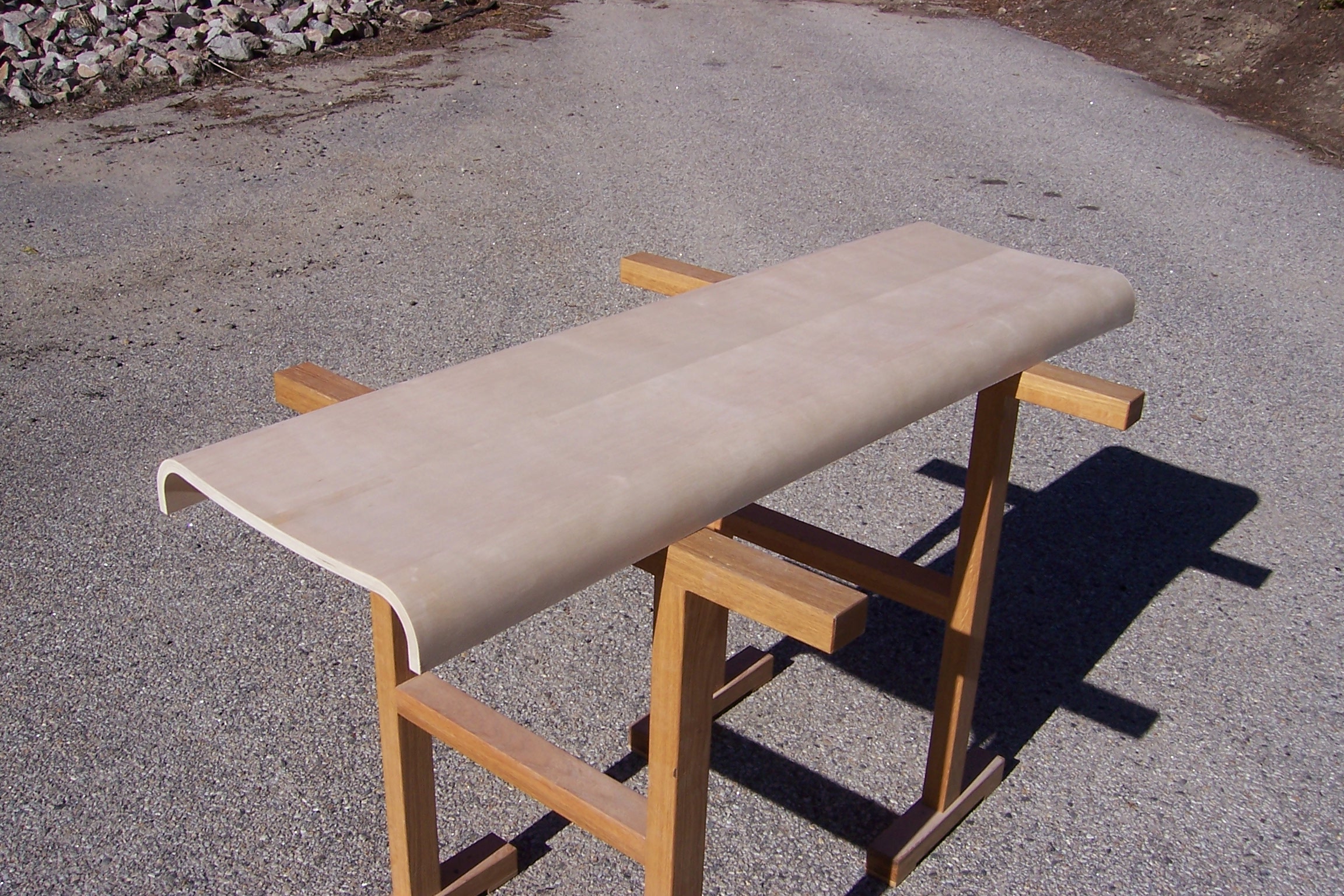

We have a commercial client who is looking for a bench that will be 10' long and the edges need to waterfall 12" on all vertical sides. They want it to be seamless white oak grain running down the length and the seating portion will be convex. The base is going to be a concrete mass and the bench top will essentially cap the base. Questions regarding the top are as follows:
1. Build from mdf / ply and veneer? I am concerned that it just won't hold up in a commercial setting unless we go with a thicker veneer- Which begs the question of where can we find sheets of this length? And also how do we shape the seating...
2. Build out of solid and miter? What to do with the perpendicular grain situation that will occur at 4 locations?

Curved plywood (see picture below, also a bench seat for a commercial application). You could, of course, miter the edges to the curved portion if you wanted a hard corner there.
IMHO, durability is a function of the finish, not of the veneer thickness. If the finish fails the piece will be damaged regardless of the veneer thickness.

The end grain needs to wrap over too? I would strip laminate from solid. Barrel stave construction would let you get a concave seat and roll over on the long sides. But the end will have to be pretty creative. Will they allow a gap where the ends and sides meet? Consider Wendell Castle's lamination work. I would not go cross grain anywhere, just basically glue up another panel. Then miter that to the seat so the grain direction remains constant. You will have to insist on a gap where the rolled ends meet the rolled sides if it where to live without cracking. All changes if you don't have to roll the ends.

Today I talked them into solid stave lamination with no lengths shorter than 4' butted, and working on selling a 1/16" gap at the cross grain connection. What a relief! Thanks guys
