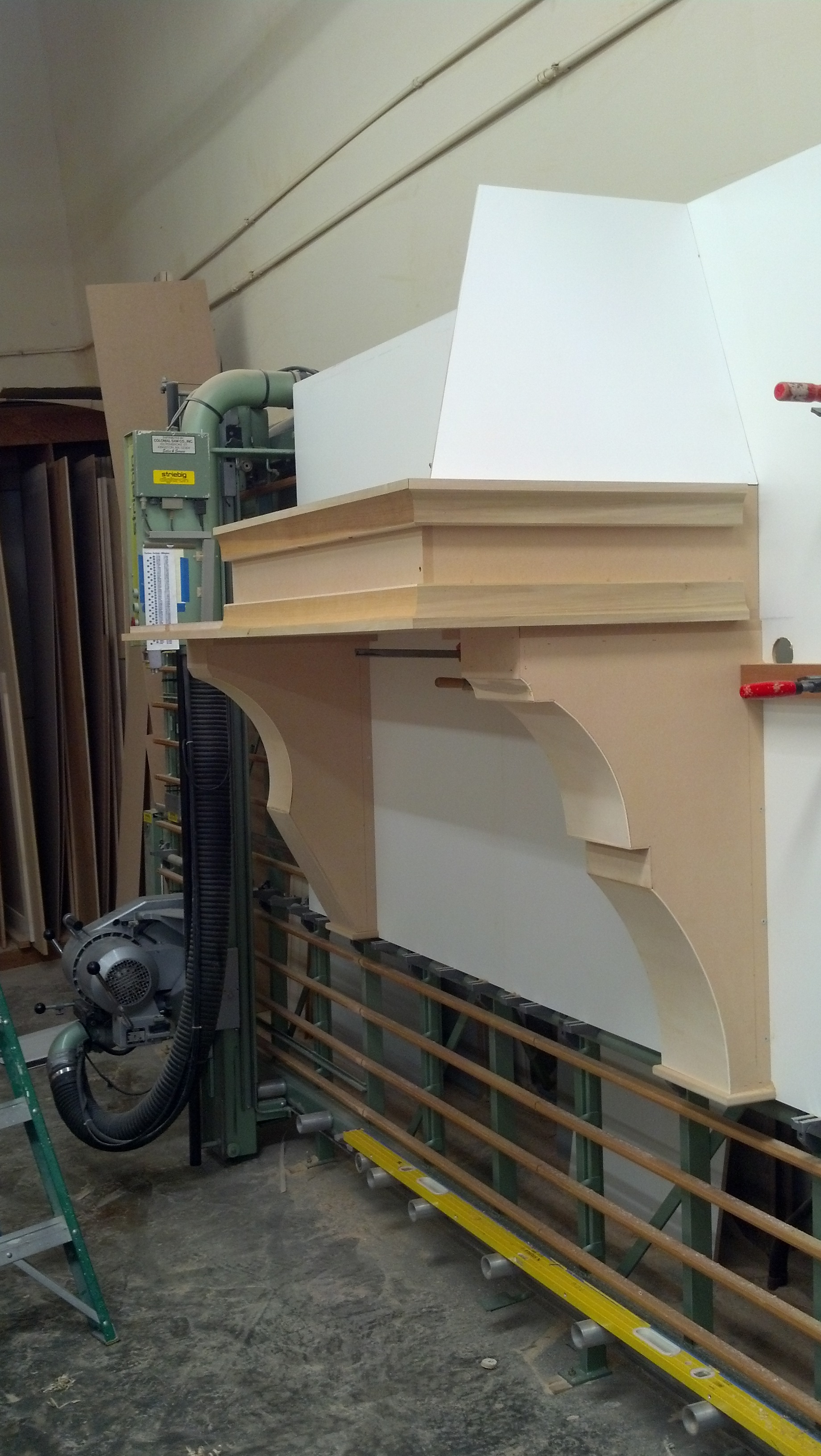

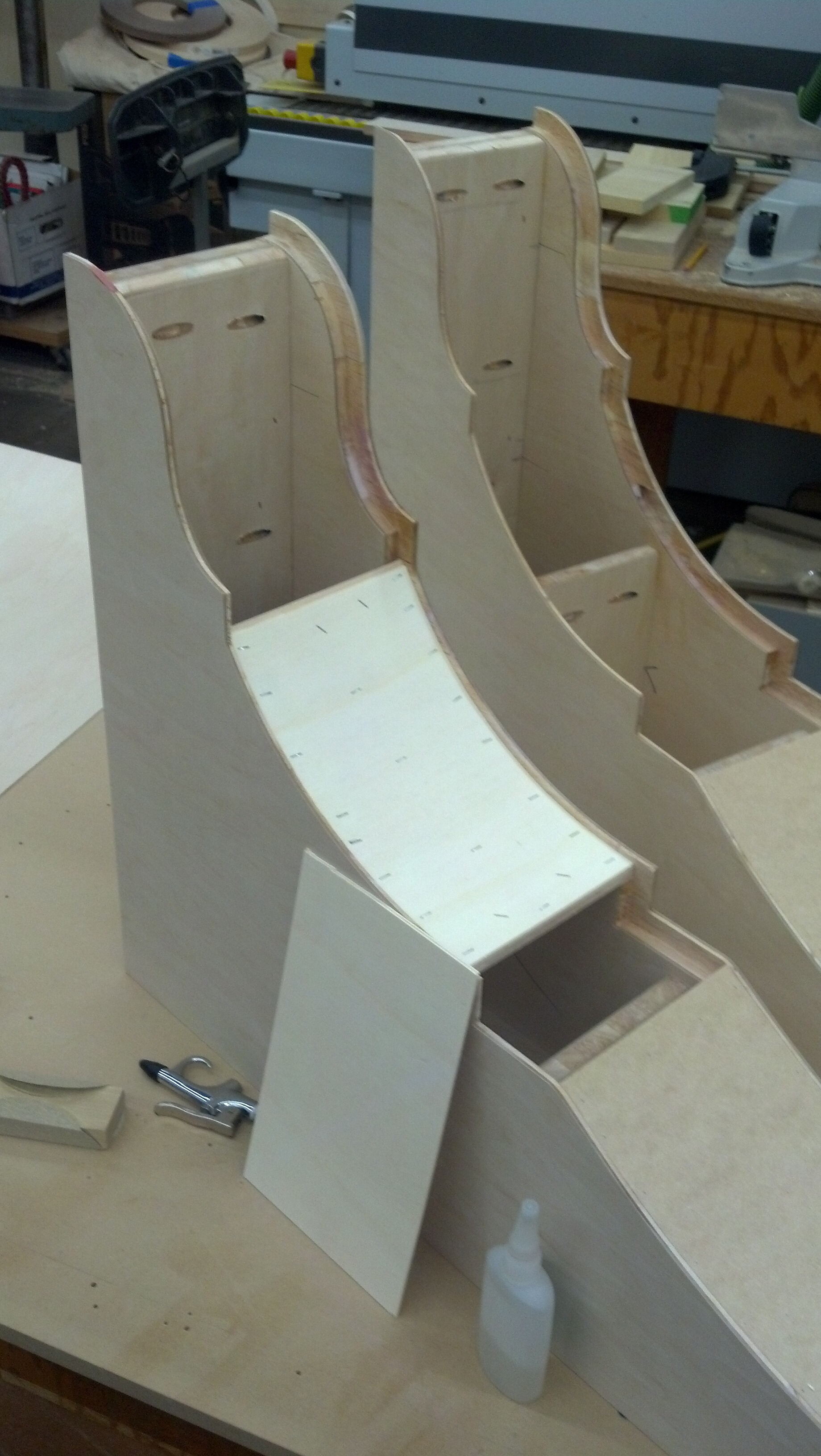

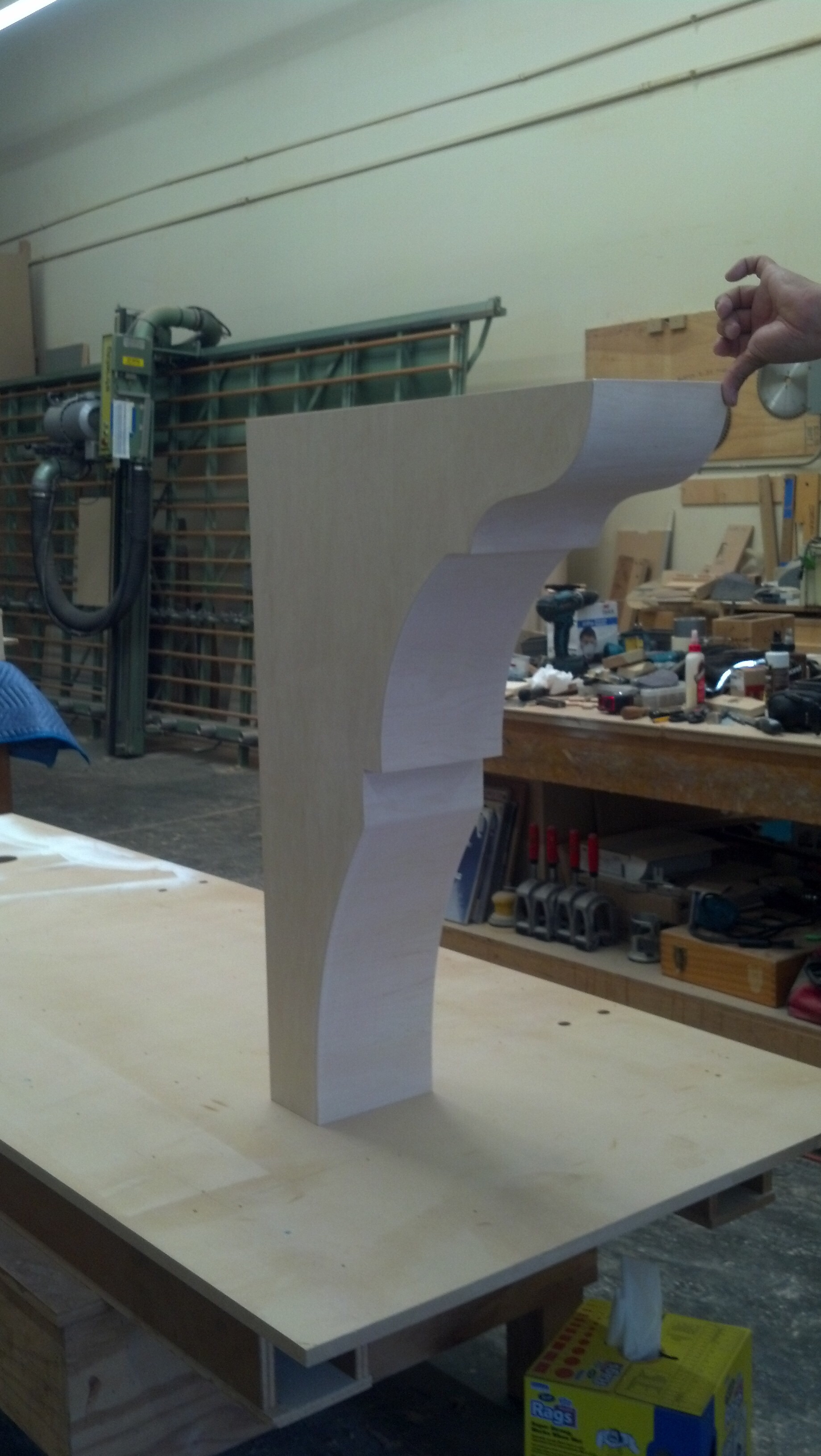

Ended up doing a "hollow" type construction with maple lumber core panels and then psa backed maple veneer for the scalloped face . Came out good but only time will tell if it stays tight over the long haul ??? If I had more time I would vac bag the veneer with hide glue - yes I said hide glue .

Pics of corbel fab
View higher quality, full size image (1840 X 3264)

Great Job M Smith!
Those corbels look fantastic!
