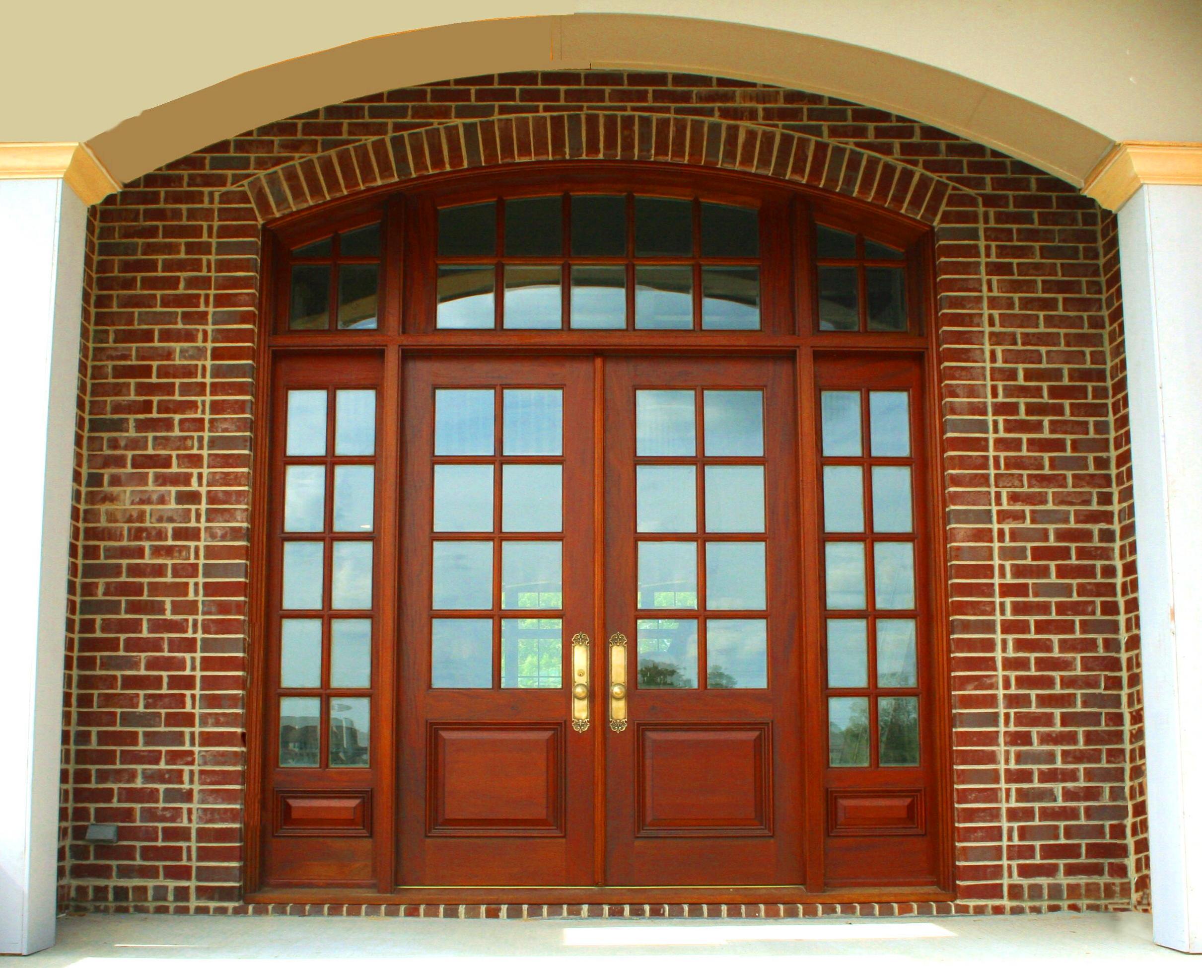

Hardware? The better ones won't let you buy wholesale, you will have to pay retail and try to mark it up, or send your customers to the retail showrooms. If you want to be a dealer, you will have to buy displays, etc.
Then there is weatherstripping and sills. Lots of alternates there, and your market may or may not have its own ideas about what that should be.
Then there is glass. Find a vendor that can do anything at a reasonable price and in good time, with access and willingness to lots of different glass. Know the code and how to work within it.
Finish is another set of issues. A big set.
I have told people that doors are different from almost all other types of woodwork, and that they are much harder and problem prone that any other niche one could find. Not for the casual shop to enter into just because someone asked. Often a potential customer will ask a cabinet shop to make a door after they price one (even off the internet), looking for a cheaper alternative. Just like you get people thinking you can make a kitchen for 30% less than Home depot.
But, beyond all the problems, it is a fair way to make a living.

Just like your cabinet materials, you need to buy wholesale - including your bronze thresholds. Accurate Metal Weatherstrip in NYC is one of my favorites. Buy a quantity for stock and set up terms to get the better pricing. Even then it is expensive - nature of the beast.
Expensive hardware - or paying too much - is the least of your worries. A good argument on hardware can be made about passing it off to the owner, contractor or anyone else. You will never make any money on hardware.
You will need an excellent lumber source, a large joiner and a large planer, fast, accurate and efficient way to mortise and tenon, including coping. Effective glass sealing technology is also very important.
No disrespect intended, but this is a little bit like a bird house builder asking you what he needs to know to start making kitchen cabinets, since he has had a few people ask.
View higher quality, full size image (2421 X 1949)
