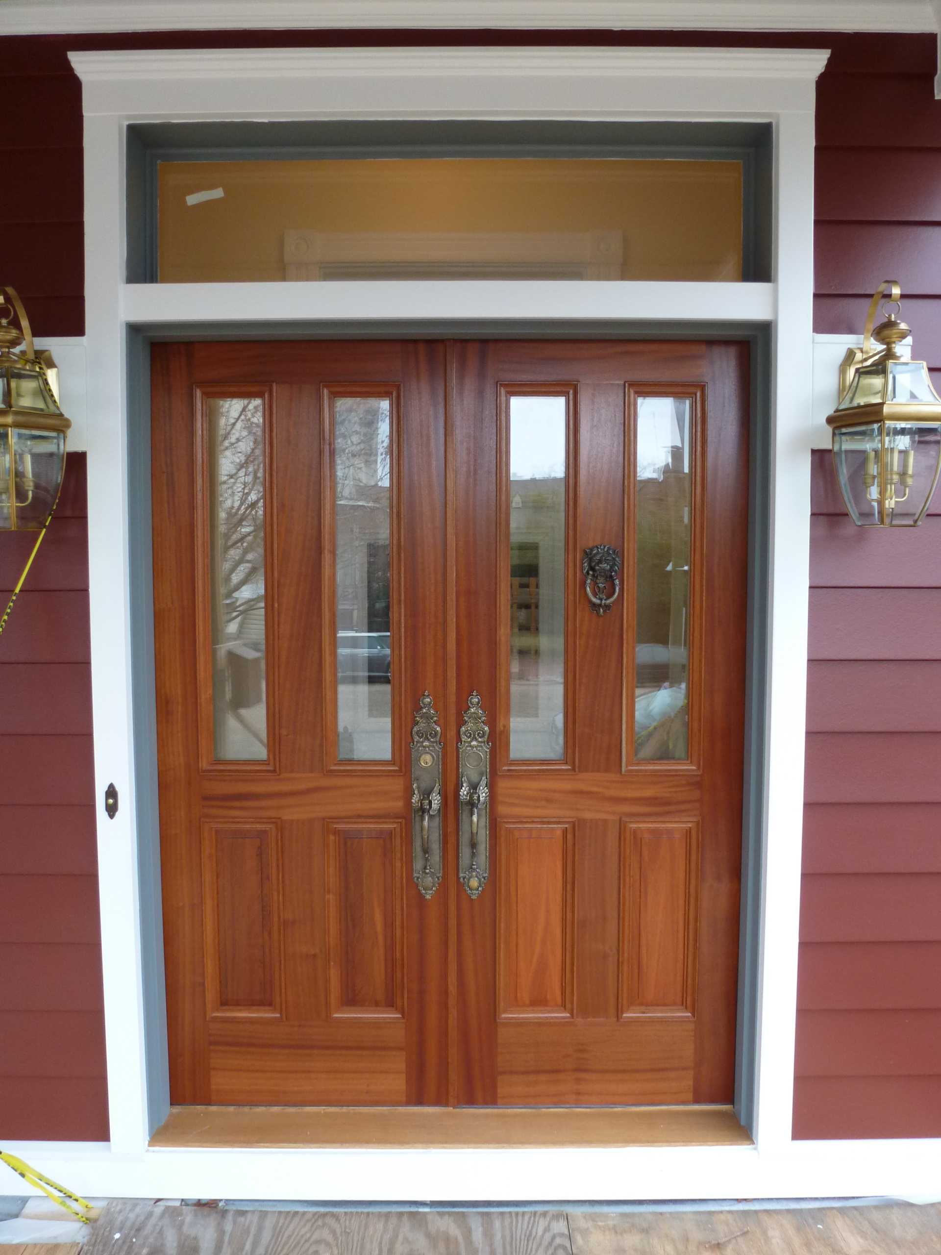

we built this door about a year and a half ago. stave-core construction with 1/8" skins. all components are sapele mahogany. we used titebond 2 and vacuum bagged our parts. stiles and rails have 5.5" dowels to connect them. we have an interior and exterior raised panel with foam in between. all molding is applied. the door operates very smoothly. also, the door is on the side of a covered porch. it gets wind driven rain and a lot of sun.
the owner called us to have us replace the molding on the bottom panels and to epoxy some split panels because they didn't maintain the one coat of epifanes their contractor applied (bad stuff, i know). anyways, we replaced the molding and did our epoxy work yesterday and i just wanted to know how others would treat the potential for water to get behind the molding. obviously, we cannot simply glue it to the panel, but would they be best served to silicone the gap between the molding and panel, and molding and stiles/rails? we did finish the back of the molding this time but were honest in our sales and warranty process about keeping up with the finish to protect the door.
how would you handle this? are situations like these why a lot of door guys don't do finish work on their doors?

I am going to assume that you built these doors with molding stops. So the molding is glued a piece of wood that is independent from the panel. Given that, I would have applied the molding to the outside of the door, put down a bead of caulk and put in the panels.Basically the same as your glass, except that you have insulation and another panel. The panels are narrow enough that seasonal movement will be small.I have done this in the past with small solid wood panels and on bigger panels that were laminated to reduce seasonal movement. I should also mention that sometimes seal the backside of the molding with epoxy after it has been applied to the door.
You obviously know what you are doing and I hope this post is helpful and not insulting to your understanding of millwork

we did as you said and originally glued them to the stiles and rails, but didn't do anything against the panel for fear of preventing it from expanding and contracting. this time around we silicone-d under the molding and instructed the homeowner, who is now doing their own finish work, to silicone around the molding on the outside (where the molding meets the stiles and rails) and to silicone all the way around on the inside (where the panel meets the molding). this should keep any water from getting behind the molding.
do you do finish work on doors you build?

we, essentially, did as you directed with our application of the applied molding. we did not spline the miters and i'm not 100% sure if we applied enough glue to have ample squeeze everywhere the molding touched the stiles/rails (too much time as passed and i directed the build but didn't do much of the physical work). i did mention this to our lead, who built the door, but i know he was/is always concerned with the panel being able to move and feel he would have error-ed on using too little glue. he also brad nailed the molding to the stiles/rails.
i'm not sure i follow you 100% with your caulking application. are you caulking the molding to the panel (at, or near where the two come together), or caulking the molding's rabbet? if not at where the molding meets the panel, do you not worry about water getting between the two and wreaking havoc? i think this is what has caused the damage on our door. again, we haven't run into this situation before (and we've built several doors like this) so i cannot say for sure.
