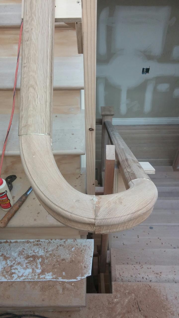

Steve Guenzel

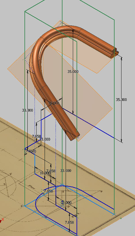

Here's and example of a solid 180 transition also, before finish sanding. I'm happy to try it in solid over laminating.

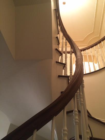

Jim Baldwin
Steve- Very nice 180 and obviously nothing really bendable here, although I’ve seen it done…
Dave’s done it alright, but “gee-whiz Dave,” your non-profiled handrail bend, would be no more than a 4 hour job in solid wood, from start to finish (and without the bending form). Your continuous lam-rail though, is going to be very unique and beautiful. You must admit however, that such bends are almost never practical or possible.
Mike- The day may come when solid curved, handrail segments are as easy and inexpensive to order as regular flat fittings. All you’d have to do is forward your plans to a handrail manufacturer and a multi-million-dollar robot would process your parts and ship them out. Every part would fit perfect and every stick would be custom made. The handrail and joints would be pre-cut and bored for bolts and balusters. Anyway, this is what we’ve been promised at the woodworking machinery shows and probably not an unrealistic potential for CNC. Some spiral stair kit manufacturers have already realized this goal.
When that day comes, only a few die-hards would even consider bending their own handrail. Bending handrail is never going to be easy, inexpensive or even reliable and the fact that bending-rail only bends in a straight line, is also a serious limitation. As an installer, you might have overlooked the actual time and expense of manufacturing bending rail, which is anything but quick and easy. I also think that handrail “strength issues” are more related to poor newel post installations and not necessarily joint weakness. No handrail joints can stay together if the stair posts flop back and forth.

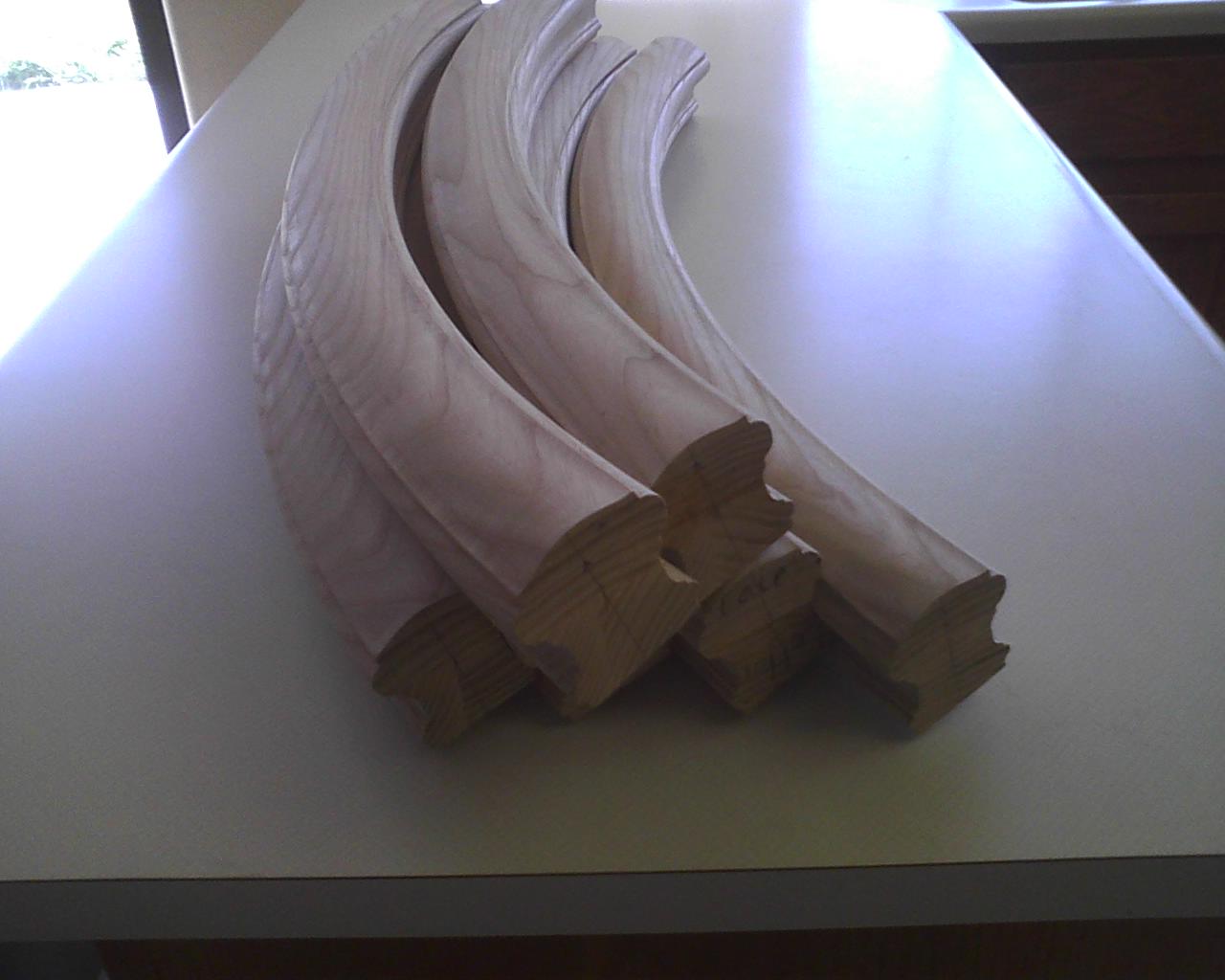

Jim Baldwin
Dan- Very well said and surely an accurate description of the industry today. Educating builders, architects (and stair builders) is essential and something I've taken quite a bit of time trying to do. Sometimes I feel it's all a waste of time though, very few folks today can appreciate or understand that there is any difference or distinction between standard stuff and custom made. Still it's what I do and all I do.
Fortunately I'm not the only one. There are a few guys like yourself who seem to "get it" and do your own thinking and far from the contents of a cardboard box.
Anyway, this isn't about about educating or convincing others of my particular point of view...I'd truly love to hear from 5 axis fans who are busy making it happen. I would prefer the whole truth though and nothing but the truth. I've already been to the show

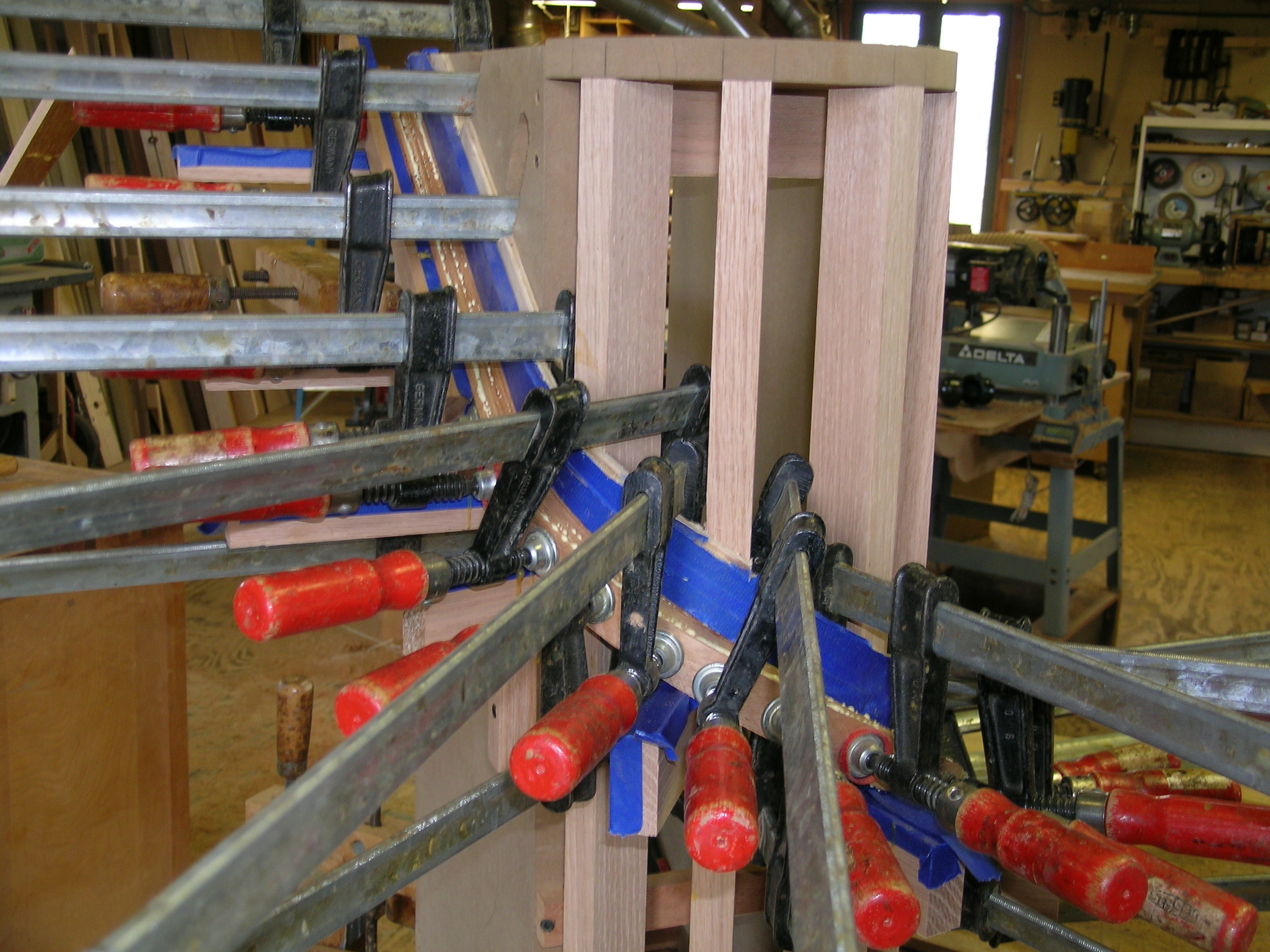

Anyway, bend on this...

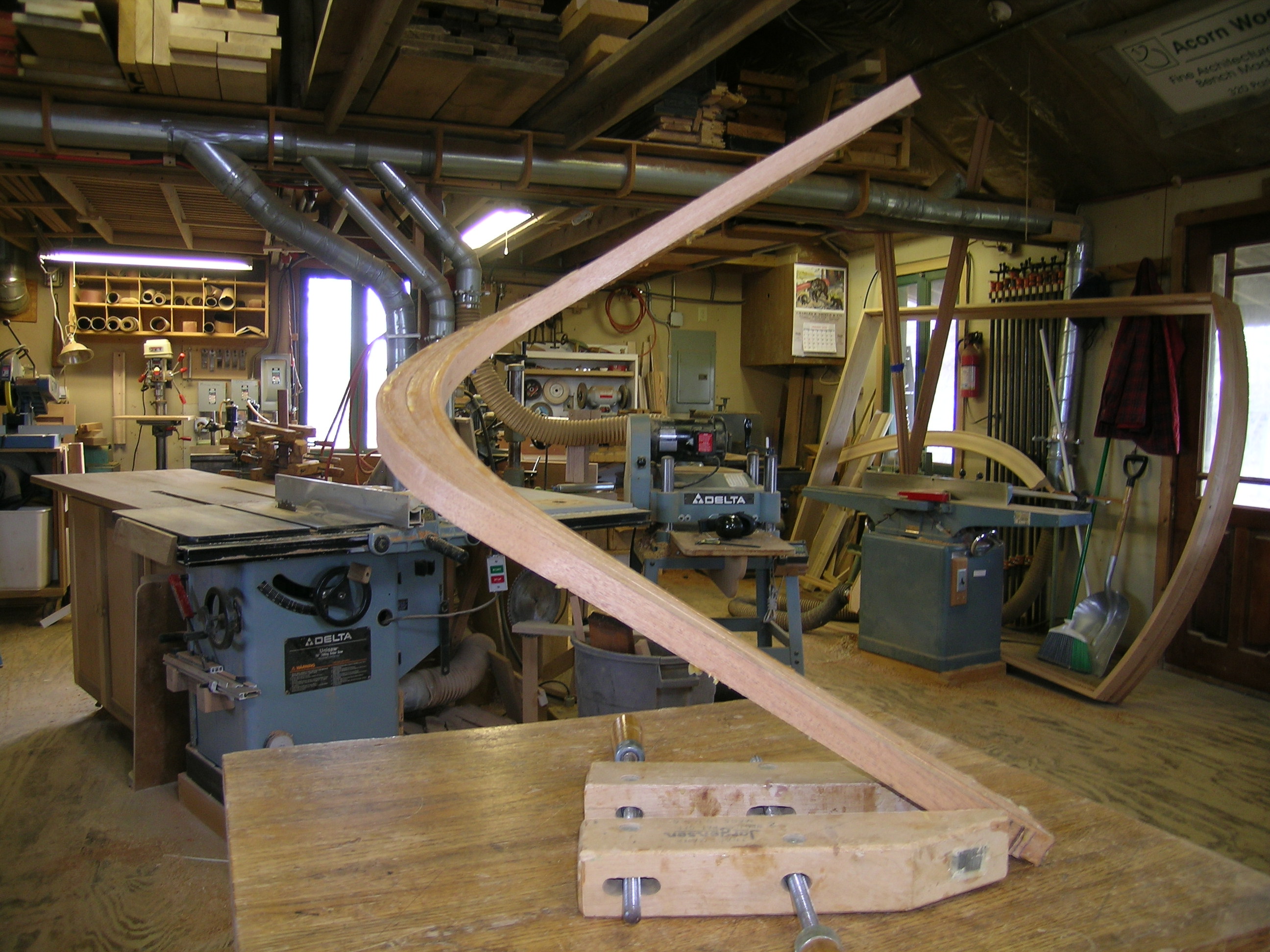

Jim bending rail can be done with slope changes in one piece (sort of) we have experimented with scarping the slope change into the slats and even cubing the rail. I would hate for the day when a $75 - $150 per hour carpenter is replaced by a multimillion dollar machine( I know I don't have that kind of money to put into a bending machine) but that would be the day that an entire house is built by a 3d printer with no out of square walls and all measurements are to the 1/1000's of an inch.

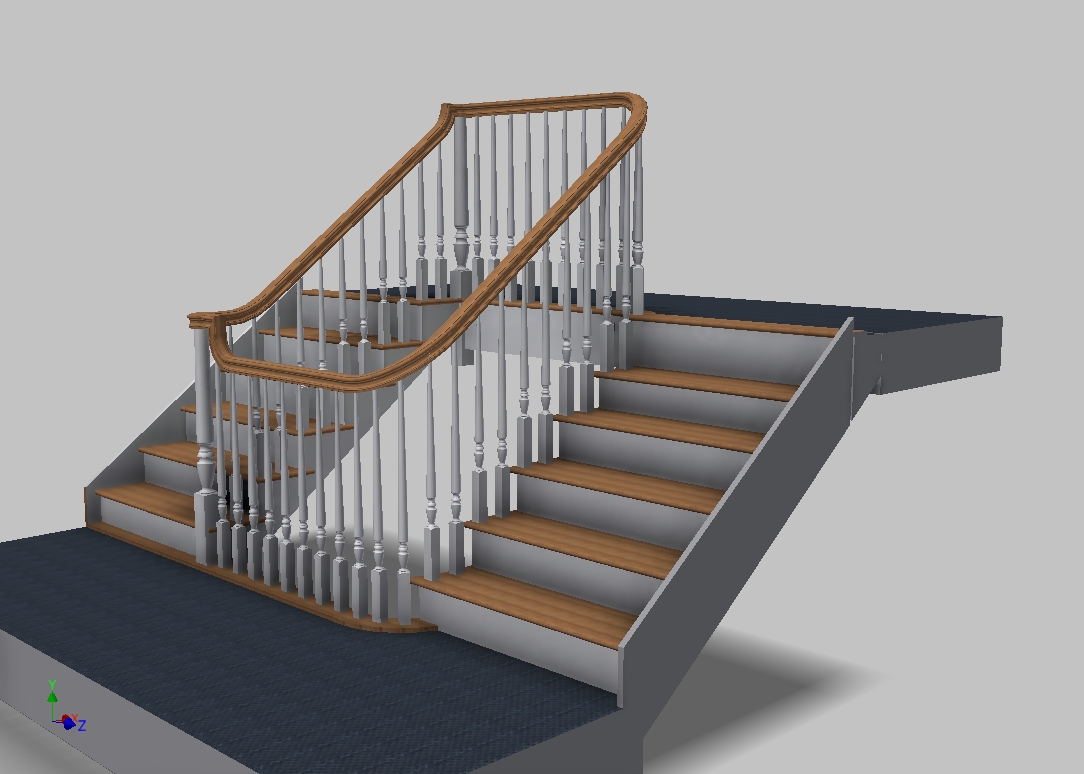

Steve Guenzel
I believe there is a few people out there working on converting old designs and layouts into a modern 3D design and CNC machining environments. CNC machining is just another method, it still takes a lot skills to complete the project.
View higher quality, full size image (958 X 840)
View higher quality, full size image (706 X 848)
View higher quality, full size image (469 X 817)

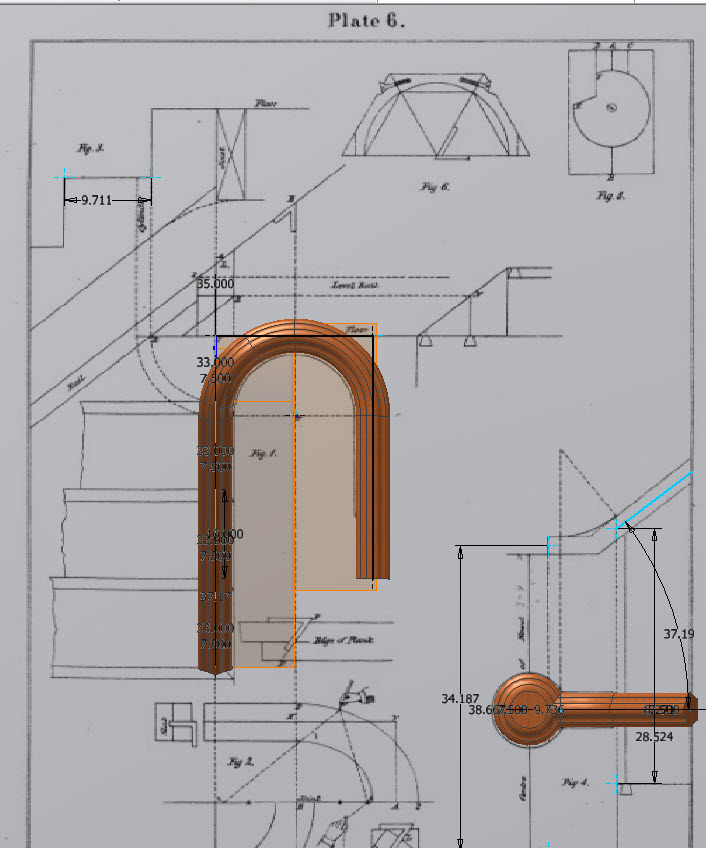

Dan Bloomer  Member
Website: http://www.handrailing.com
Steve,
What is the source of your images? What software to do the 3-D? Is this for rail components you've sourced elsewhere? Your drawing? Whatever the case ---nicely presented.
11/17/14       #29: curved stair handail questions for ...

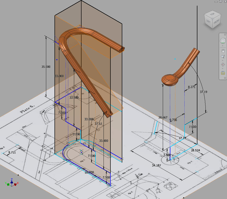

Steve Guenzel
Dan,
I have a pretty good collection of old stairbuilding books, I find I understand Robert Riddells layouts the most,but I do study quite a few different authors. I can take plates from these old books and create a 3D rendering based on the layout. I choose a handrail profile I like and think might have been used. I use Autodesk Inventor software for all my drawings and then they are used for CNC programming. So if my drawings work , my parts should also work in theory. But I am still learning and practicing on daily basis.... You can see a bunch of my stuff on Linked In.
View higher quality, full size image (944 X 785)
View higher quality, full size image (1084 X 774)

Jim Baldwin
Wonderful drawings as usual Steve and your finished products as well. I guess nobody told you that it's impossible to make wreathed handrail parts on 3 axis machines?

The thinking of CNC to most people is to throw a router bit profiled to a handrail pattern into the machine and let the chips fly.
In many generic cases, that may work, but to use CNC or robotic technology At the next level, profiled cutters will never create the detail that ball or end mill cutters can create. For my budget, carving and handwork is still the answer.
I used to rough out constant solid radius handrail on a table saw, and then profile the blanks. It can be done if you place the spring boards on your blanks and use them basically as a pilot bearings to run over a dado blade at the proper angle.
That probably doesn't make much sense, I can make it better then I can splain it.
