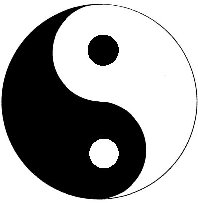

How would you go about building this?

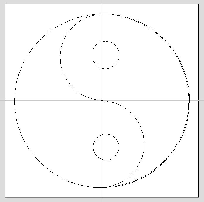

the outer circle is a given, start with your "Back" as a template and either dado the "S" into it or build it separate with a form. I would use either 2 layers of 3/8ths "wiggle wood" (Benda ply) or .125 bending luan laid up in layers.
If you build the "S" up separate then make it a tad long so you can scribe the union nice and tight. looks complex but it is just radius work

Kerf- core , is much better than wacky wood or bending Luan

That crazy Internet thing has many articles about this, calling it a cardboard DIY project. I would suggest it is neither DIY, nor should it be made of cardboard.
Basic woodworking materials are available to the professional. Beyond that there is a bit of drawing, first to scale, then full size. All very much within the scope of a professional woodworker.
