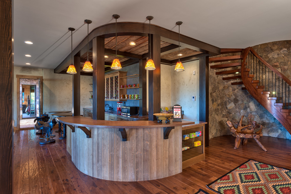

Hey guys, so we have this kitchen island to do for a client that calls for a tight curve. They want it to look like rustic siding. Im thiking an american walnut barn type siding. Im thinking we would buy this as t & g reclaimed lumber but whats some good ways to get these to make a curve. Take a look at this pic i snagged off a website. Its kind of like this curve here.

The base looks segmented plank from the photo. at a 44" plus radius this will look cool. if you have to do say 18 or below you may have to plane down the non visible back and pray it will bend

I can't tell if that photo is of a residential or a commercial location... Nice stairs, but the bar, eeek: I wouldn't be looking for inspiration there. At any rate, the T&G won't help you any with curved work.

mark i have no idea where this place is or what it is,,, i only used it because it shows a 'curved island' that had some form of vertical planks going around it which is kind of what the client asked for. Maybe what i am seeing in this pic is not t & g , probably a 1/4" thick ready-made paneling. But it does have that t & g 'look' which is what the client is looking for. So like i mentioned before.........looking for suggestions here to get it done.
