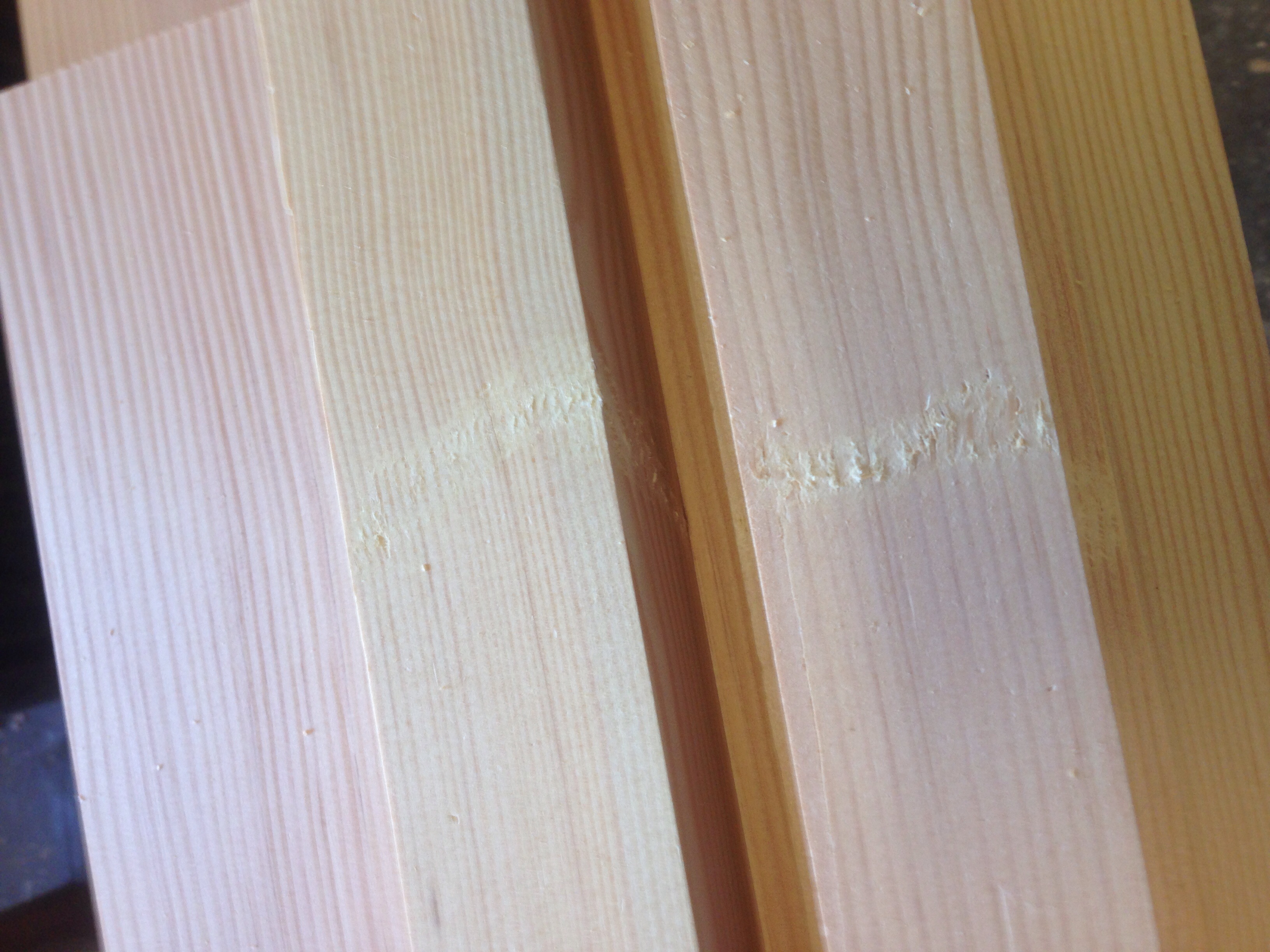

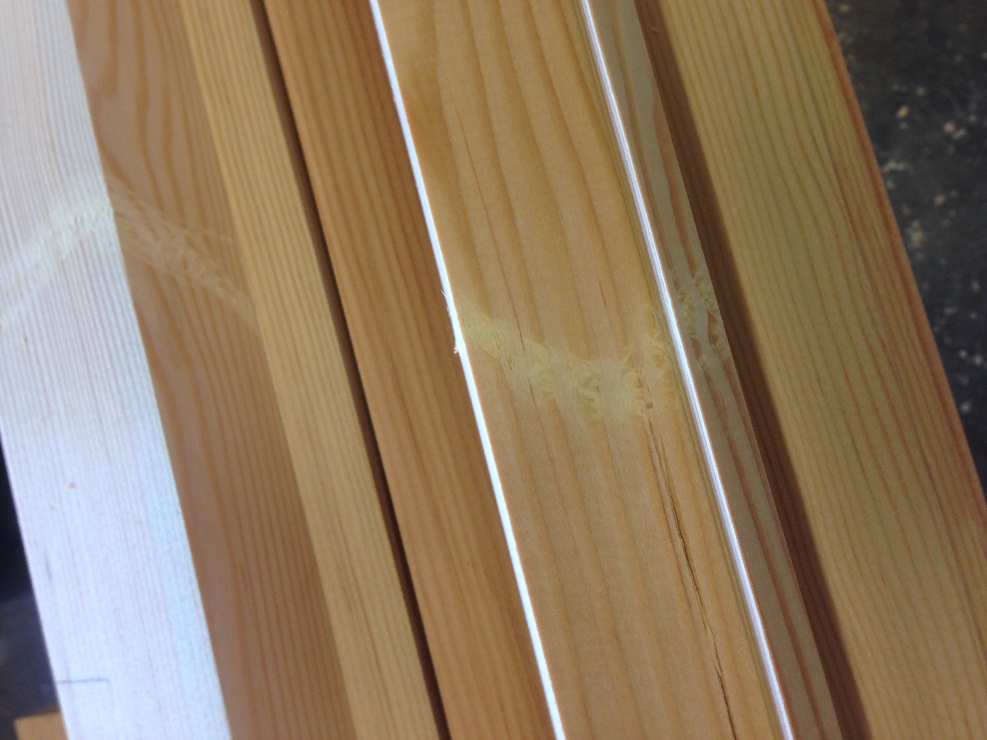

After I ran this stock through the moulder this scratch appeared. I tried to sand it out but it wouldn't go away. I ripped through it on the table saw to discover it is completely through the wood. It doesn't appear to be a structural concern (although I won't be using it anyway) just wondering what happened. Thanks

Looks more like a glue joint than a scratch :}

Turns out its a fracture from when the log fell hard on the ground. Fall mark they call it.
