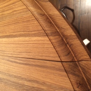

we built a wood top for a semi-local client of ours a little more than a year ago. the wood, white oak, came in heavy and seemly wet but our promised deadline had us build the top from it regardless (and i really knew better but figured we would be okay). anyways, i just got this picture from the homeowner. obviously, we need to make a repair.
i'm thinking about running a circular saw blade into the broken joint and adding a solid piece to fill the void left by the saw kerf. sand and reshape the edge profile. recoat with mineral oil. i'm planning my attack in the spring. this is a quick explanation so please don't make too many assumptions regarding my quality. we do work for other cabinet shops and our quality is always noticed.
do you think it will work?

I've been there. Your repair idea is sound - I use epoxy to glue the wood in place, but tape off the surrounding area real close to the cut. Better yet, tape it and then cut. The epoxy does not require pressure to bond.
One problem we have found is that the mineral oil is along that crack, and down in the wood by 1/16" or so. You can't get away from it, so the glue does not want to bond on that upper edge, no matter what. We are considering giving up on these tops since they seem to be prone to developing problems.
What is the RH of the house? Spekva calls for a minimum of 40% RH. That will grow mold in my area. I bet it is under 25%
You may be better off waiting until late Summer to do this - let it move back/close up a bit. If you fill it while shrunk (today), then when it expands again (summer), it may split since it cannot move back into the previous - now filled - space.

Almost looks like another crack started just above the major one. If there are a couple of cracks, almost better to start over.

One repair I learned was to do the main repair from below. Either epoxy as david said or drill and install several dowels along the center crack line from below to within 3/16 of the top surface. This repair will provide the stability. Then use a product like a Mohawk colored burn-in stick or kneaded epoxy from the top to repair the surface. Seems like the less you disturb the top surface the more likely you will have an inconspicuous repair. I have seen some incredible repairs and the grain of oak should be more forgiving.

thanks for the replies. we've done a few hundred tops and this is the only one we've had problems with. in november, we found out that the homeowners hadn't been oiling the top (it was installed 2/14) so i'm not 100% sure who is to blame but i've signed up for the fix.
david - thanks for the reminder with the oil. i know this and have instructed her to lay off the oil in this area until we make the repair. i would guess the epoxy might stick to itself and fill the void at the top (even though it wouldn't be holding the wood together)? also, this is an edge grain top so the width of the boards is expanding more in thickness than in width. i may still wait until summer but i think we would be okay to make the repair in the spring. house is in north carolina.

White oak does do that.
I've had the best luck by ripping the crack and edge gluing the two pieces. This is the only 90% + successful solution that I've found. Yes you lose 1/8".
On short cracks a biscuit made of the same wood species at 90° to the crack has worked as well for square of rectangle tops in 70% + of the cases. I have not tried this on a round top. The real fear is that another crack may open up. it's the nature of the beast..

Rip along the crack joint the edges and re-glue. You may have to reduce the radius a fraction and run the edge again but that is pretty simple. With that said:
I had a similar experience years ago making a table top from a heart pine beam I re sawed. It buckled after a few months. I acclimated the boards properly this time and made the customer a new top without question. They were also able to continue to use their table without interruption.
Like you, I screwed up, not the customer...
You should make them a new one.

Both cracks are on glue lines. I would question your glue-up process. The glue line should be stronger than the surrounding wood.
I second the motion to rip the panel, joints and reglue.
Another note; I don't consider mineral oil a wood finish. According to Bruce Hoadley it provides no moisture resistance and just collects dust and grime. Danish oil is marginally better - it at least has some varnish in it.

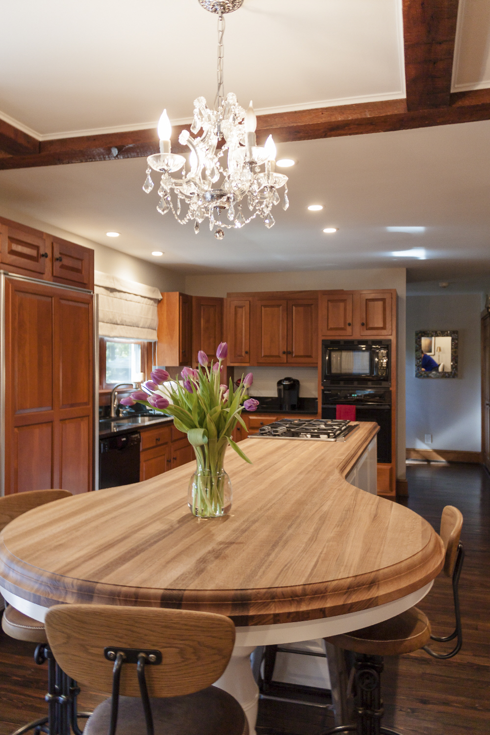

thanks again everybody. the picture i have of the entire job is too large for woodweb but you're looking at a small part of a 160" x 48" x 2.25" countertop. it has a gas range at one end. aside from its size and the cooktop - i'd love to be able to "do it right" and bring it back to the shop.
tom - i'm really not sure the difference from being right in the glue line and very, very close to it (indistinguishable without powered magnification) . our prep was the same for all joints and all of the material was run at the same time. it is an edge grain top so the glue surfaces were planed, then ripped and stood on end. i would think we'd have problems everywhere if we inadequately/incorrectly prepared the surfaces. and experience and validation by hundreds of other jobs leads me to believe this is not the culprit.
with food safe mineral oil, yes, i agree, a very poor "finish". easy to refresh and fda approved for food contact are the main reasons we use it (when requested). i'm pretty sure danish oil isn't fda approved and in our litigation-happy world - can you really risk your business by going with a unapproved product (referring to direct food contact finishes only)?

The image shows a crack right next to a glue joint. Possibly a result of PVA glue moisture and the repair was a spline set in with a biscuit joiner and clamped worked ok and I may have an image of the completed top as well.

When I had a glue line open (on air dried white oak coincidentally) it was due to over tightening the clamp on the end of a table top. I likely starved the glue line and the stress associated with differential drying of wood between exposed end grain and towards the core caused the failure. I have returned to the old school technique of springing my glue joint on solid glue-ups of any significant size. Extra down pressure on the wood midway through edge truing easing off at ends. Keep your jointer super sharp. I resist the temptation to just glue it and squeeze it if there is resistance to the joint to coming together in a dry fit.
That said, an on site hand-planed wedge and Titebond II after swabbing the joint liberally with rubbing alcohol or acetone to remove oil would do the trick.

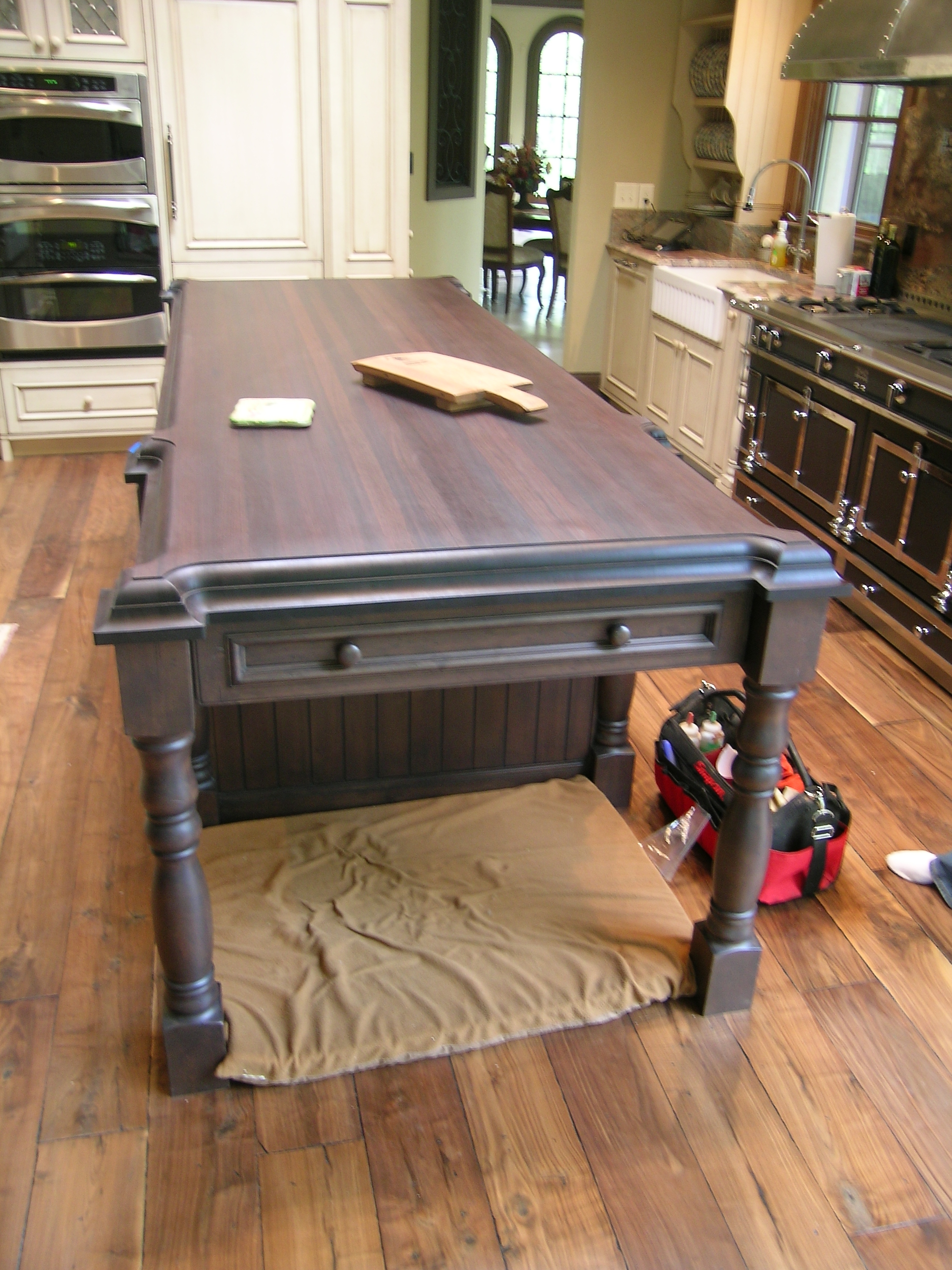

the google
jim,
thanks for the kind words. we've had plenty of success with large glue ups as a lot has to do with installation. again, this is our only failure out of a few hundred and the only one that "could" be our fault. i haven't checked the installation and the homeowner already admitted not oiling the top for 6-8 months.
what do you mean by "butcher block"? i'm familiar with the term but it is often misused or used in place of wood countertop. this is an edge grain top (as stated above) so the majority of the expansion/contraction will take place in thickness, since the pieces have been turned on edge. we've done plank constructed tops at much larger widths (93" is our widest to date) without issue.
i'd prefer to keep this less about what a dummy i am and focus to technical merits of my proposed fix. i'm married so i'm well aware of my shortcomings!

View higher quality, full size image (999 X 1498)

I wanted to comment about how fantastic your countertops look. i can see why you've made so many of them...I'll take two. The glue-ups truly are ambitious but that's what make these so special. Wood is good no matter how you slice it and you're cutting no corners that I can see. I love your work and apologize for critical comments. You obviously know your stuff.

First of all, its a beautiful top!
