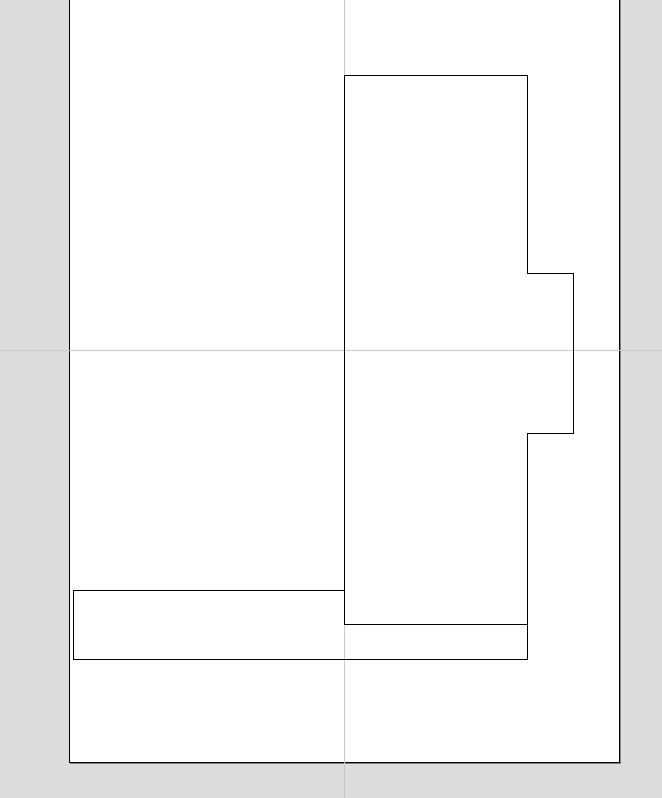

james mcgrew Member
Frames are Generally painted to match and wood overlay (Casing) goes to the inside perimeter edge.
If you were to return into the case it would effect the door stop on a metal case
