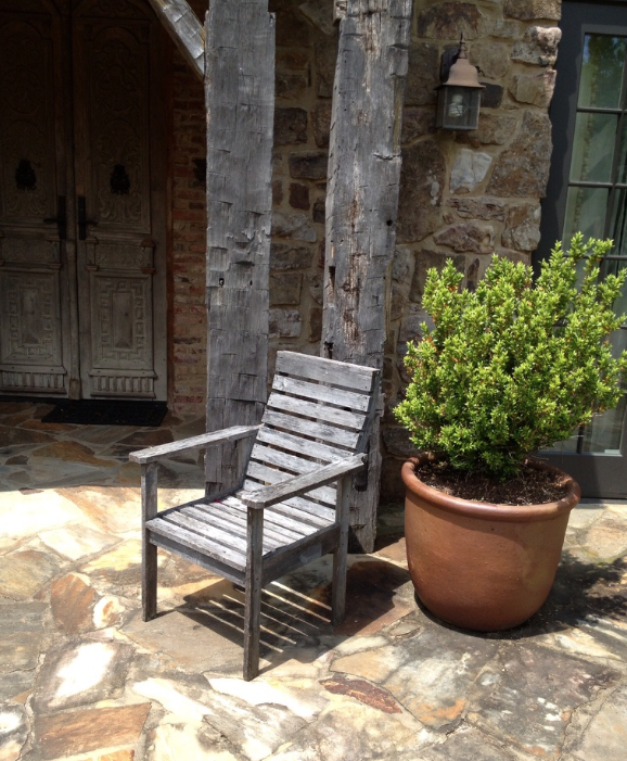

ABMWOOD Member
Website: http://www.abmwood.com
If you've never worked with antique yellow poplar, you would think I am crazy, as fresh cut poplar would quickly rot. However, I have two armchairs made from antique poplar barn siding. They have been exposed to all outside elements for 7-8 years and no protective finish of any nature has been applied. The wood is light in weight and very easy to cut and shape.
View higher quality, full size image (578 X 701)
