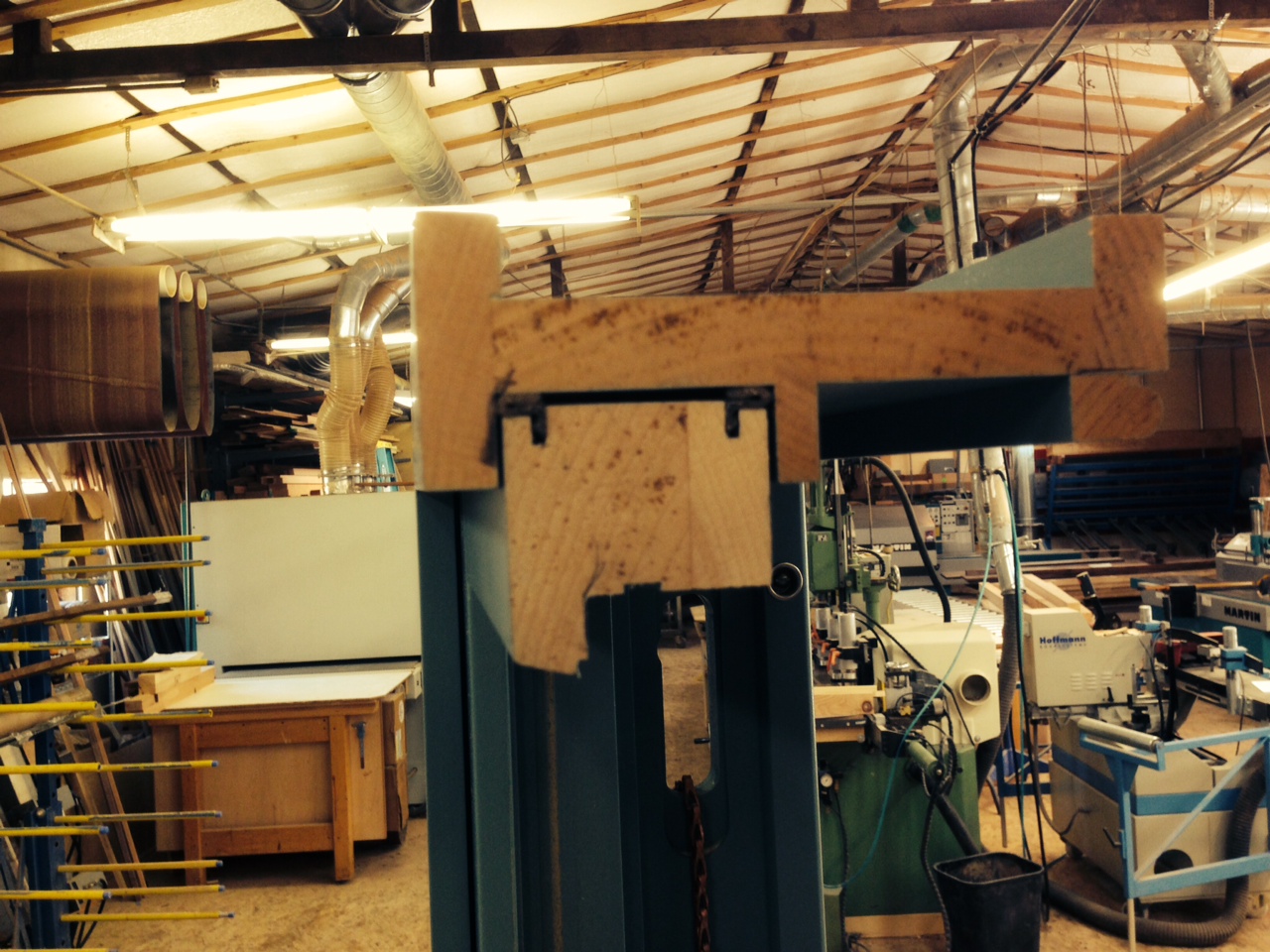

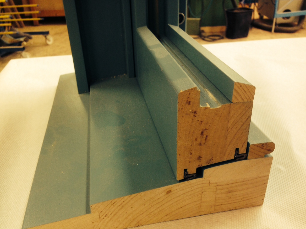

Joe Calhoon
Here is how we build DH. The pine section sample is not how we laminate. It was built from scraps.
Weights are expensive but you can make your own from bar or round stock. Save the old ones.
I prefer weighted but the one disadvantage to weight pockets is the heat loss. If you have enough room a foam insulation can be added to the outside lining. Usually not enough room in old 2X4 walls though.
Joe

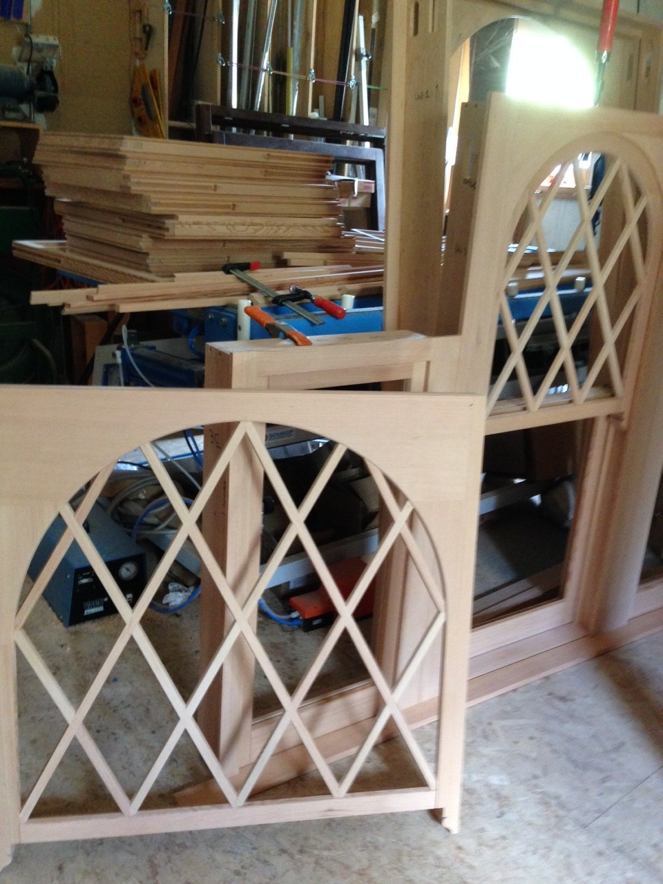

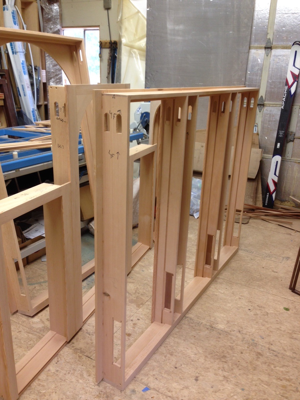

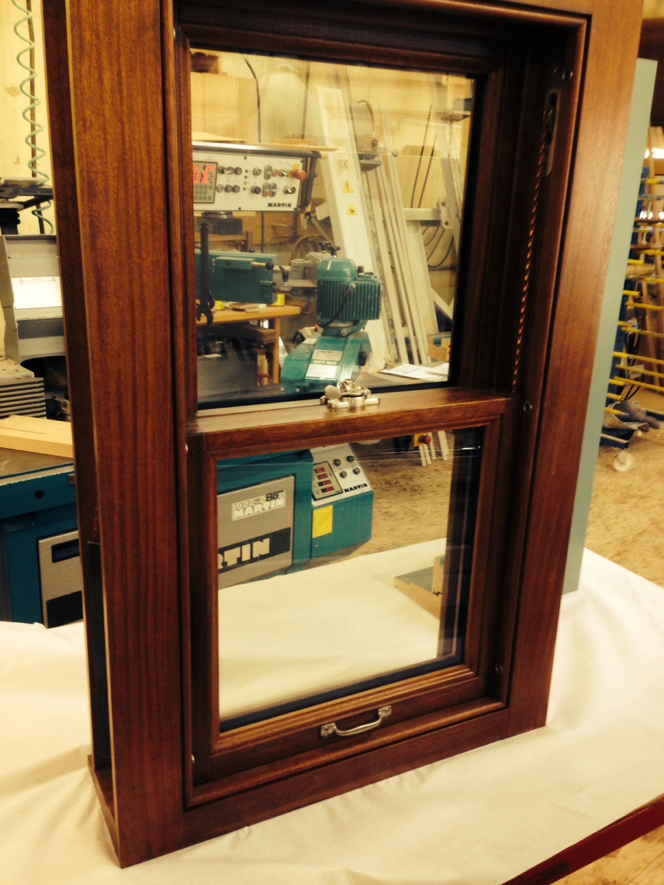

Joe Calhoon
More pictures.
The frame is the labor intensive part of building double hung but a good system of S4S and moulded parts will cut down on time.
