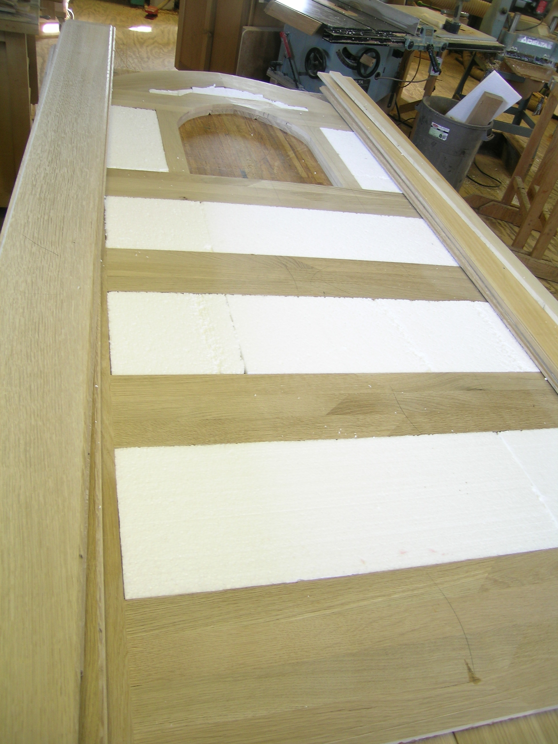

We have made many doors with a method similar to what GW describes. You can search Woodweb for discussions of 'ladder core' doors and plank doors.
We make a 3/4" center core that is mortise and tenon stiles and rails, with several cross rails. Hence the term ladder core, since it looks a bit like a ladder. We then can add 3/4" planks that are T&G v-grooved to each face of the core. Rigid foam is used to fill the voids in the core.
In your case, I would run 2-3 vertical rails between the stiles so it will not look like a ladder, but the meat is still there to fasten your faces to.
As for dealing with wood movement in the faces, a v-joint T&G will have a bit of 'crush zone' in it along the edges. Keep the planks narrow, and leave about .040" between the planks at the joint. The idea is to let each board move in its own place, like flooring. They should be glued to the ladder core. We like a vacuum bag for this.

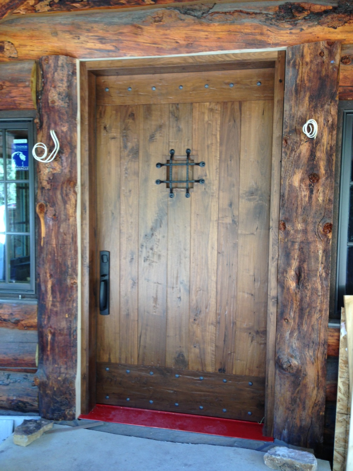

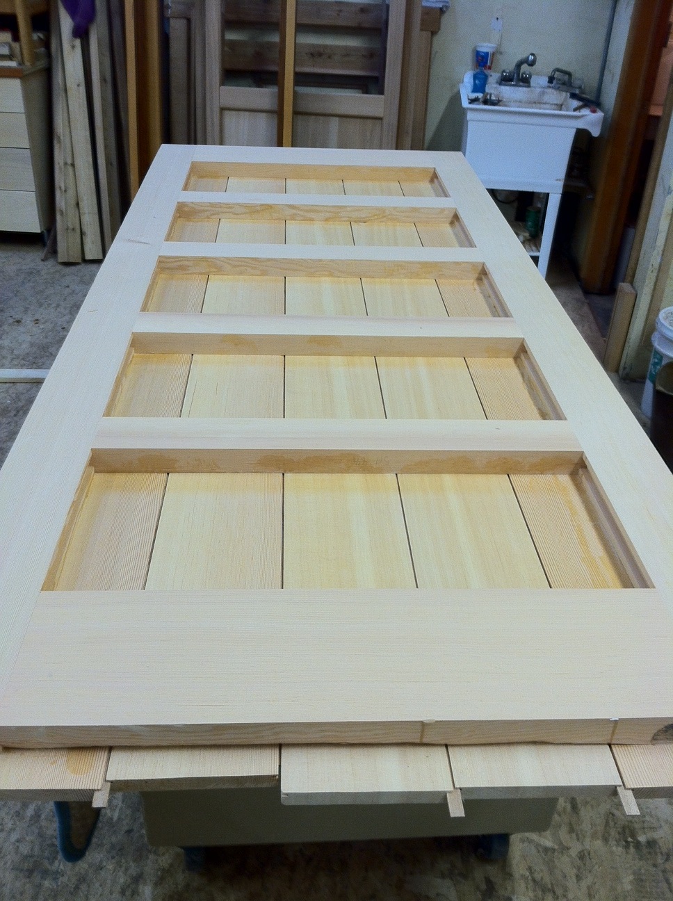

We build a lot of plank doors. They weather better than panel doors. Thicker is better. I do not like to make North American type non rebated doors thicker than 2 1/4" or so. Thicker than this the bevel edge gets large and not much purchase with the gasket. It is possible to make a flush rebated door using butt hinges and conventional mortise locks.
Here is a 78mm thick Fir (3 1/16") Euro door ready for foam insulation. And a conventional US door in rustic walnut at 2 1/4" thick.

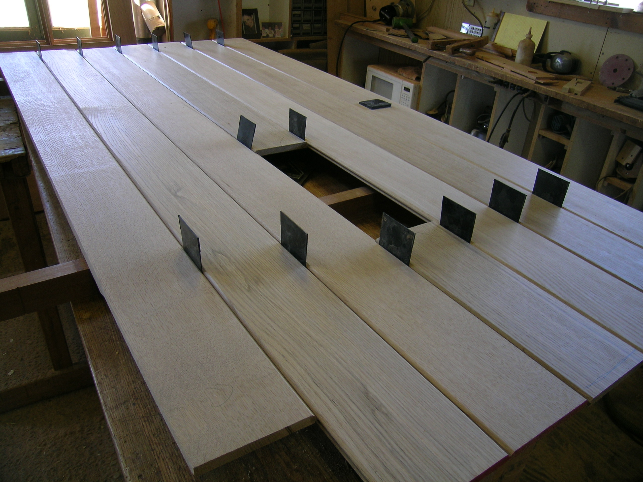

A plank door can swell and cause real problems. The first plank door I made did this, and sent me back to the drawing board looking for reasons why it failed.
Most often the desire is to pull up the boards tightly across their width, to make everything nice and tight. Then when the boards swell, they expand and will grow, bending the rails, or blowing the glue joints. My failed door bowed over 1-1/2" across its width!
If you look at the photo of Joe Calhoun's door in process, you can notice a clean, consistent gap between the planks, and a loose spline inserted along the length of the planks. The spline also has room in its plows for the expansion. This gap is where the boards go when they expand, and the stout mortise and tenon frame holds it all together and prevents racking.

the trick with these doors is to glue the planks to the frame but not to each other so you do not have the expansion of a whole glued together panel. We normally run T&G on the moulder for this and I do not
remember why this one was splined. In this case the spline was glued to only one board but not the mating board.

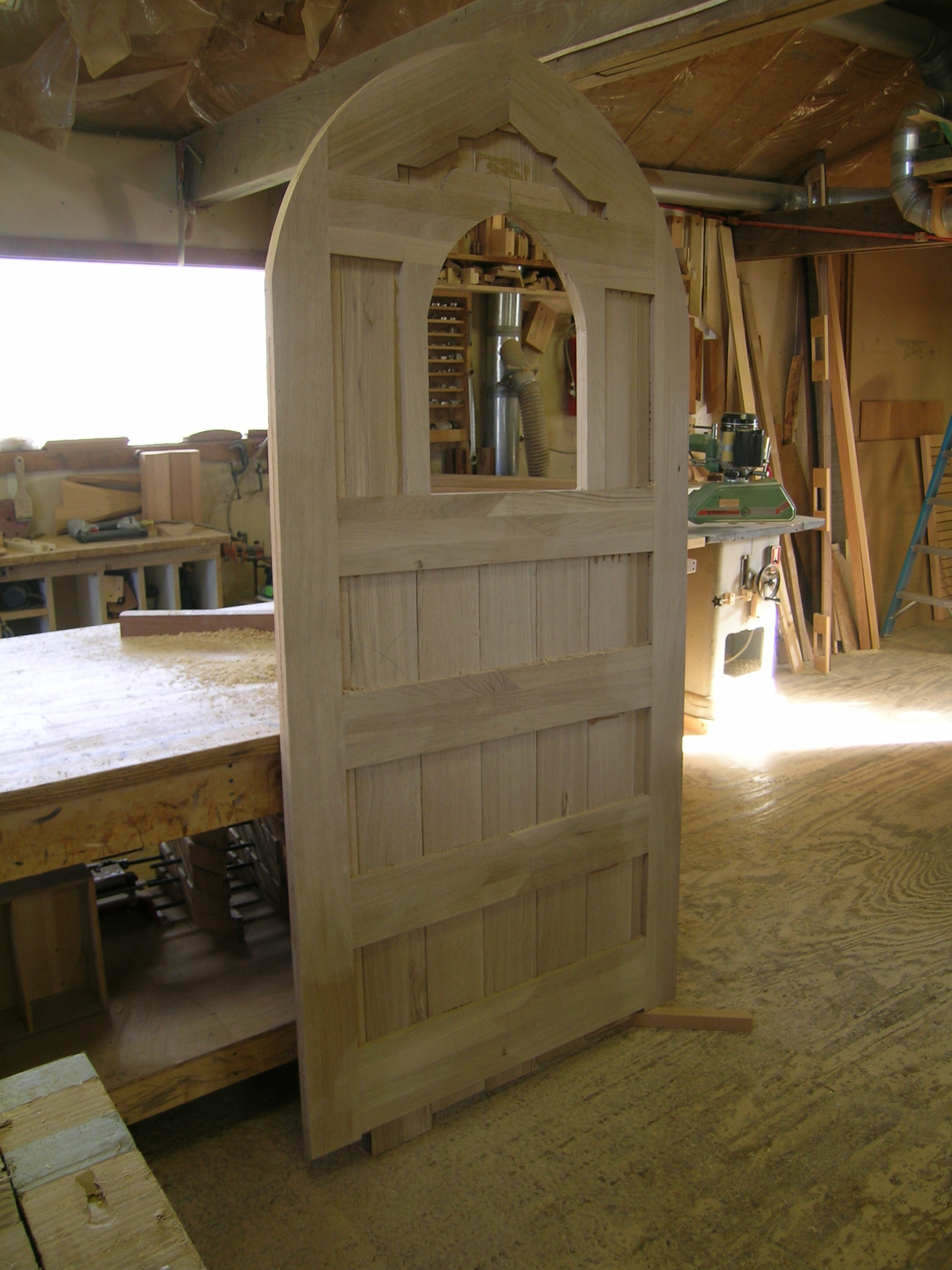

Here are some photos of a plank door that show the plank spacing held with spacers, the foam laid in the ladder core, and general construction. This door is 2-1/4" thick.
