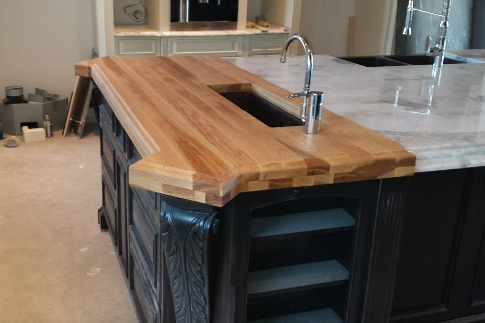

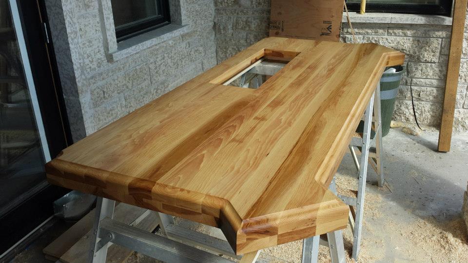

here is a pic. we did this in hickory so there is a lot of colour variation but the client loved it.

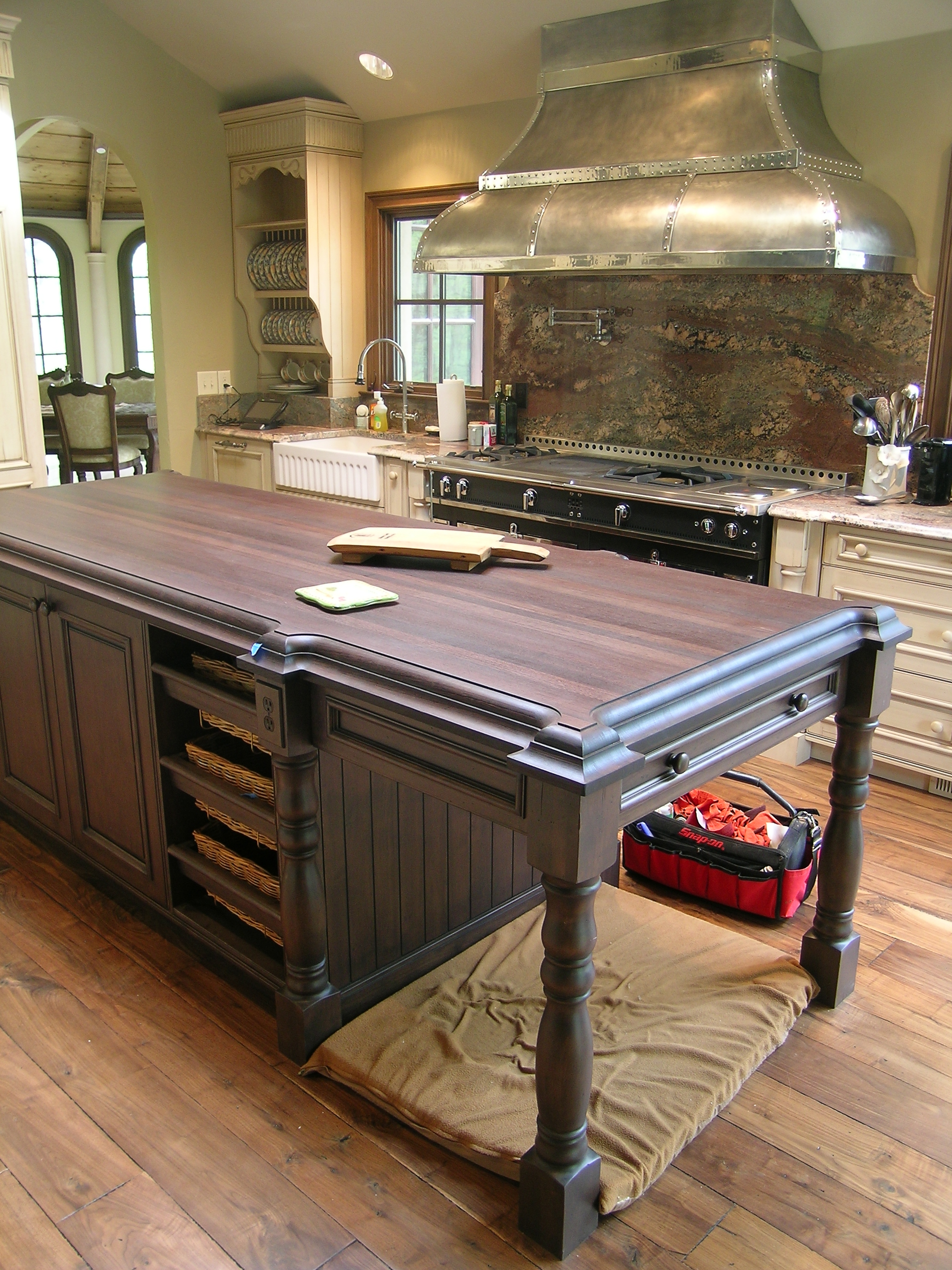

Here is an image of a solid 4" thick Wenge top that is over 10' long. 8/4 flat sawn Wenge was ripped and turned for the thickness - same throughout.
We glued it with epoxy (wetting out both pieces), and had a few small cracks to touch up after finish, before delivery. Easy to mix up epoxy and some sander dust and fill, then scrape flat when cured. Put some good masking tape either side of the crack for easy clean-up and to avoid filling the grain with glue.
We also do tops as torsion boxes on stable cores and so we can do big, wide miters, curves, etc. Balanced, with 1/8" to 3/16" on both sides. Never a problem, except for those same damn hairline cracks. You just have to find and repair before delivery.

The edge is done with a router and the largest round over and cove bits available. The cove bit requires a long shank. The inside corners are carved.
Yes, the thing required four people to move it. And yes. Wenge will give you splinters just by looking at it. Once it is sanded and finished, it looks great.

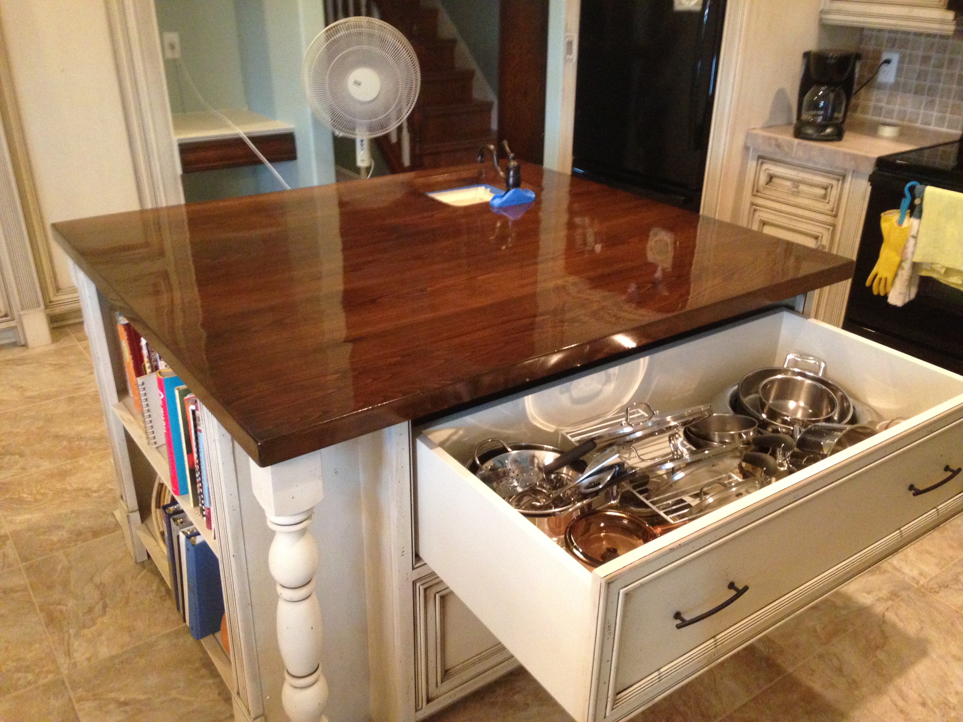

here's a vanity top with undermount Kohler Verticyl lavs, species is (face grain) German Beech 1-7/8" finished thickness, finish is dye stain/wiping stain/glaze/Conversion Varnish (cat'd sesler between steps).

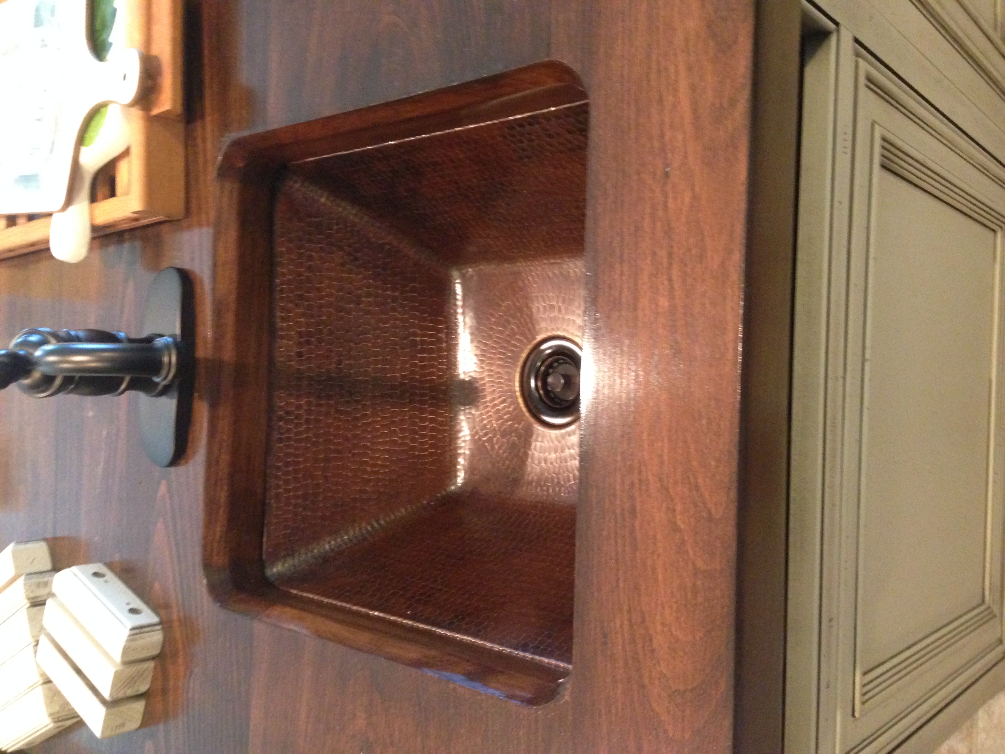

island top 54" width 8/4 German Beech , undermount hammered copper prep sink; /dye stain/light distress + Waterlox Original

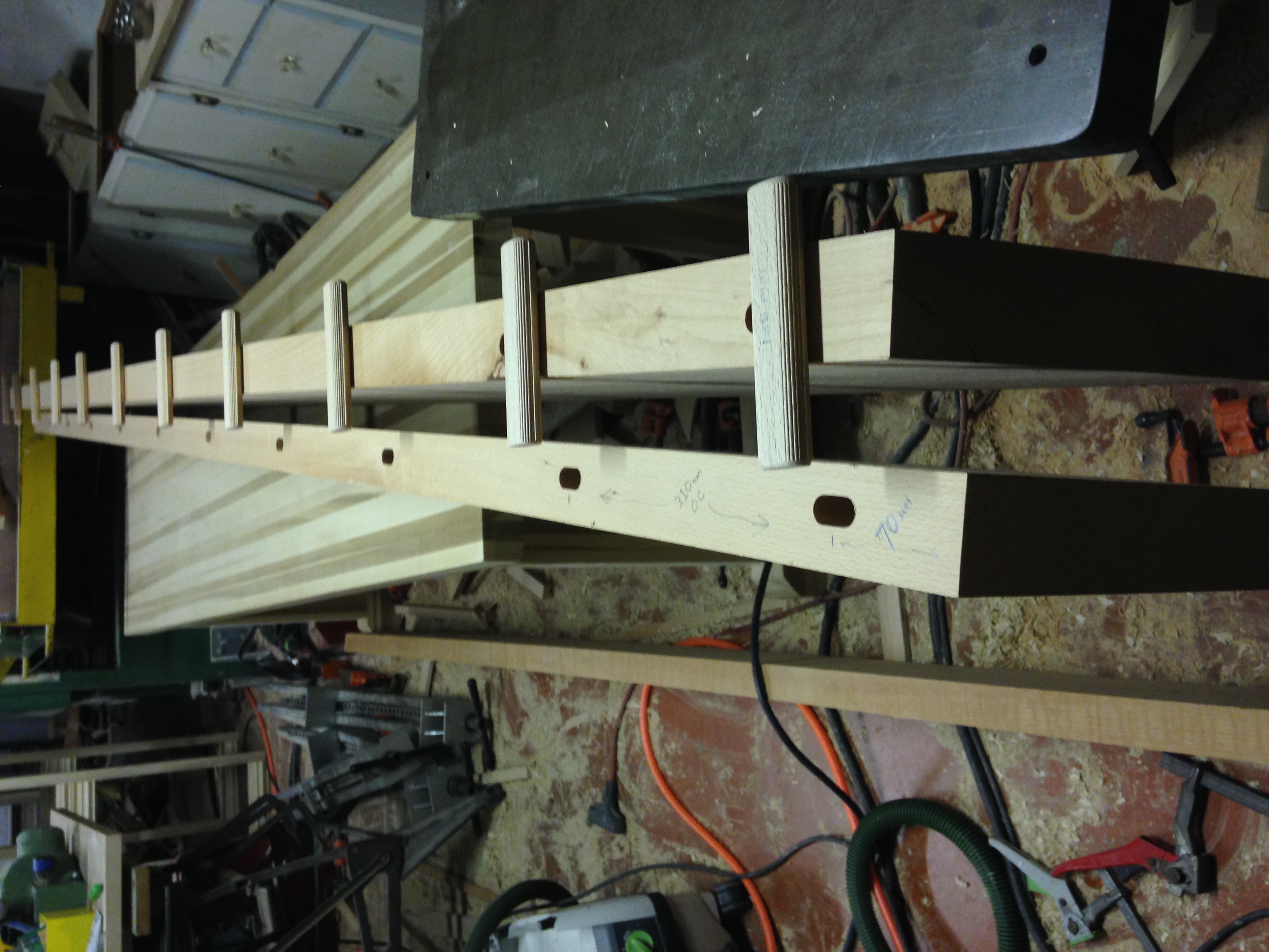

IIRC, there are about 70 14mmx140mm Dominos.(PUR "brown glue" throughout )
assembled in sections in Quick clamp rack, then final assessment in an old, manual 12ft Black Bros case clamp.

previously described Vanity top, + copper sink in 54"w island top
