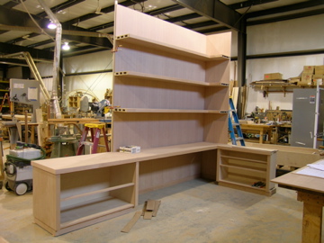

MDF has a hard time supporting itself over a span, no matter how thick. Try running the numbers on the Sagulator.
We often make torsion boxes with 1/4" MDF faces, whatever thickness we want, that are far stronger than anything solid.
The shelves in the photo supported a 250 lbs office employee, with a 10' span, with less than 1/16" sag, before they were supported by the back.

David R Sochar, I would love to the see design for the torsion boxes you've made they look great. If you don't mind sharing...Chris
