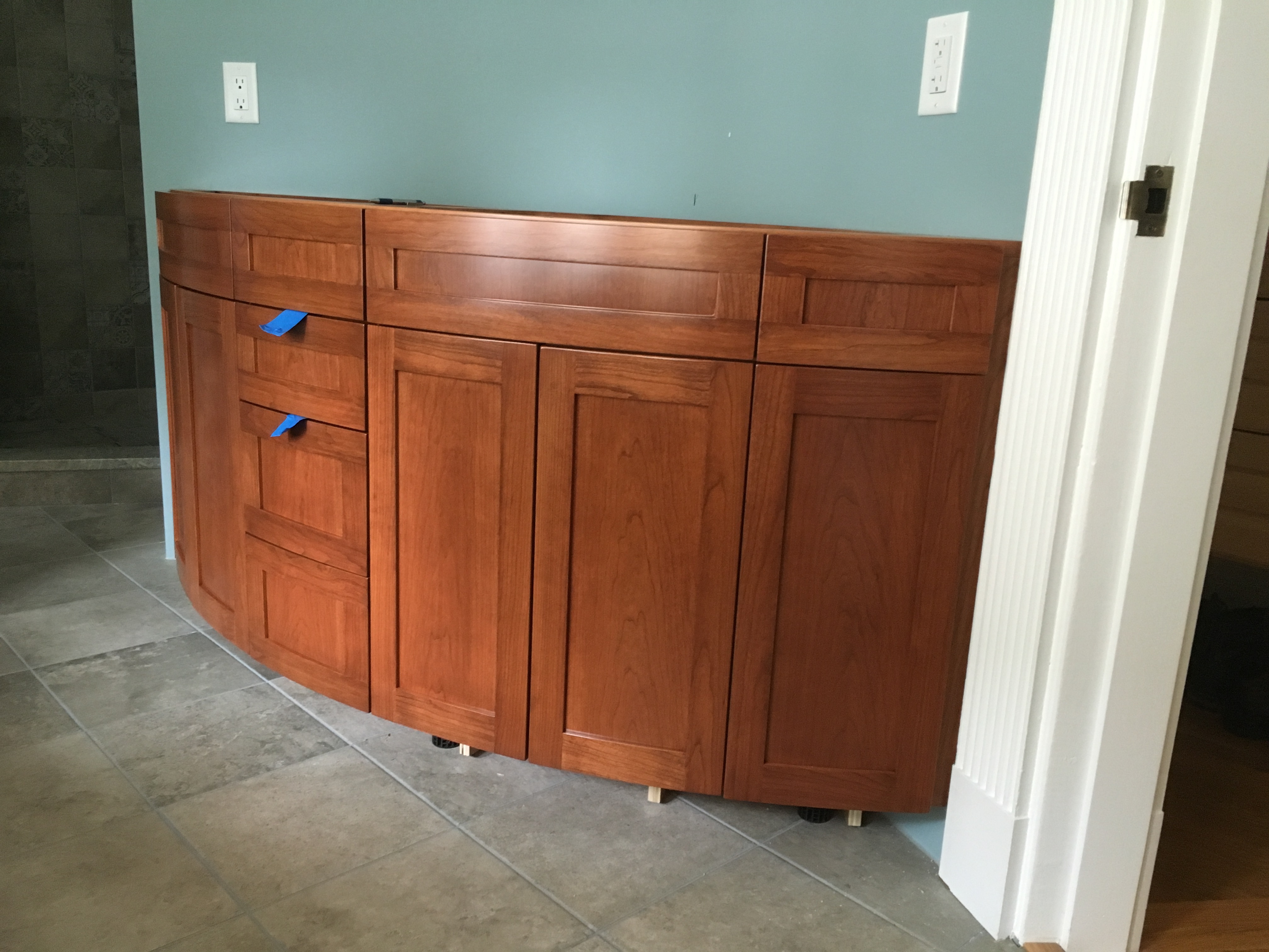

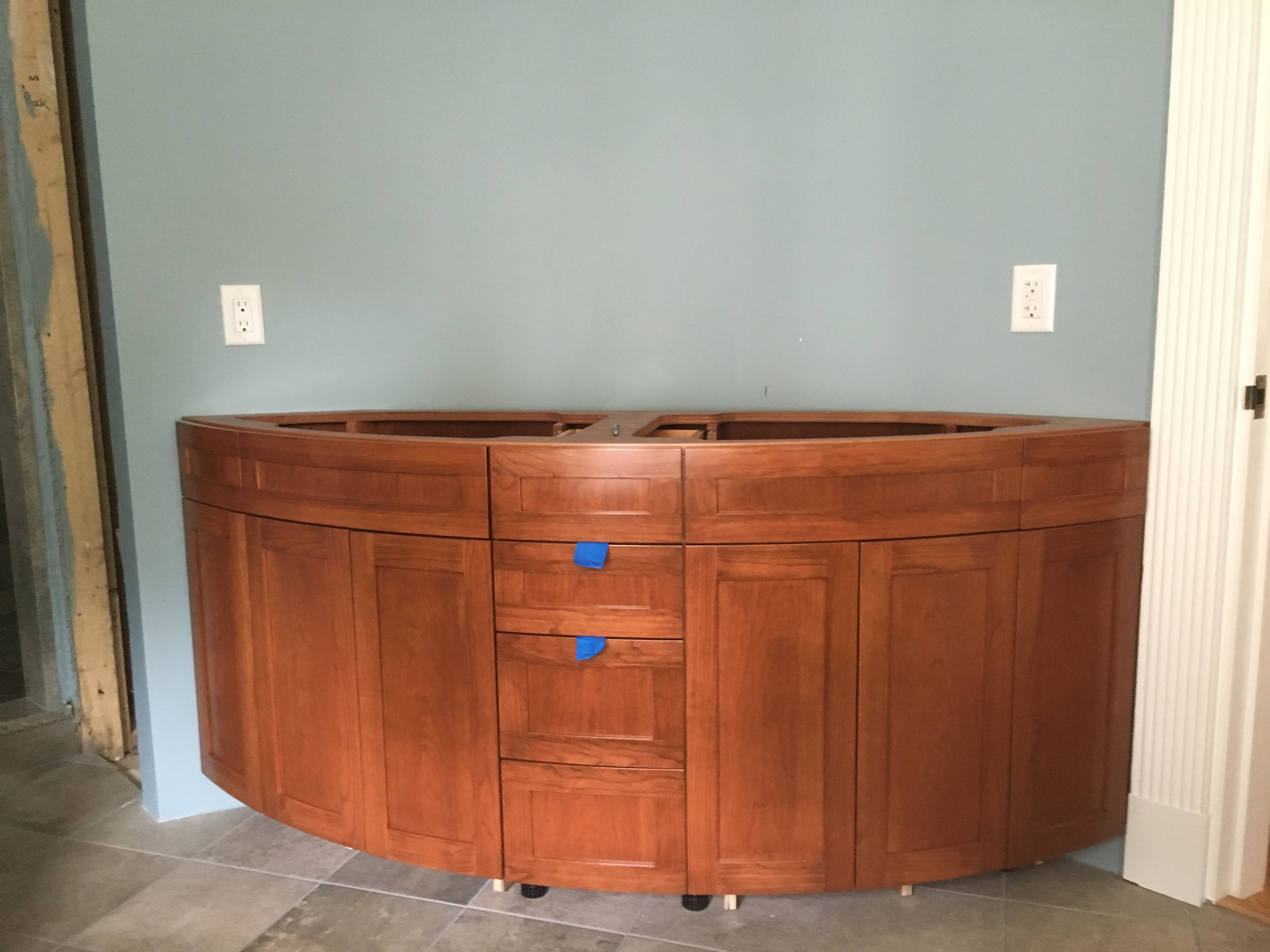

Ok so having a weird problem with some curved panels I'm making up. These are 3/8" panels composed of 3 pieces of 1/8" cherry roughly 10"w x 20"l. The 1/8" skins were freshly resawn and fairly flat. Glued with TB2, taped up in sets of 3 and popped in the vac bag for about 2 hours. When they come out the glue is set fine, but as soon as the tape is taken off they warp!
I've double checked and the form is good, no warp at all. And as I said the individual skins were fairly flat going in, just not coming out. Also they don't all warp, and the ones that do warp do so to different degrees.
Anyone have this problem before? I'm going to have to make up another batch of these as many are too far out to use for door panels, and would love to figure this out before wasting more cherry and time.

The good news is a couple of the 1st batch of panels I glued up that I though weren't going to cut it "relaxed" enough over several days they were usable. Basically if I put them on a flat surface and pushed 3 corners down the 4th was up by about 1/8". Once the doors were glued up they held flat.
So I was able to get the project out the door, but not able to resolve the problem. I still have about 4 extra sets of skins though so will make a couple more attempts.
